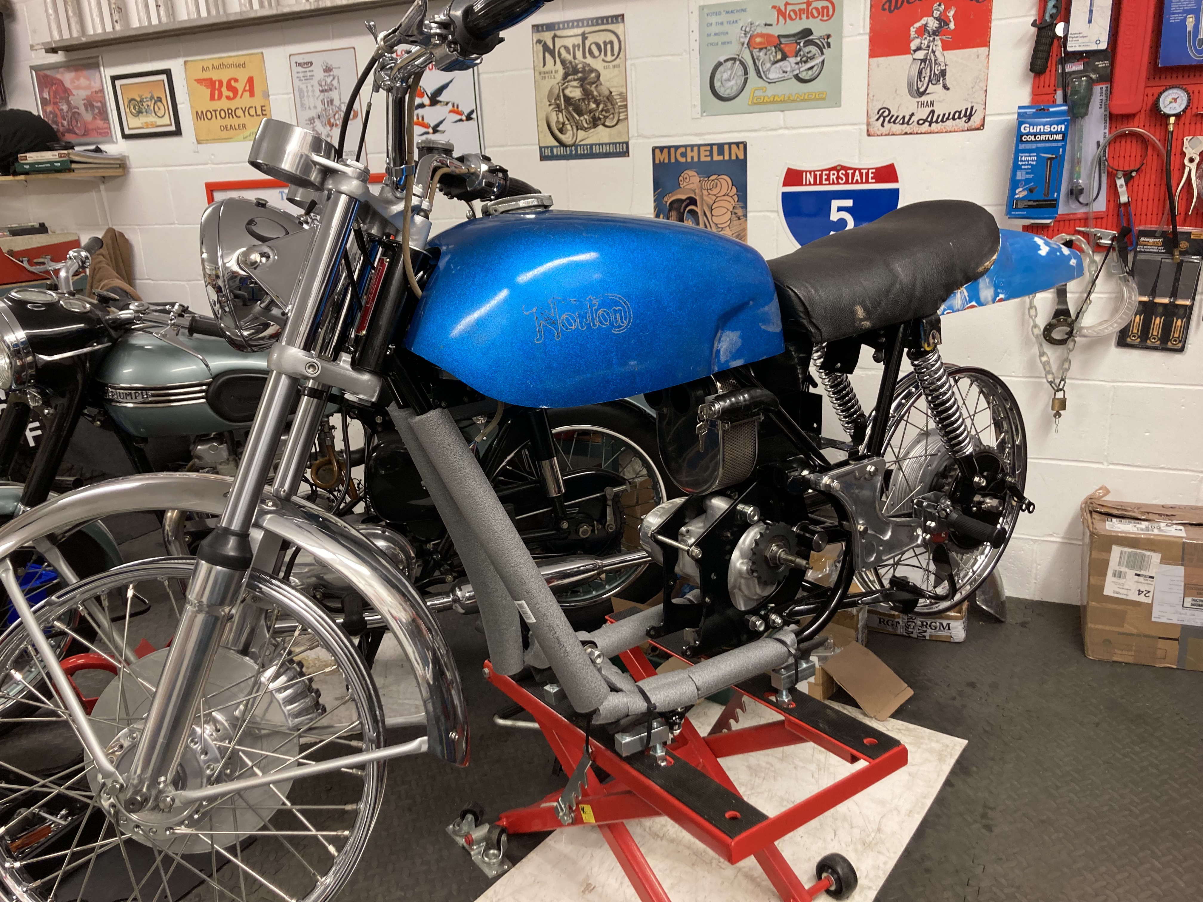

I have found the Sealey MC4500 to be very useful. Lifts the bike by 0.5m, locks off and can be wheeled about if required. When not in use it can be stored upright in the flat position so it doesn’t take too much space.  Quite stable as long as you strap or cable tie the frame to the lift

... the one Steve mentions and have found it invaluable especially when I had very limited space. It's true they neeed careful loading not to tip but in 10 years or so I've never actually had it fall over. I take David's points on the full size lift and they are one reason I went for the Sealey type. I find the height fine and have a folding chair to sit on beside it while I work on the lower parts while the tank etc are at the right height when standing.

I'm leaning towards Steve's suggestion of the Sealey MC4500, there looks to be a decent offer on these at the moment which also helps the decision
