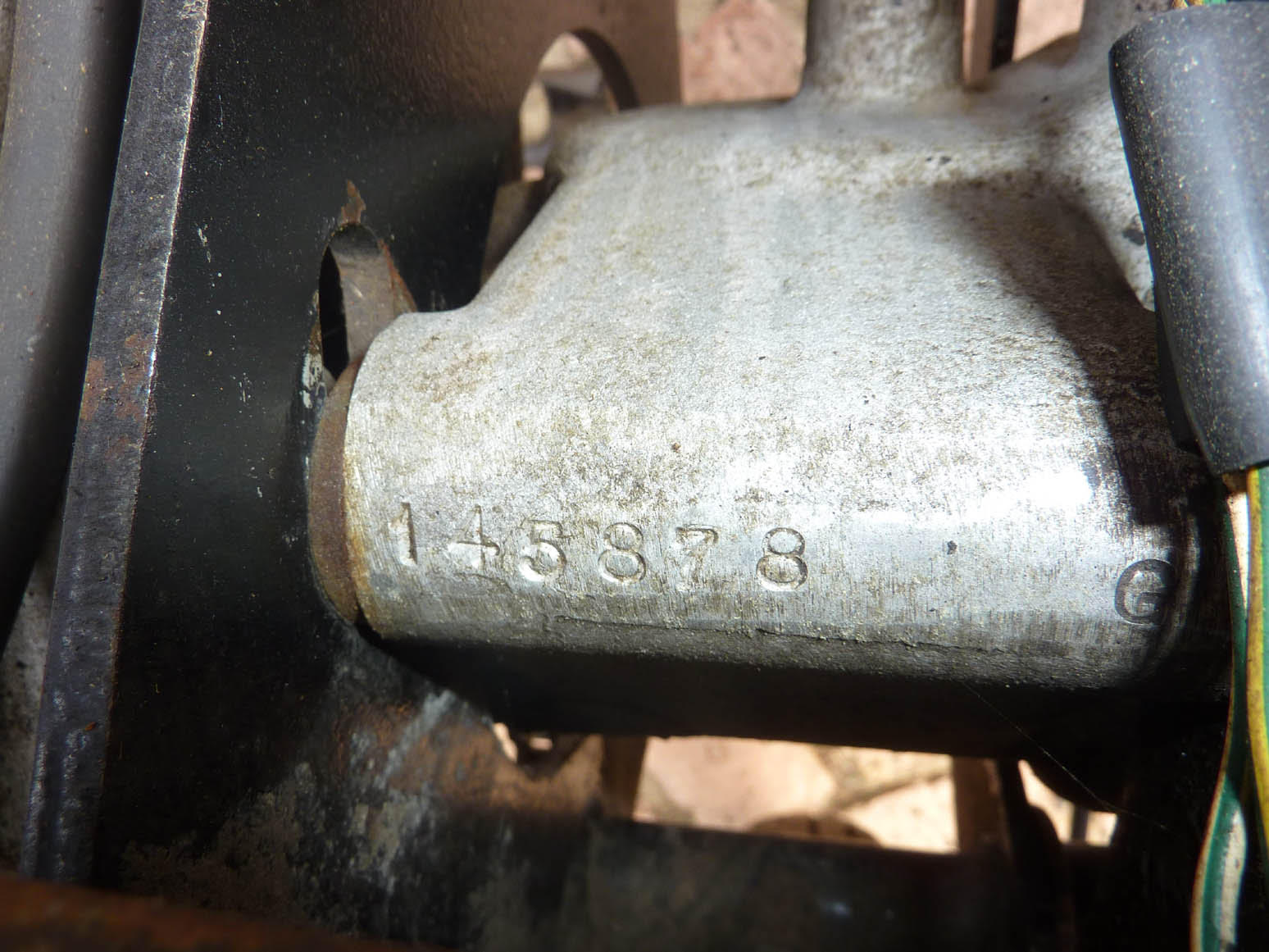

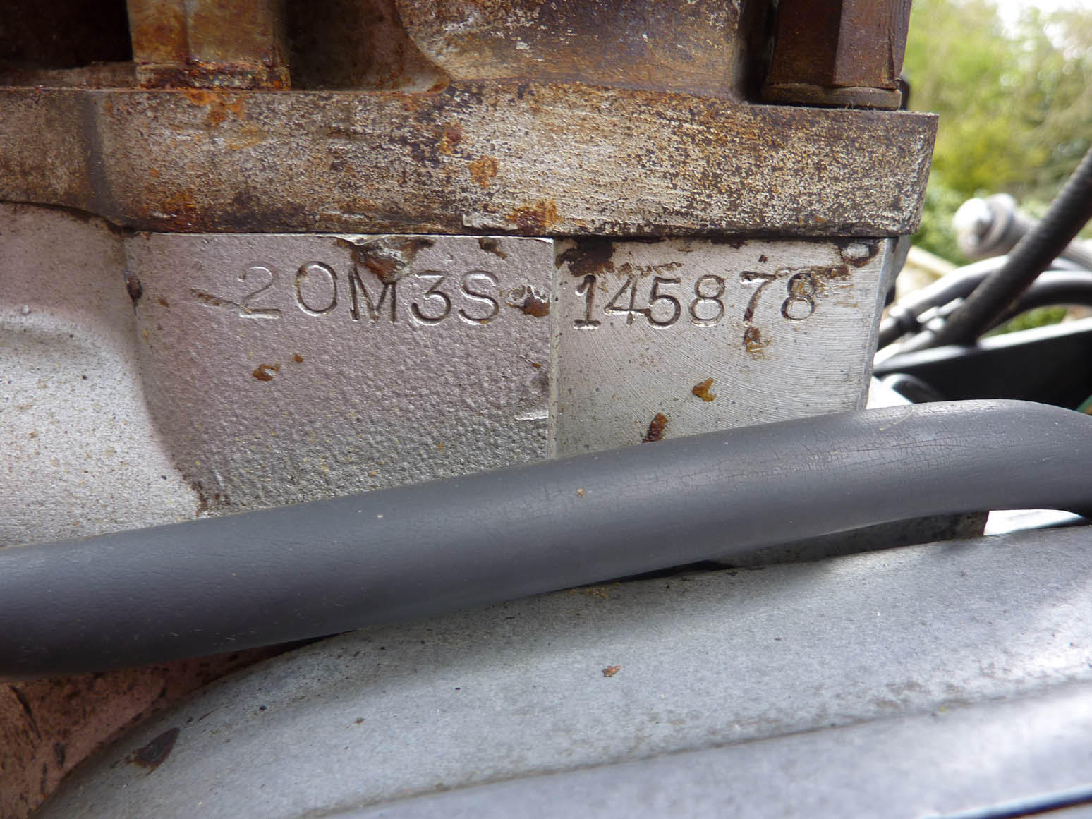

It also looks as if everything matches, as the engine says 20M3S and the engine number and the frame number both match

Thanks Guys, I assumed it was an S type as the engine is stamped 20M3S. However I am a total newbie to Nortons, so obviously the S suffix does not necessarily mean it is an S type?

My understanding is that the…
My understanding is that the "S" in the 20M3S engine number prefix indicates a 750 with points on the end of the camshaft + some other minor changes to the engine.

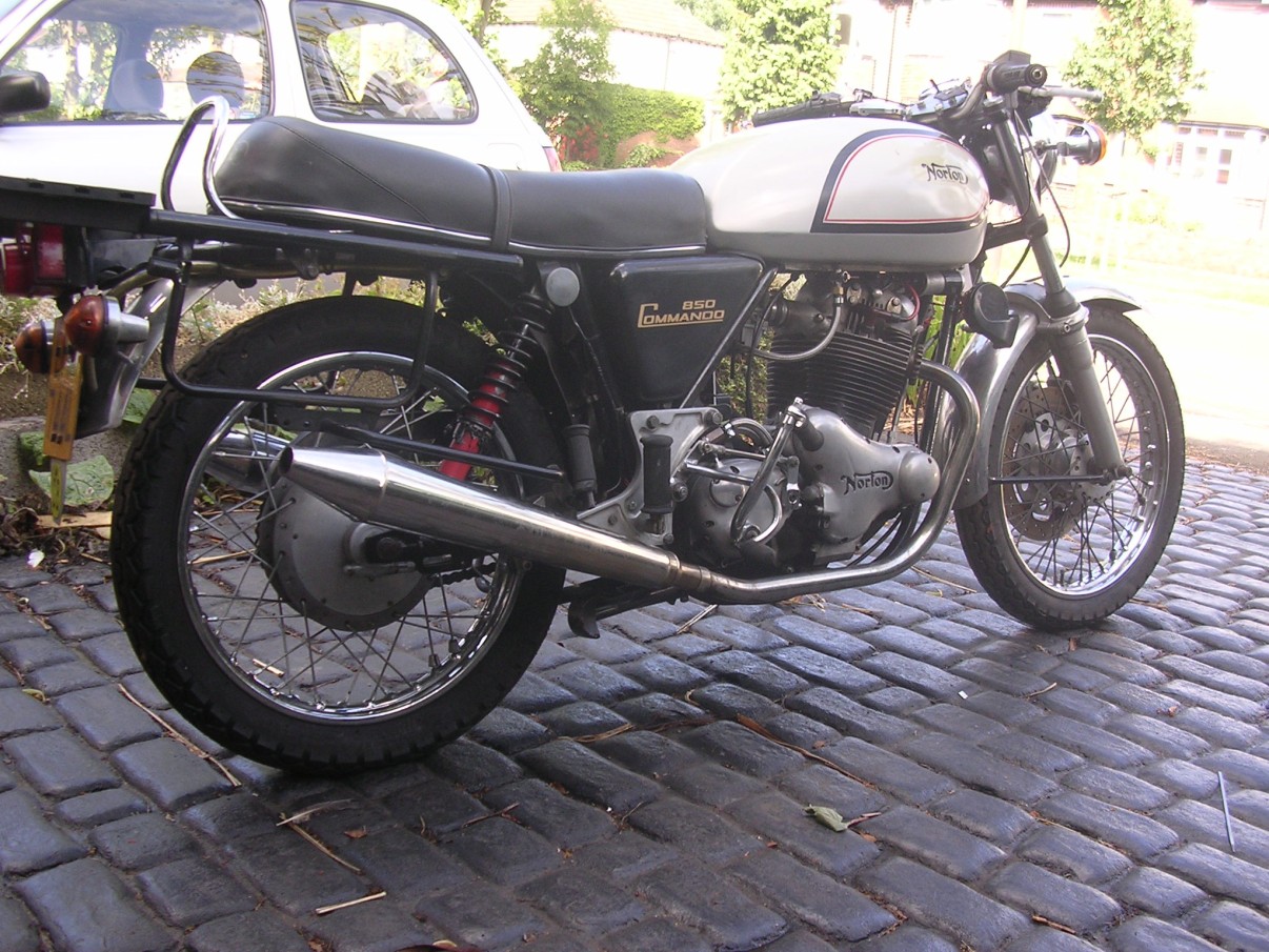

Interesting that your front mudguard looks different from the left and right :)

Thanks for the info on the 'S' I am thinking now to leave it as a Roadster although the engine/frame number appear to be in a series allocated to an SS, so all a bit of a mixture. Will probably have to change the tank anyway as it has the original fibre glass one fitted and the bike came to me with an Interstate steel tank in good condition
The reason for the different mudguard is due to the fact that the PO has started to recommission the bike and had changed the mudguard before he lost interest. The bike currently has the longer mudguard. Incidentally I am aware of the front stanchions needing new seals etc.
