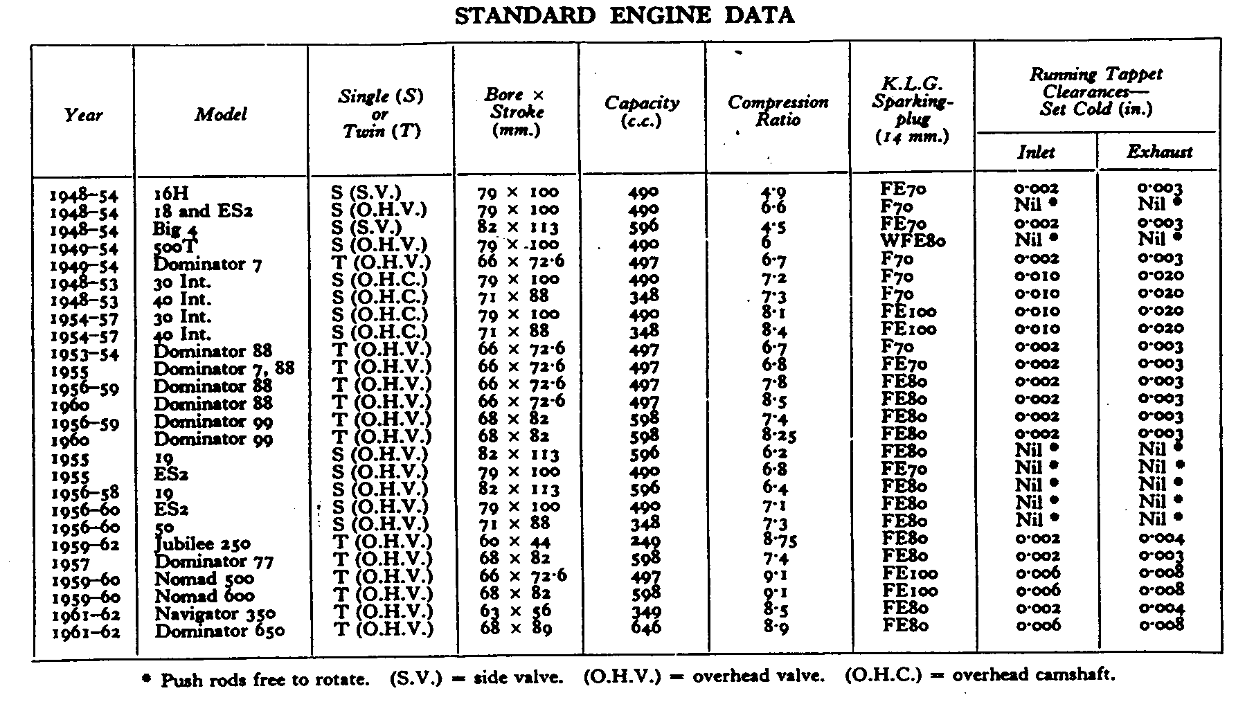

Atmospheric pressure is 14.7psi; if you have a compression pressure of 80psi then divide that by atmospheric and it will give you the ratio. [5.44:1]   This is quite loose but gives you a ballpark figure which I would say is not far off for a new built engine of your type.  I think 7.3:1 is stated for M50's depending on year.
