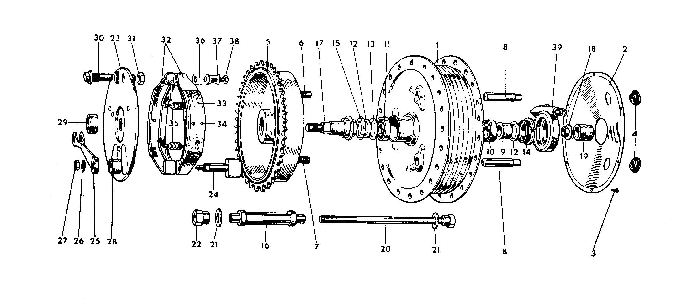

Somewhere within the Forum historic files is a posting about the Dominator Rear Wheel  Bearing Spacer Tube that sits between the bearings. The following was part of the original posting and comes from the long lost Dominator Service Notes.
The longest end of the spacer tube goes through the RHS bearing.  Haynes Ch 7...Sec 7.7
The significance of this being that the bearing spacer only fits one way round and if this is incorrect it will push one of the bearings out of position and causes the axle and associated parts to be around 5mm over to one side.
Also worth checking out is the spacer on the Brake Plate. The attached diagram shows the two spacers as 19 and 29. The Brake Plate spacer is rough only half as thick.
