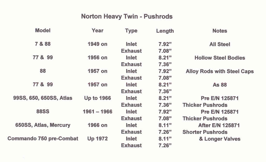

I am midway into rebuilding the top end of my 1956 Dominator 99 and on checking the push rods I have found that one of the exhaust push rods is badly bent and the other three are scored. They are tubular aluminium with steel ends.
Can anybody please advise me what the correct overall length of the exhaust and inlet push rods are for the 99 and a recommended suppler of new ones.

Further to my previous comment and after further deliberations , considering that I am going to fit a compression plate to the underside of the barrel and that a p/o had skimmed the top of the barrel and in addition the cylinder head has had a light skim , I have convinced myself that I need to determine the correct pushrod lengths before contacting possible suppliers .  What is the preferred way to determine the correct push rod lengths ?
George
If it were me, I'd straighten the bent rod and assemble with what I had, and check the valve contact geometry to work out if they need to be longer or shorter.  It won't take all that long, as you only need to snug up the four main cylinder head bolts, and you won't be fitting the carb and pipes.  Also you might find out if the scoring was the result of them being too fat for the pushrod holes in your engine, or the results of them previously becoming dislodged from their cups during an assembly error.

As an addition I might make an adjustable pushrod which perhaps will be easier to finalise the lengths.
George
As already mentioned , the barrel shaped p/rods appeared in 1961 and it's likely that if you were to try and fit them they would foul up in the pushrod tunnel, but obviously you would check before final assembly.
Hi George.......The fatter pushrods arrived with the 650, 500SS and 600SS engines. Roughly  late 1960 onwards. The barrels had slightly enlarged tunnels to cope with the increased rod widths.  So any pre-1960 barrels will struggle to cope with the fatter rods unless some machining has been done.
When engine producing moved to Plumstead, some of the machining of both barrels and cylinder heads was so was poor that, even in the later engines, the pushrods rubbed on the tunnel mouths, or against the gasket edge or against each other.
You must be very careful when changing the pushrod lengths in order to avoid the rockers ending up thumping the roof of the head or running out of adjustment.
