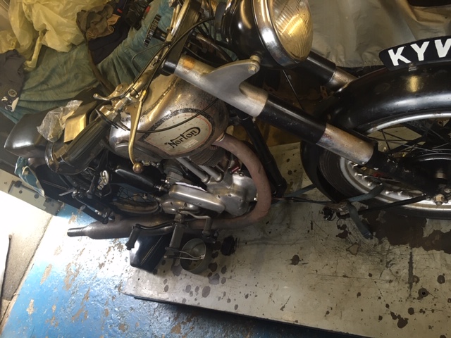

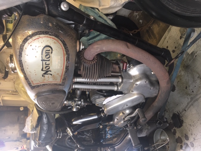

Pictures
Will give a clue as to the state of the machine. The 1950 ES2 I am helping with at present looks rough but it has been well cared for mechanically and runs like a Swiss watch. That’s in Castle Greasley near Burton on Trent so not far away. Maybe next weekend would be good to visit?

That looks...
.. pretty standard and complete. No doubt there will be horrors encountered somewhere! I'm a bit far from you in Redditch but see Jonathan is closer.
Best of luck.
That's the one i'm working on Ian...
Its in pretty nice fettle now runs and ticks over like a static steam engine.... its very complete and original it a little tatty in places. The wiring was a bit amiss and no regulator in circuit. Pretty much sorted now. The owner wants to do a long run on it to the south coast... Be warned, Redditch may well be on route ....
