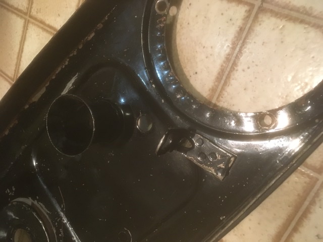

My basket case Dommie 99 came with a primary chaincase that looks like the primary chain had made an almost completely successful attempt to escape out the back of it. So I bought another one off eBay but the alternator cable exit holes are in slightly different places. My original chaincase has the cable exit near the top of the rear cover. The one I’ve just bought has the cable exit hole about halfway down the rear cover (see photo below). There is also an adjacent small bracket with a hole in it that looks like it’s for routing the cable through. The rest of the cover looks identical to the original one. Have I bought something that isn’t suitable for a slimline Dommie?

Thanks Robert. In my chaincase the bracket I mentioned has a large (5/8 inch) hole in it which looks like it’s meant to hold the alternator cable away from the chain run - well, that’s what I’m hoping!

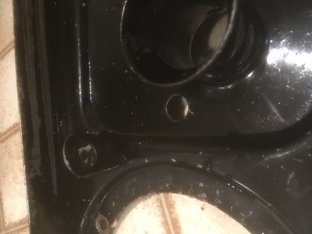

This morning I drilled out the welds in the two sealing discs in the rear cover so I could change the felt seal between them but after a lot of drilling, I’ve discovered that there isn’ any kind of seal between the discs. I assumed (wrongly) that there was a felt seal between them - another reason why I dislike the parts catalogues so much - no exploded diagram of many items, e.g. the chaincase and its associated components. I read somewhere on the internet that there was a felt seal between the discs so I thought I should change it - another reason to not believe everything one reads on the internet, even if it sounds believable.

I am just finishing a complete rebuild of my 1957 99 and drilled out my rivets too, just so that the rear case could be painted properly. I fitted the felt seals, as on the footrest tunnel, on rebuilding as an extra precaution against leaking oil.

Hopefully Phil will turn up with something on the chaincase hole. I thought they made a change from the top edge (where mine is, and as Robert says his is) to a lower location to reduce the chance of the chain cutting the cable. In which case, both are 'correct'.

Thanks Dick and David. I spent an hour or so flattening the two disks as they were a bit buckled in places. Now that they are flat again (with the raised ring near the centre) they fit very snugly against the inner chaincase so I’m not sure where a felt seal would go - I’ll have a better look when I get round to rebuilding it all.

On my slimline 99 with original cases the cable hole is about 3/8th dia and only just clears the top chain run (all from memory).
