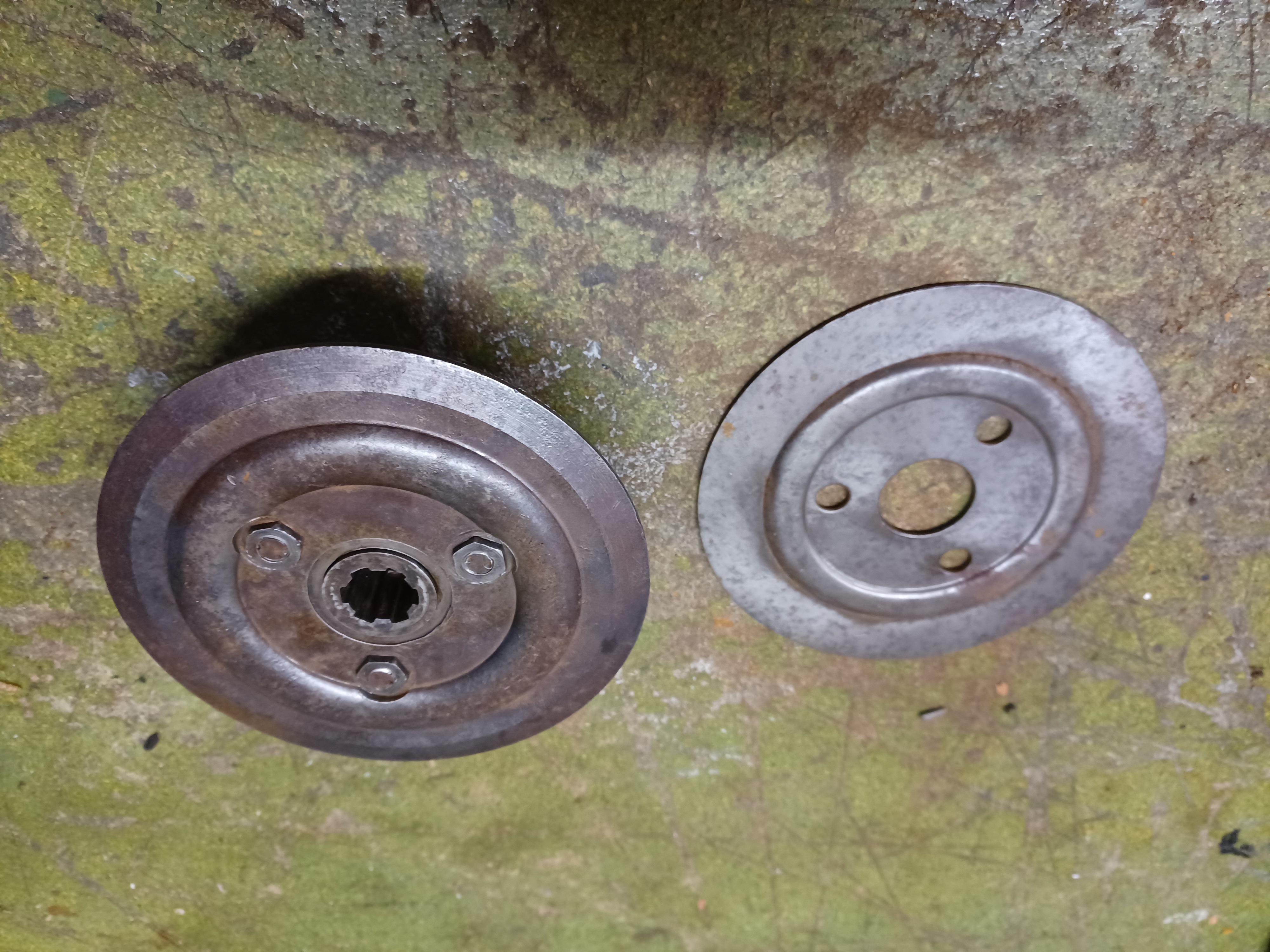

I'm sorting out a few bits to build a spare clutch for my 38 ES2.
Can anyone tell me which of the backplates is correct? The shallow one or the deeper one shown in the picture.
Thanks for the comments.  I had my suspicion that this was the correct one as clearance is very tight at the rear of the cas. Nice to have it confirmed.
