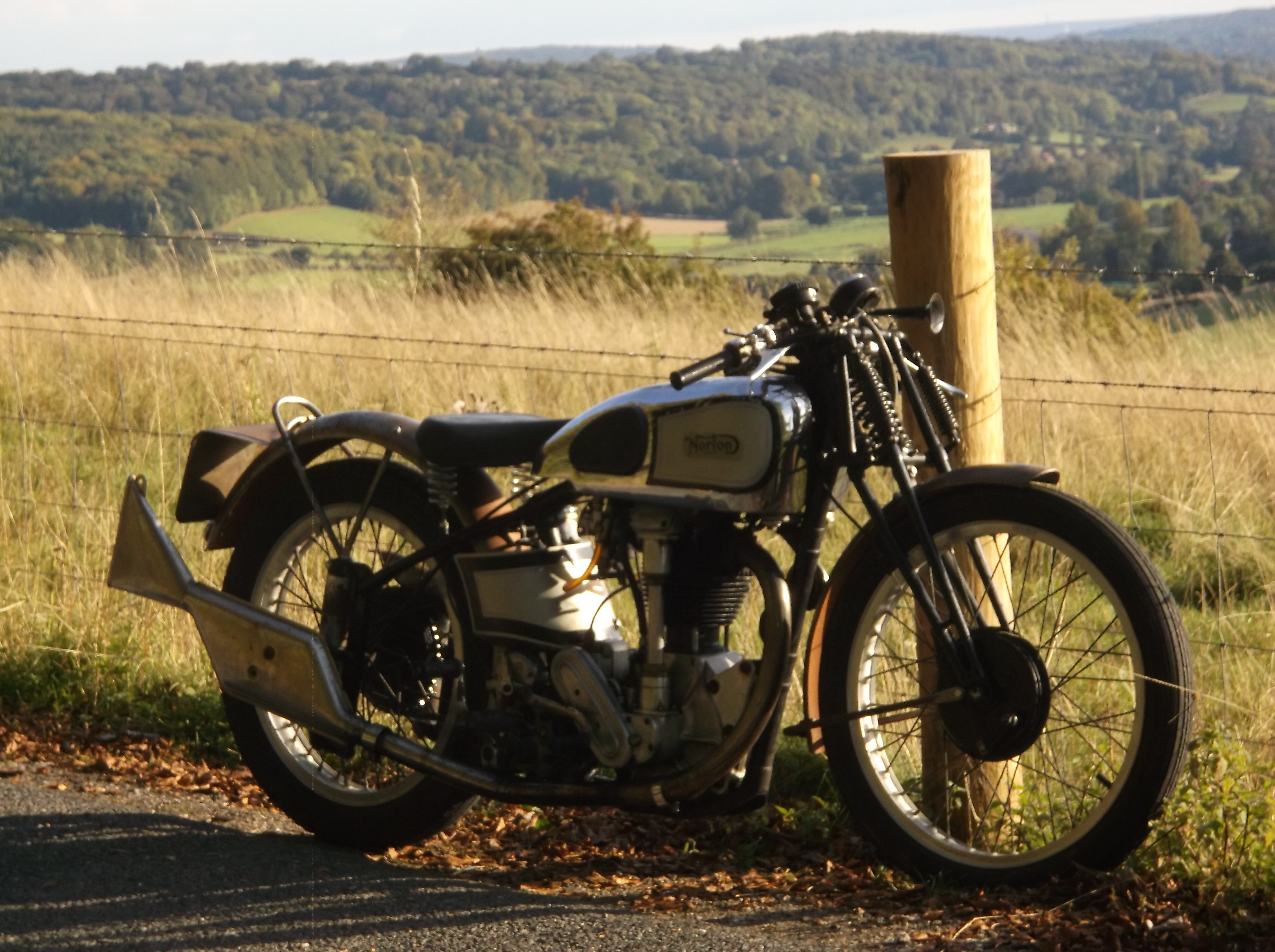

I recently followed an Inter…
I recently followed an Inter with the can and to me it sounded fabulous, and I saw the looks of interest from the public we passed. But I would not want to ride any distance at speed with one without ear protection. After many years in construction without protection Half my hearing has gone.Dad lost all hearing from his time with the RA. No hearing aid worked for him. 15 years in splendid isolation , Enjoy in moderation.

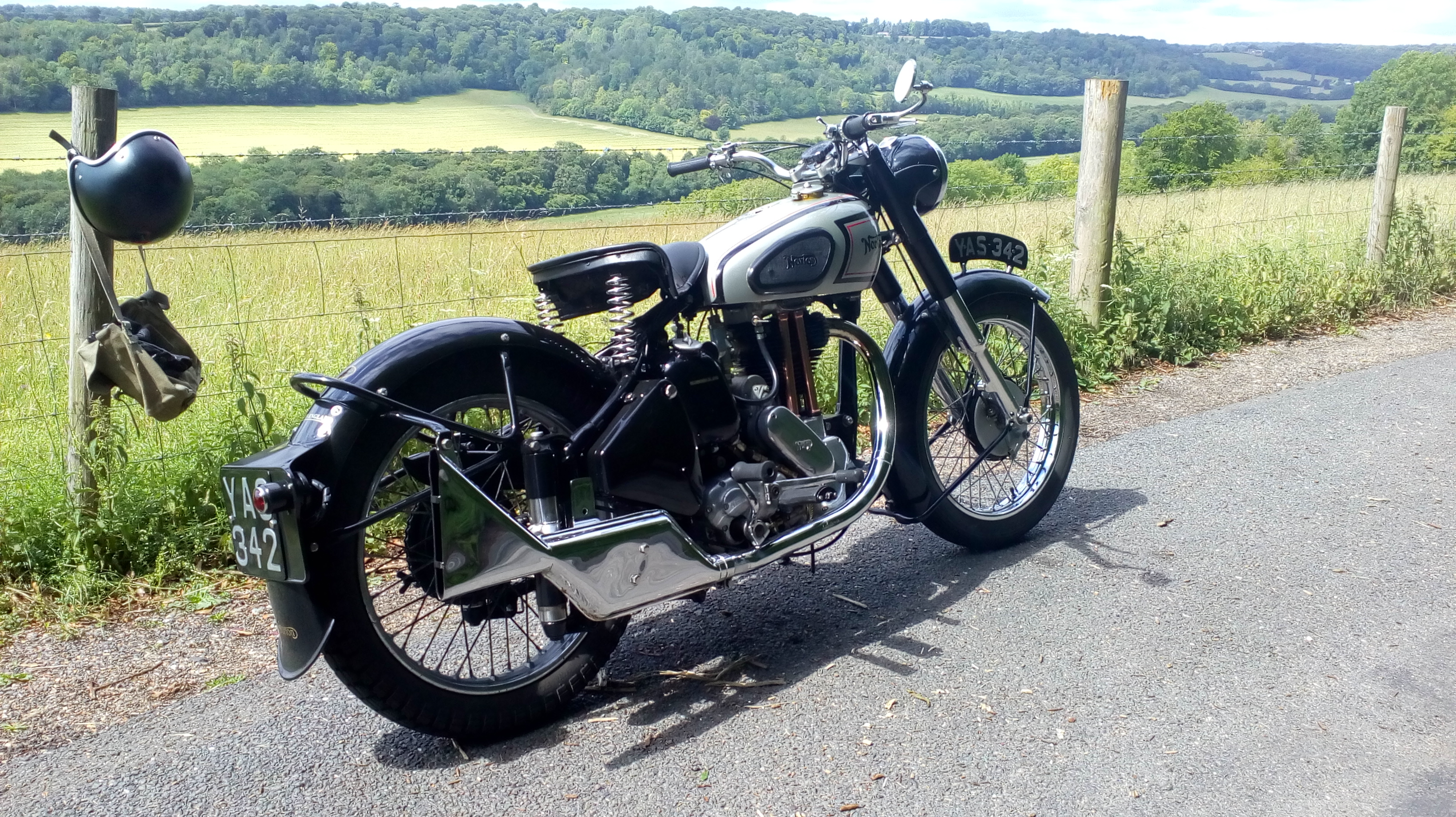

Brooklands can
I have one on my plunger ES2 (like yours, see pic attached) and as Robert says, it sounds fabulous. I find that my crash helmet provides adequate aural protection. Everything Mr Cornish (above) says is true although I haven't altered my carb from standard and the plug is a nice mid brown colour. Worth checking though. If you look at the pic attached, you can see a chrome bracket poking up above the can halfway along. The hole through it is for a pillion peg, just in case. I made the bracket from 1/4" plate and got it chromed, doubt I'll ever need it. Oh, and you'll need to get a stay made to support/attach the end of the can to the mudguard/.
Fab photo, lovely spot. but…
Fab photo, lovely spot. but where is the sound track!!.
Fishtails
Thanks for the fishtail thoughts folks......the Brooklands can looks super on your ES2 Adam and I think appearance outweighs any potential excess noise problems (sounds fabulous on an Inter says Robert, I bet it does!)
My ES2 is closer to oily rag than Adam's and is on a long (years long) programme of improvement and I think now the next job will be a Brooklands can.......
Cheers all, Ben Tomlin

It was taken...
.. as part of the Real Classic Norton Challenge a few years ago.....
