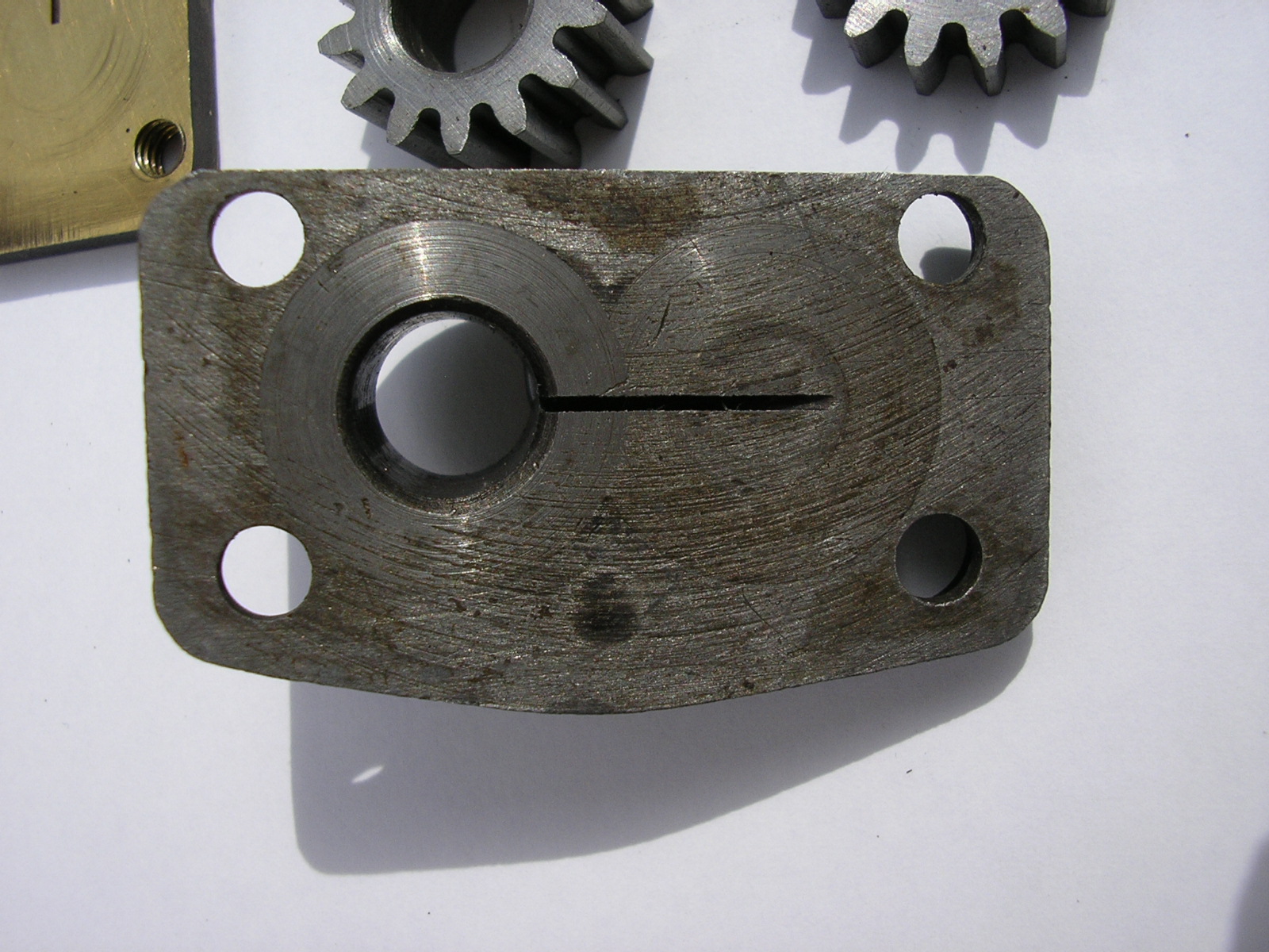

On many Commando oil pumps the face machining is extremely poor and must be one of Dave's four sources of leaks.There is no way this kind of finnish is going keep in hot oil. Example in attached photo.
Hi Philip Yes…
Hi Philip
Yes that is what mine looked like until i addressed it.
