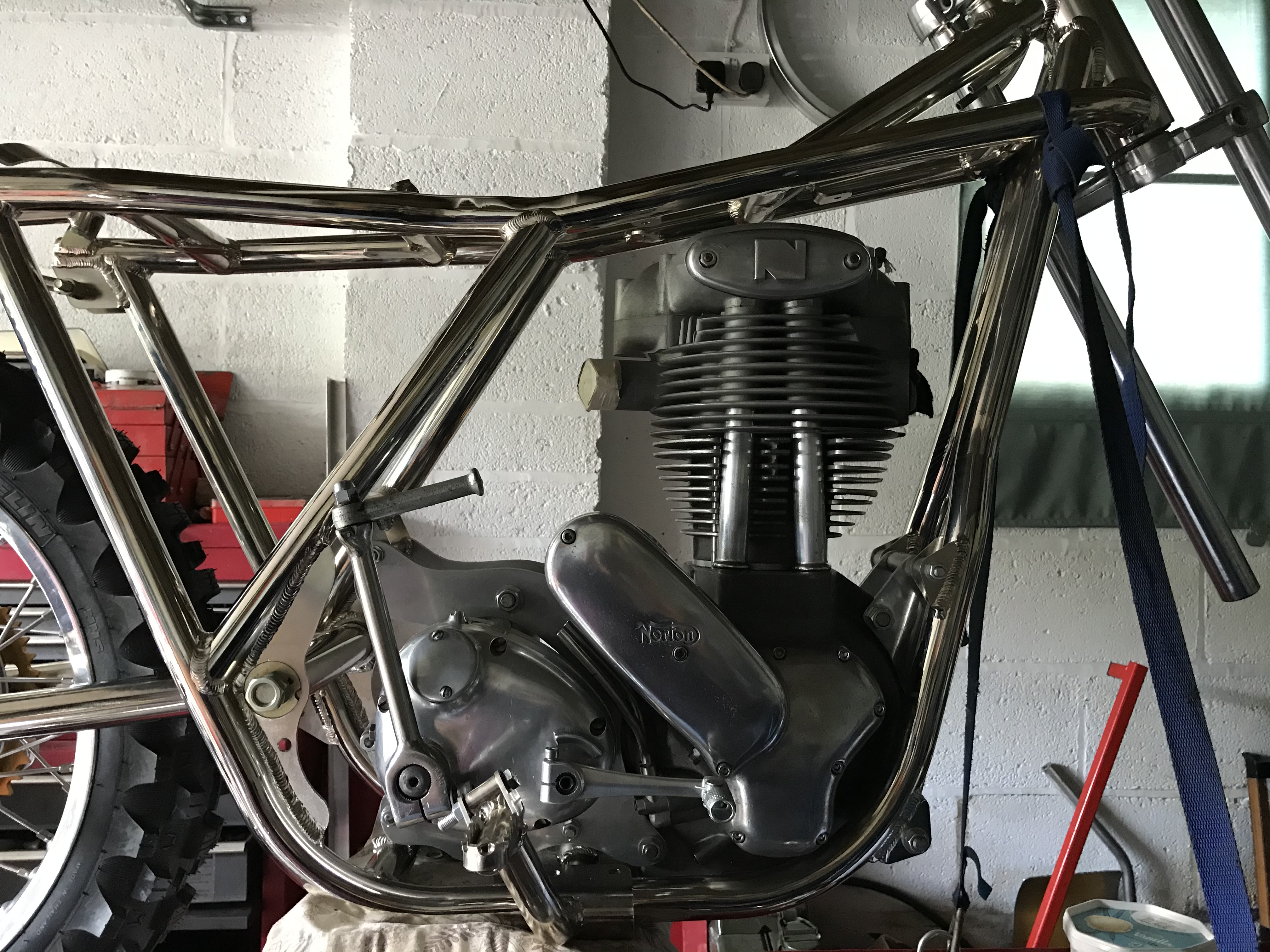

I am building a special which is oil in frame, this is really hard to clean out effectively and am considering using a large diesel filter on the feed to the oil pump, I don’t want to damage my newly rebuilt and tuned engine, has this been done before or is there a risk that it might reduce flow to the pump? As we all know a filter on the return side is more common but that filters out the crude after it’s been through the engine.

Thanks for your help, the frame is new, picture below, I’ve put over a gallon of petrol through it and am still getting bits of flux residue. The trouble is you can’t get a good flow through all the tubes. Plenty of people have used these frames without problem so maybe I’m over thinking it! It was always getting a Morgo filter on the return (smaller and neater than the RGM version). I still haven’t ruled out a separate oil tank as another solution. but I’ll rule out the feed side filter!
