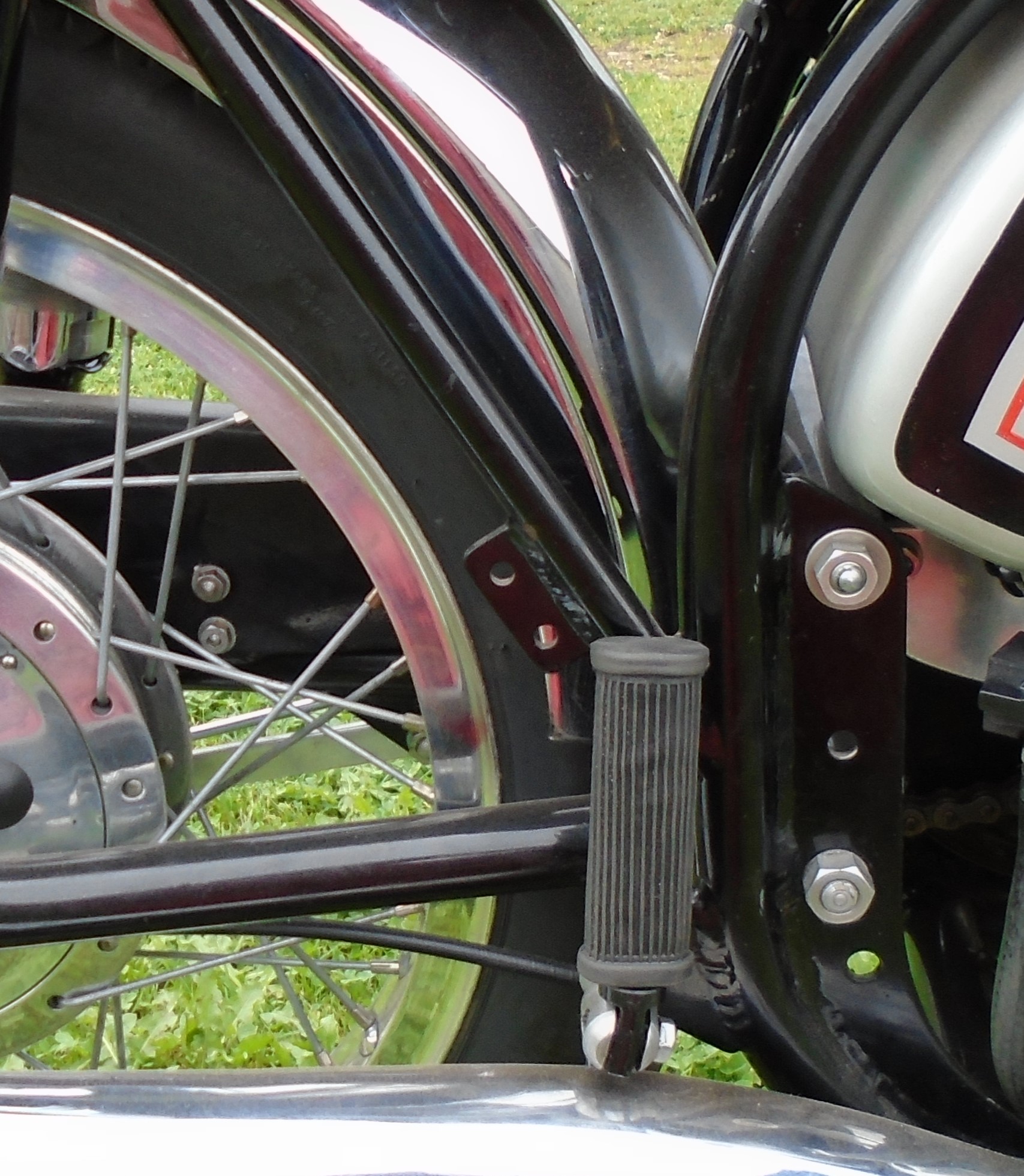

Hi
On my Inter that I know had been raced, does anyone know what the bracket would have been for? The one just above the rear footrest.
Paul
What about race number?
In Bacon's 'Norton Singles', the advert for Manx 30/40 (page 97)  says "Brackets are fitted for the attachment of a fairing".  The picture shows racing number brackets plus a bracket where your is.  It look like it's carrying only a hex bolts.  Advert date 1962.
