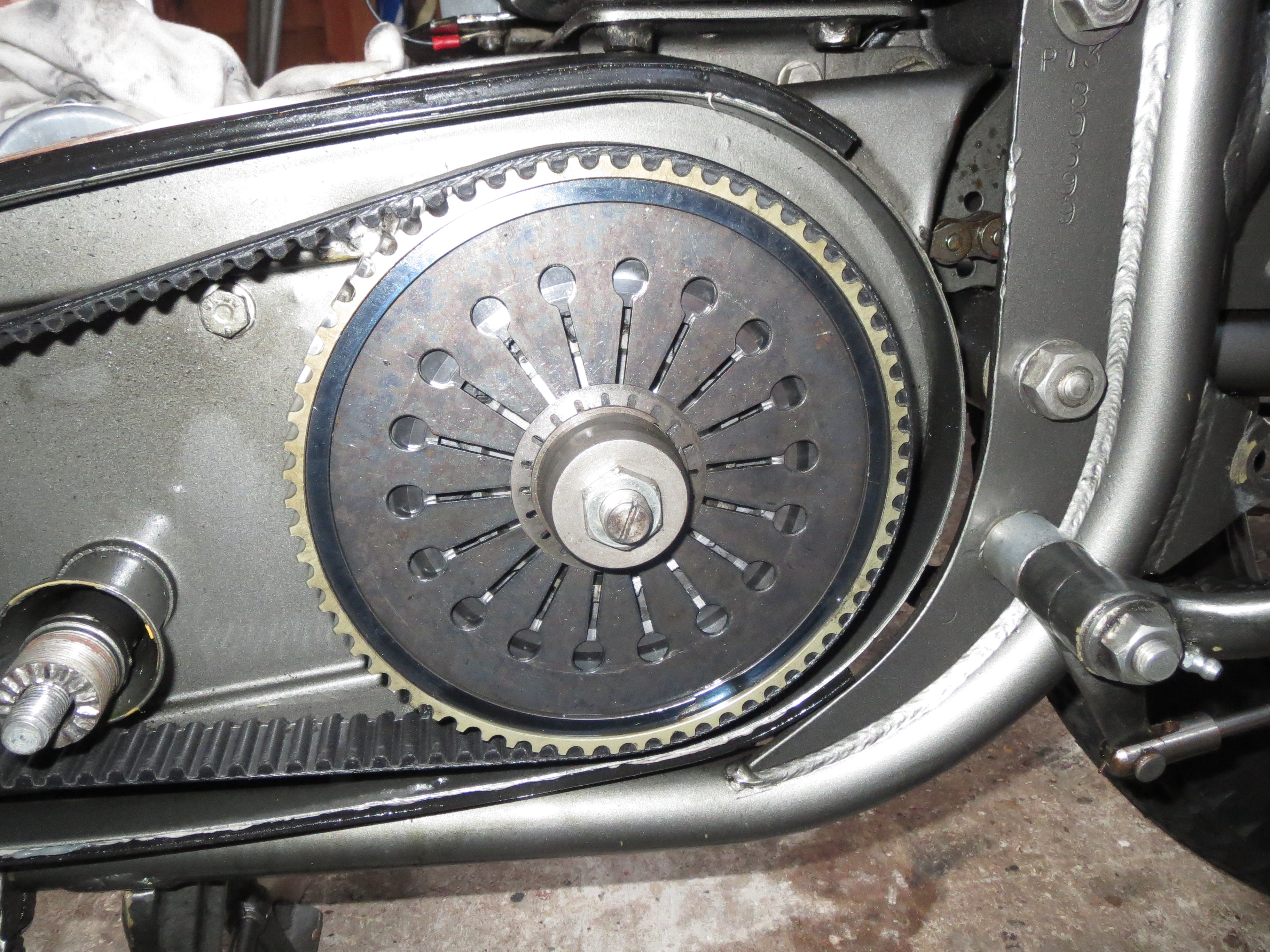

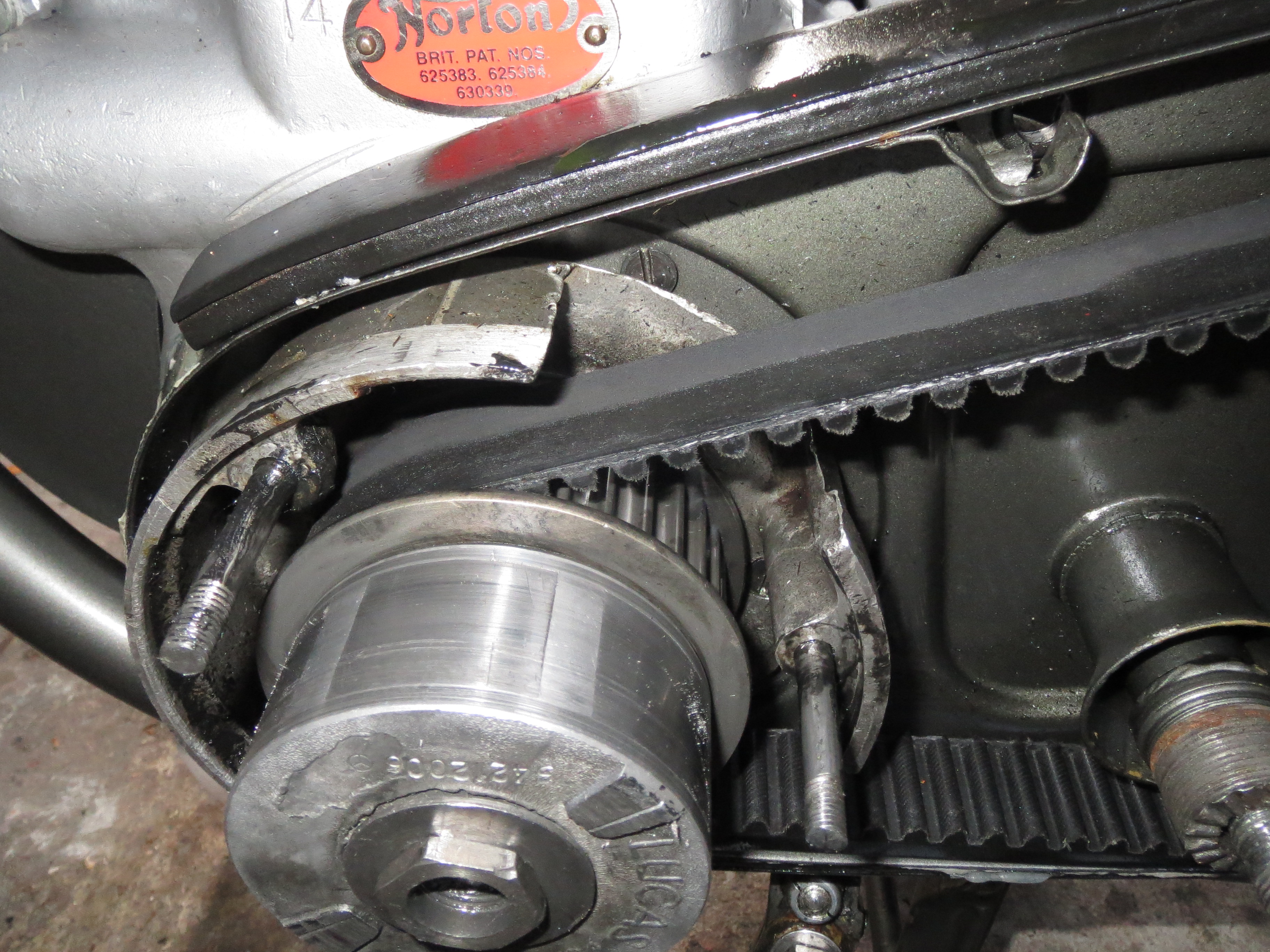

Trying to identify the clutch fitted to my '59 Dominator I contacted Norvil. This is their response:
"From the photographs you sent us in
your email, we can confirm that the
clutch is indeed a Commando one.
We will send you one of our Set Up
leaflets, even though this is not one
of our kits.
The rotor shown in the latter photo
needs scrapping because it is the
2006 Series ones that fly apart,
because the magnets are not welded
to the centre boss.
We will send an attachment to you
containing the relevant leaflet."
Two questions :
1. Who else markets a belt drive kit using a Commando clutch ?
2. The reference to the rotor needing scrapping - is this a known issue ? Can I just replace the rotor or should I replace the sataor as well ?

Yes/No the rotor is certainly likely to come apart eventually, the magnets lift out the centre steel tube starts to come loose inside the alloy. Use it further at your peril. No need to replace the stator unless it has already been touched inside. This will show as polished pole pieces, perhaps burnt encapsulation or even cracked encapsulation.
