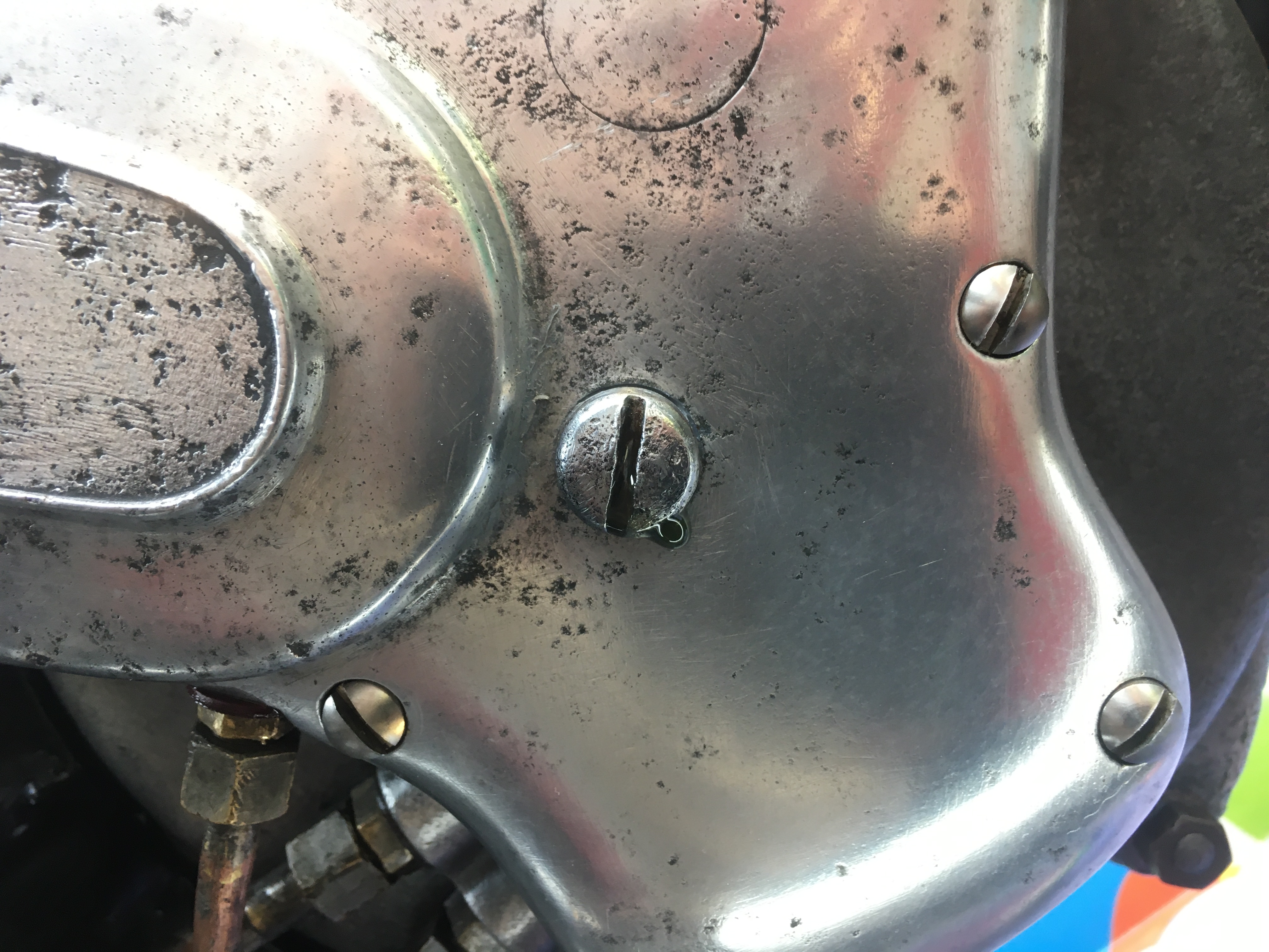

Also the circular cap which hold the spring in the timing chest continually dribbles oil through its centre when kicking over the bike - Is it supposed to have a small hole in its centre please?

   The screw cap retains the big-end feed jet and spring, so no, there shouldn't be a hole. If you cannot find another one you can seal it with solder or 2-pack metal filler or even Araldite.
