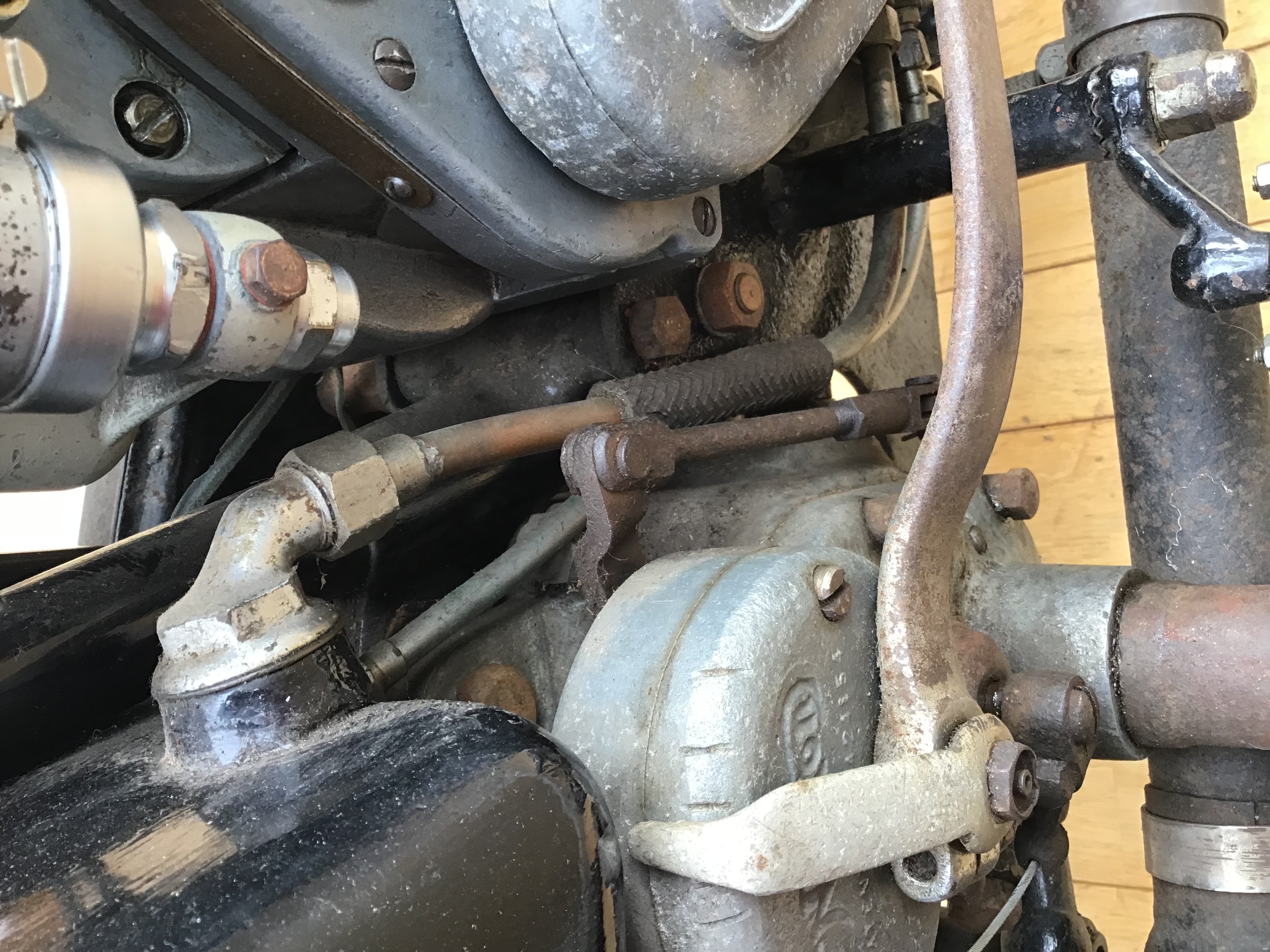

Hi I need to get a new oil pipe made, can anyone recommend where I can get this done or if it’s a standard size, can it be bought off the shelf?
Norton 16h oil pipe
Rigid Oil Pipes
I've never seen any for sale. They were superseded by rubber hoses on the WD 16H and I don't believe that the rigid pipe reappeared after the war.
They're straightforward enough to make using soft copper pipe but unless you have access to a lathe, you may have to recuperate the lower nipple from your old feed pipe.
Norton used a 5/16" union at the oil tank, with 5/16" pipe but a 1/4" BSP union at the crankcase. They achieved this by using a nipple which inserts into the pipe rather than over the outside and from memory a slightly larger opening in the nut. I've never seen these parts for sale.
My exit pipe from the oil…
My exit pipe from the oil tank has a copper crush washer so it will both line up with the pipe and seal at the tank.
Photo to be clear about the pipe I need
