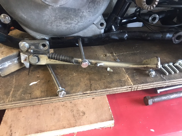

Here is a couple of photos of the side stand on my Navigator.  Would this be the genuine item? Looking at Andy's information the fitting on the frame looks to be Norton, what about the stand, it has two places to anchor the spring.
The spring is a bit feeble, wore diameter of 1.75mm, are new available?

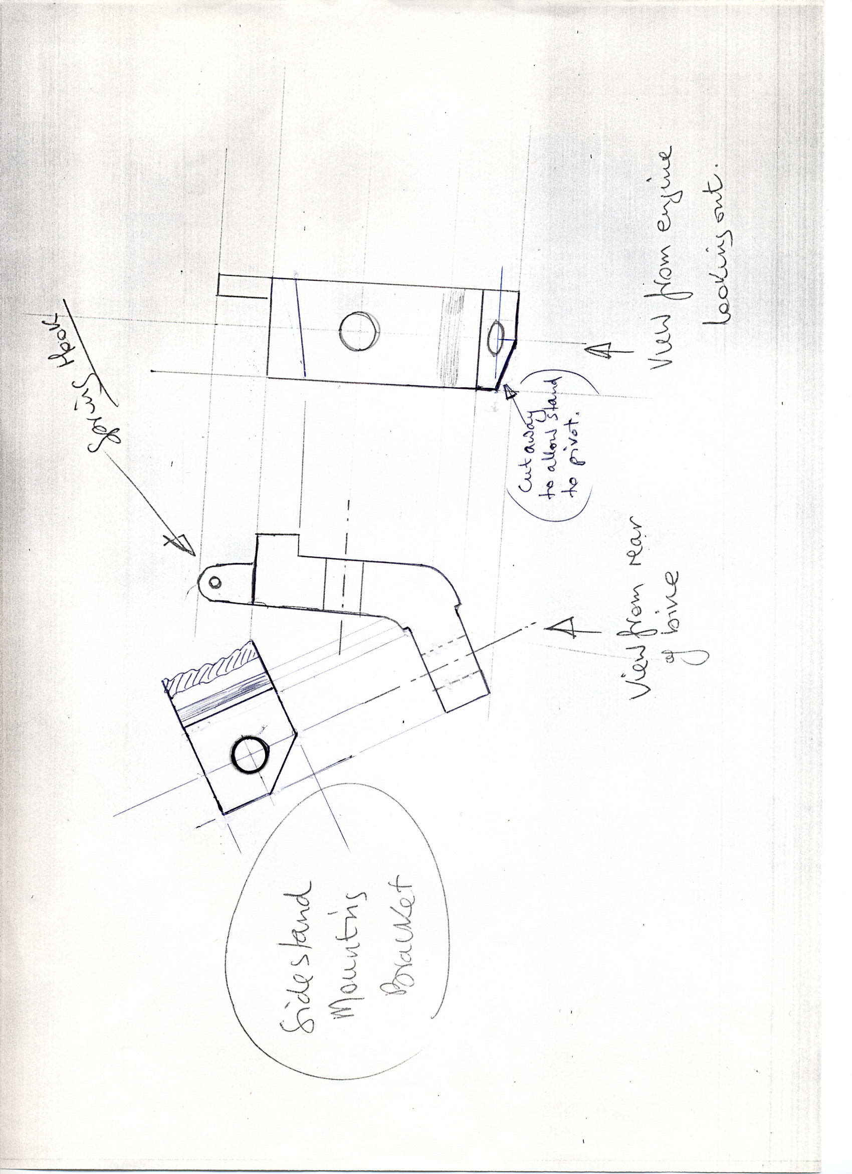

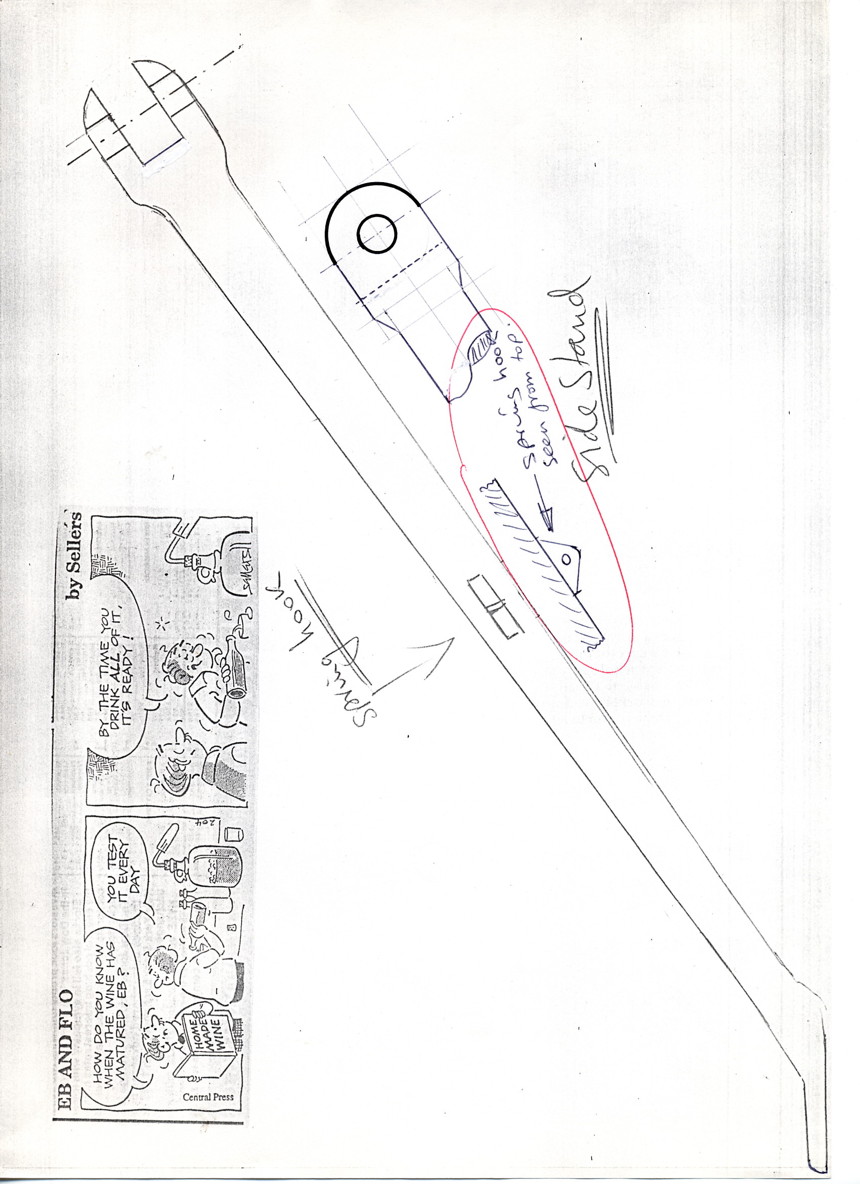

I have to say that I am still not sure how it precisely fits on the frame.  Is there a lug or drilling or does it fit an an engine plate?  Anna mentions "both bolt holes".
The sketches are fairly useful but the dimensions would be most useful.  The leg length being the most important one so that other possibilities can be considered.

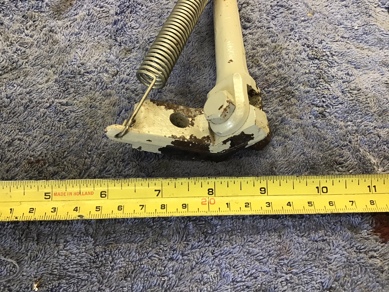

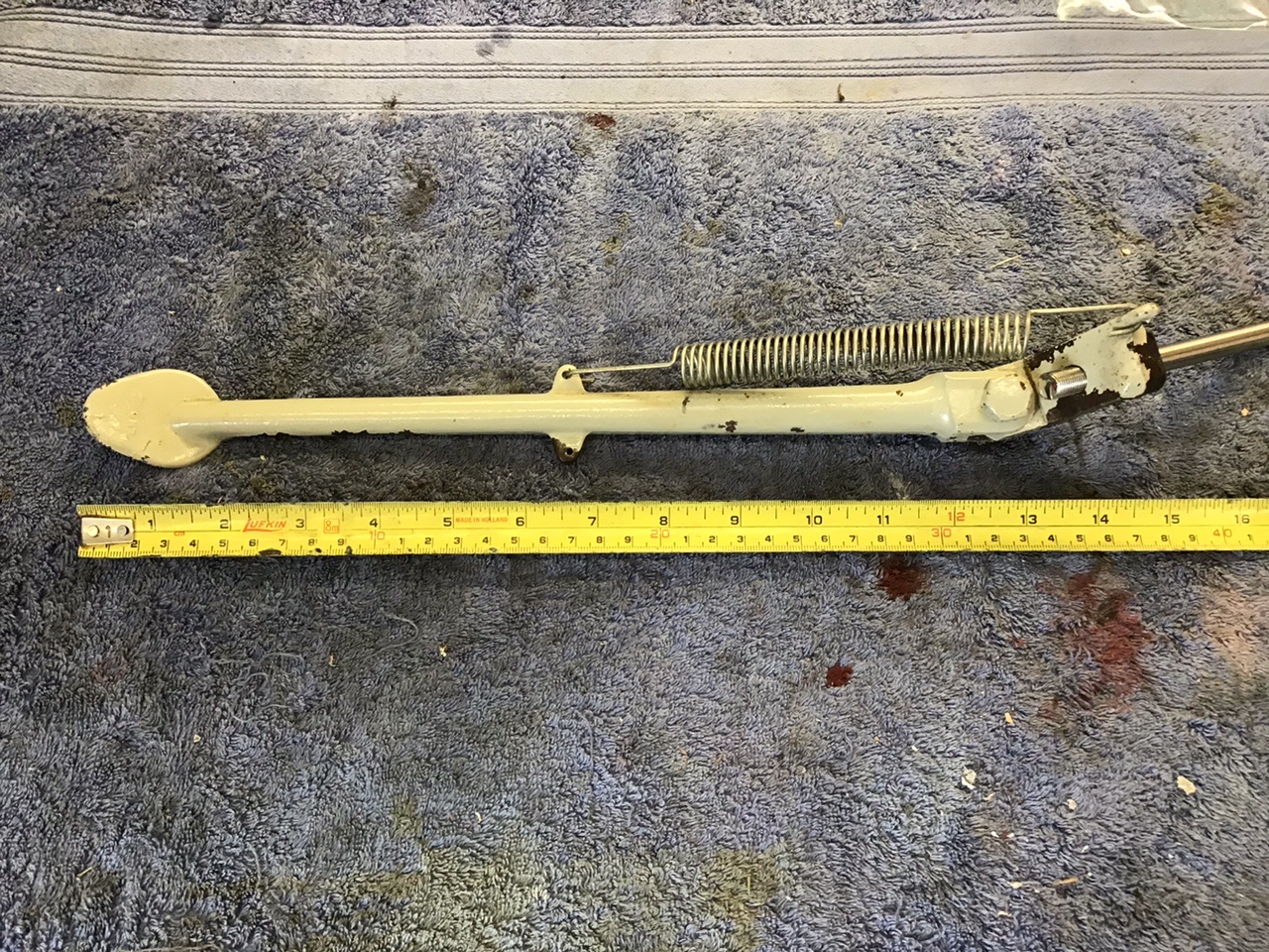

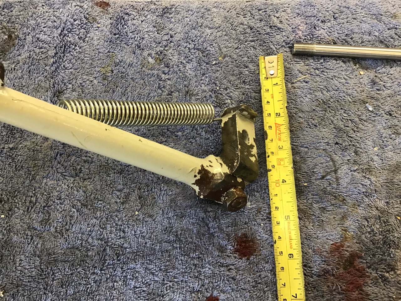

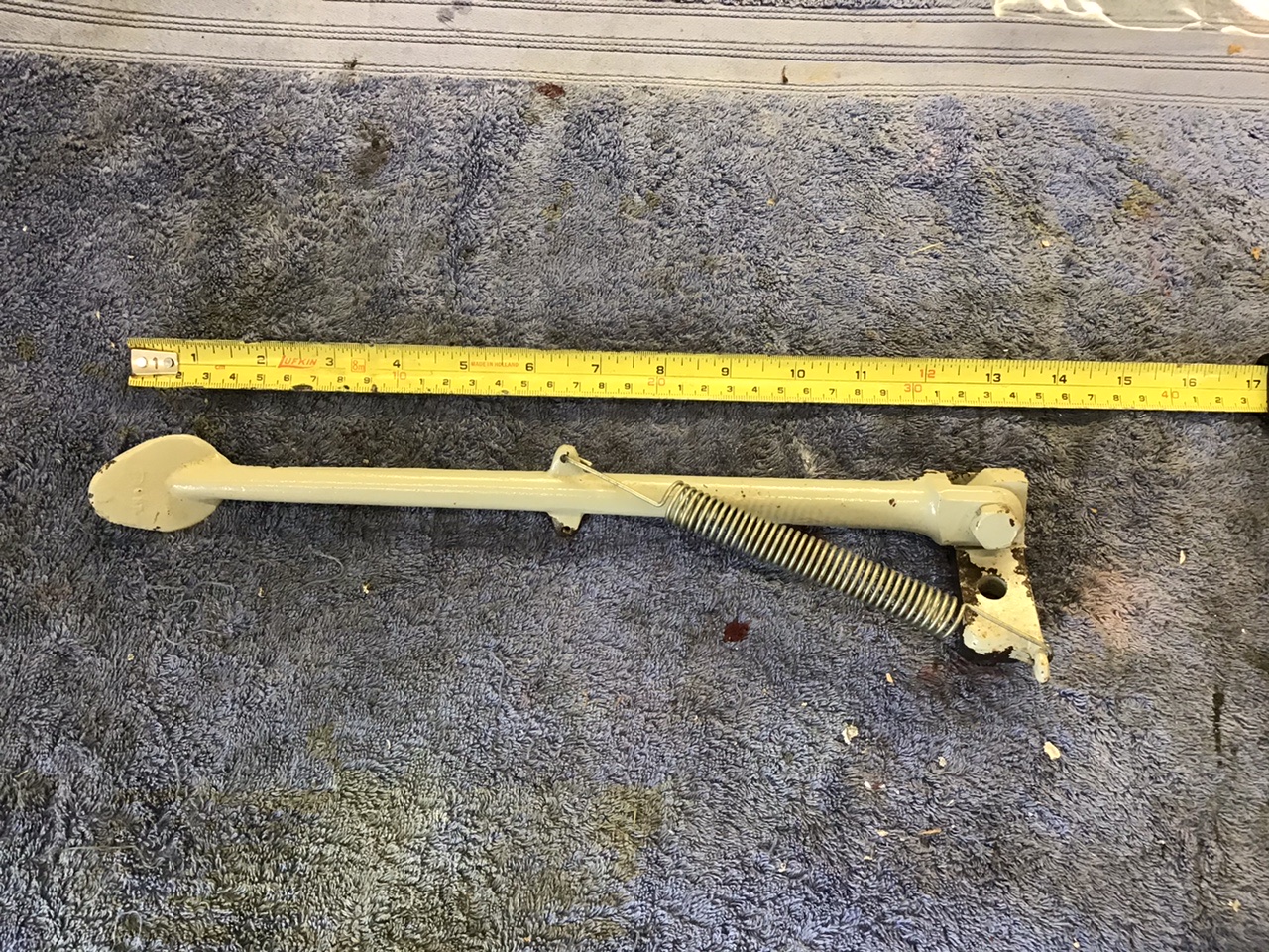

Hi Lionel - photos attached with tape rule beside it, should give you an indication of sizes. Note - the bottom frame stud has to be longer (noc shop says 5”) than standard so swivel block can be mounted on it - one of the pictures shows that stud.
If I can help further just let me know while it’s still in original condition off the bike.

I have a drawing from life on an A4 sheet of paper. Email me your address & I will copy & send.

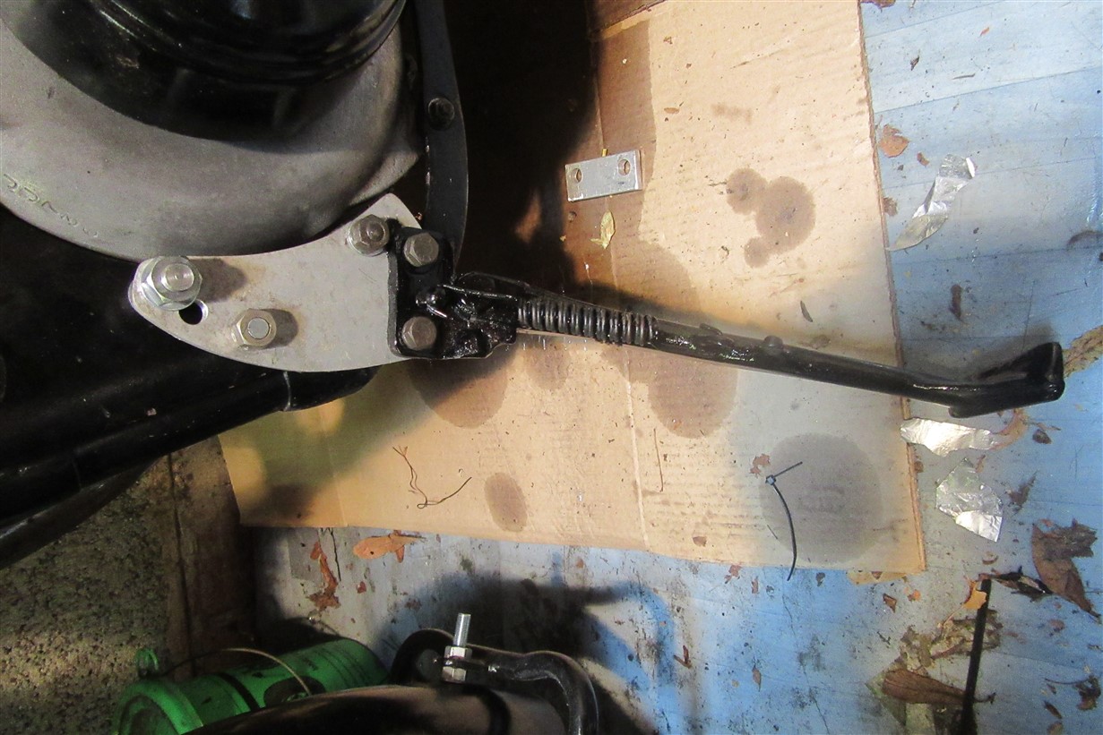

.. Anna's excellent advice (on this topic anyway) and used a Suzuki stand from ebay for around a tenner for my ES2. I had to make a mounting plate but that was easy enough.
Ian,
That looks good. The plates look to give a much better anchorage than the single bolt on the original lightweight stand.

Anna, I have a Kawasaki side stand on my pre featherbed ES2, almost a straight bolt on for £20!  I haven’t looked at fitting on the Jubilee but it should be simple.

This is my Kawasaki stand on my ES2 I’ll be fitting one to my Navigator.
Stand

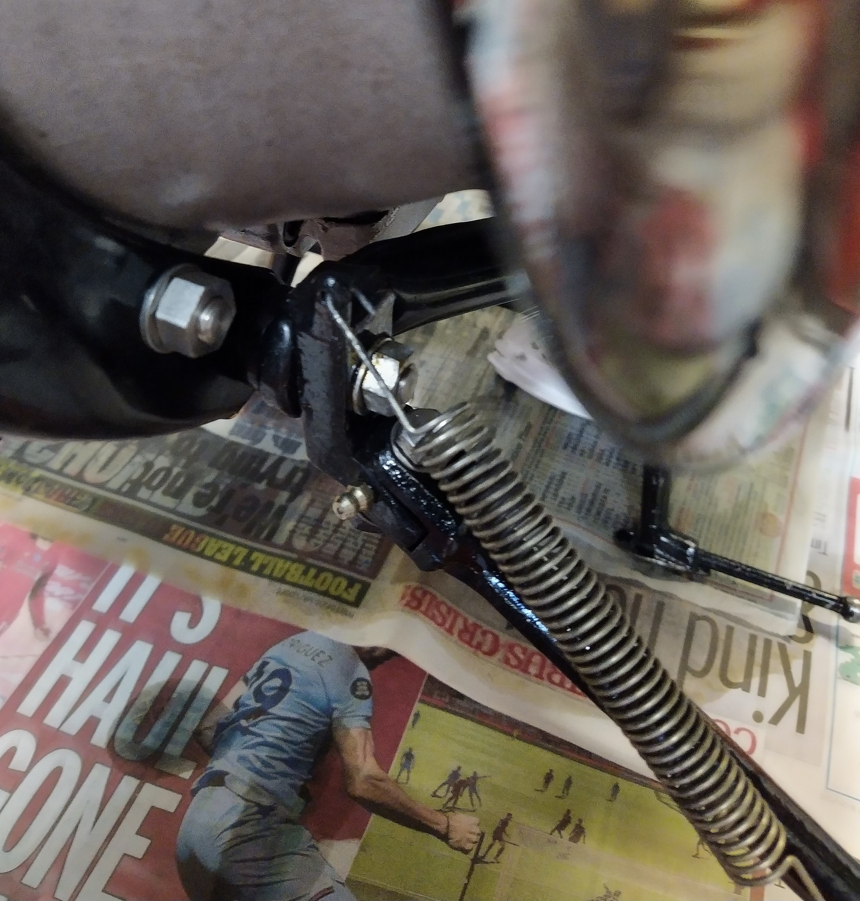

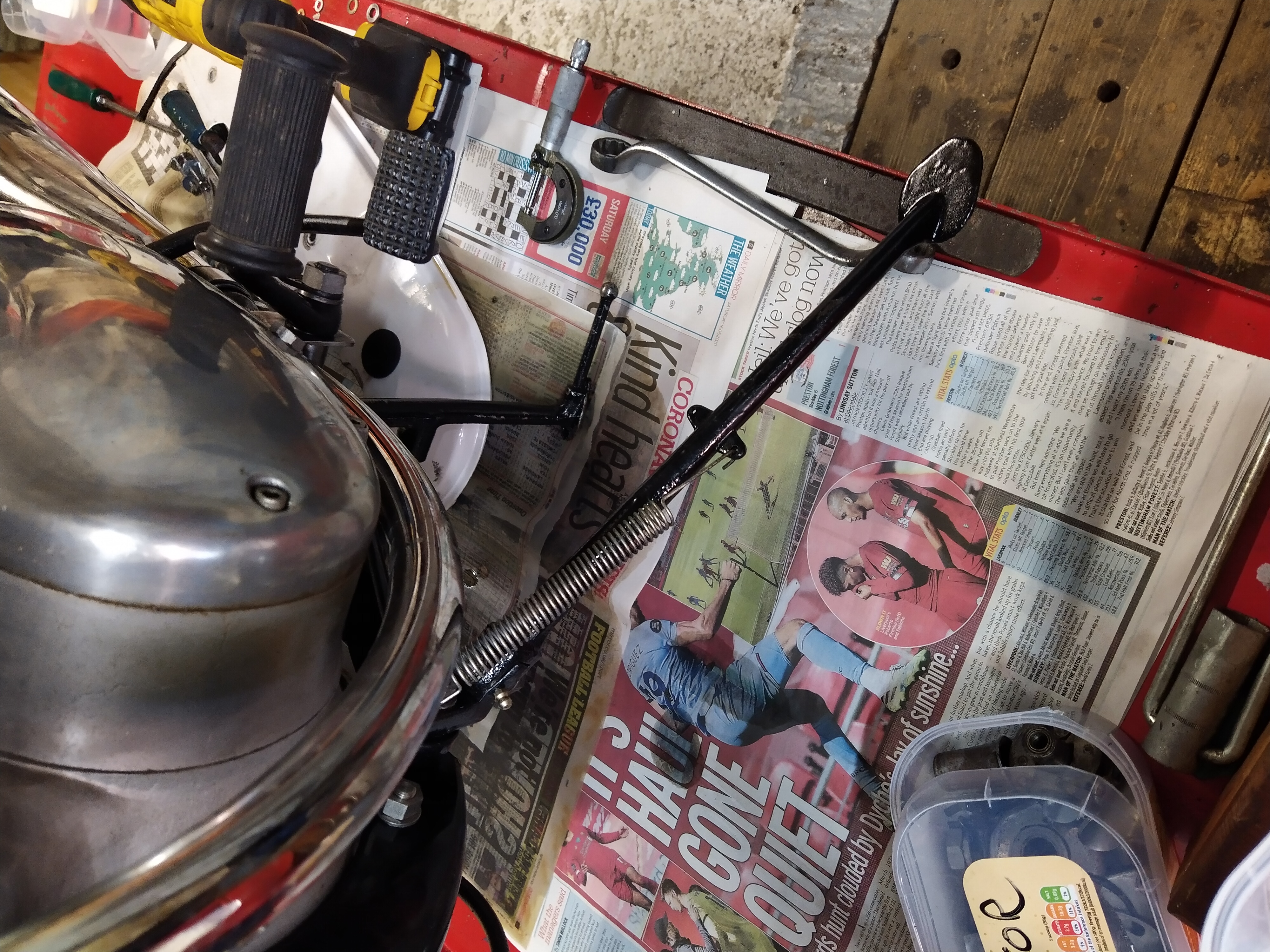

Inspired by all the comments above I thought I'd add a side stand to the "lockdown renovation" of my 1961 Navigator.
(To Ian Soady's point ... yes, there's another Kawasaki leaning against a wall somewhere.)
The photo shows the main steps for a couple of hours work, once the bits had arrived from ebay.
For those who look closely at the photos I emphasise "renovation" rather than "restoration" because there are several non-standard bits including a pair of fairing panels I made from sheet alloy (tin snips and rubber mallet essential), non-standard handlebars and the non-standard front mudguard which Andy S has already spotted.
Thanks for the original inspiration for the stand. More fettling to do though so I'm off to the garage now to try and adjust the clutch so I don't need to develop a left forearm the size of Popeye's to operate it.
