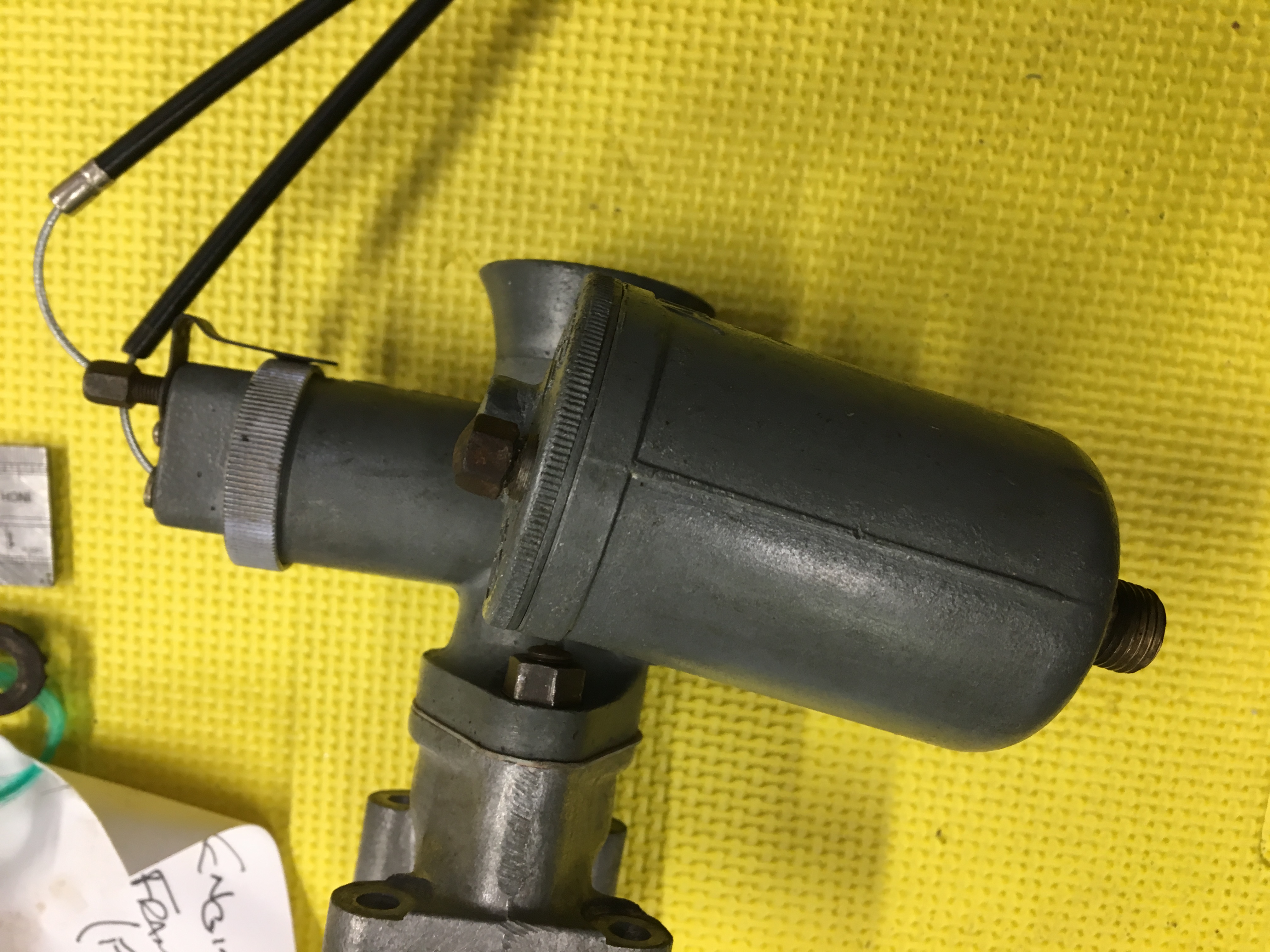

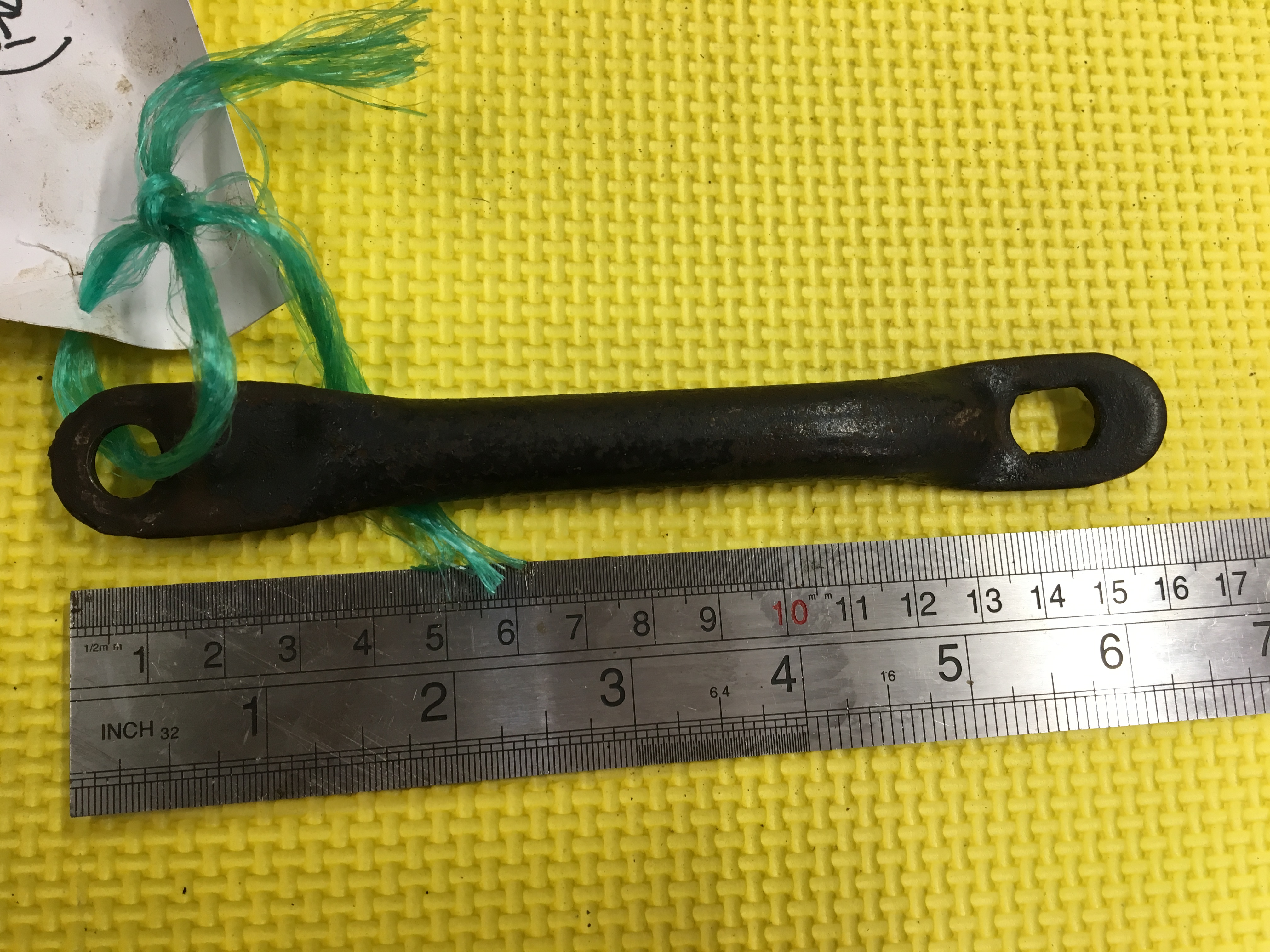

I’m also restoring a 1952 Model 7 plunger.  Here’s a couple of pics with the carb finish now that 55years of crud has been removed. I’m pretty sure this is the original finish.  Also one of the Head steady
Hope this helps

Thank you for the pictures Doug. Now I see how simple the head steady is, I can make one no problem.
