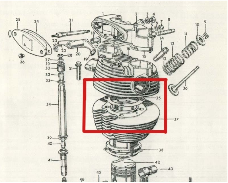

Hi Mike Have you looked…
Hi Mike
Have you looked HERE at racingnorton.co.uk?
The description clearly states that an aluminium head gasket was used from 1956 - 1959, also see the picture from the 1957 parts catalogue.
