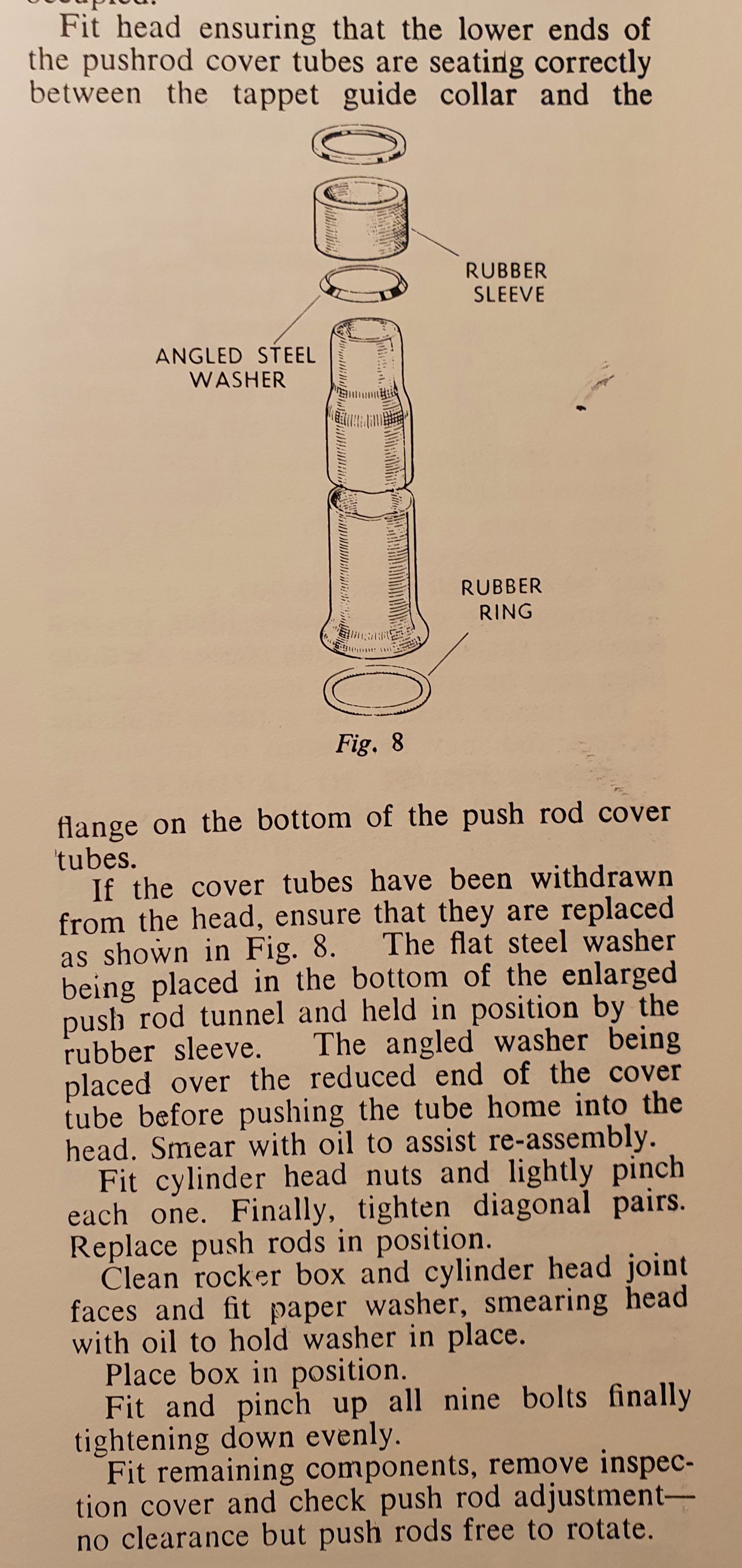

Is there any trick or tip to fitting the push rod tunnel seals in the cylinder head ? I have tried inserting the seal into the head first, but then I can't push the tube into the seal. I have tried putting the seal on the tube first, but then I can't get the assembled tube into the cylinder head. It all seems a bit too tight. All is well oiled but I still cannot assemble it.
Should I loosely fit the tubes in the cylinder head and use the head bolts to pull it down ? But that seems a bit drastic to me.
thanks for any help

Thanks for your reply and attachment David. I do already have the manual. I will try again.
I insert the top washer and…
I insert the top washer and rubber seal into the head first with light smear of non hardening sealing compound (e.g. Curil T), to provide some lubrication. Rubber grease would probably be fine as well. I then slide in the tubes and bottom bevel washers similarly lubricated until they are essentially home. When the head is torqued down it all seems to sort itself out. BTW I can recommend VW air cooled pushrod rubbers (German apparently better than South American origin) for the bottom pushrod tube seals.

I would repeat all of the above except that I just give the tube and rubber a coating of silicon grease because it doesn't cause the rubber to perish and split.

Hopefully someone will turn up. Do you have the attached manual extract?
