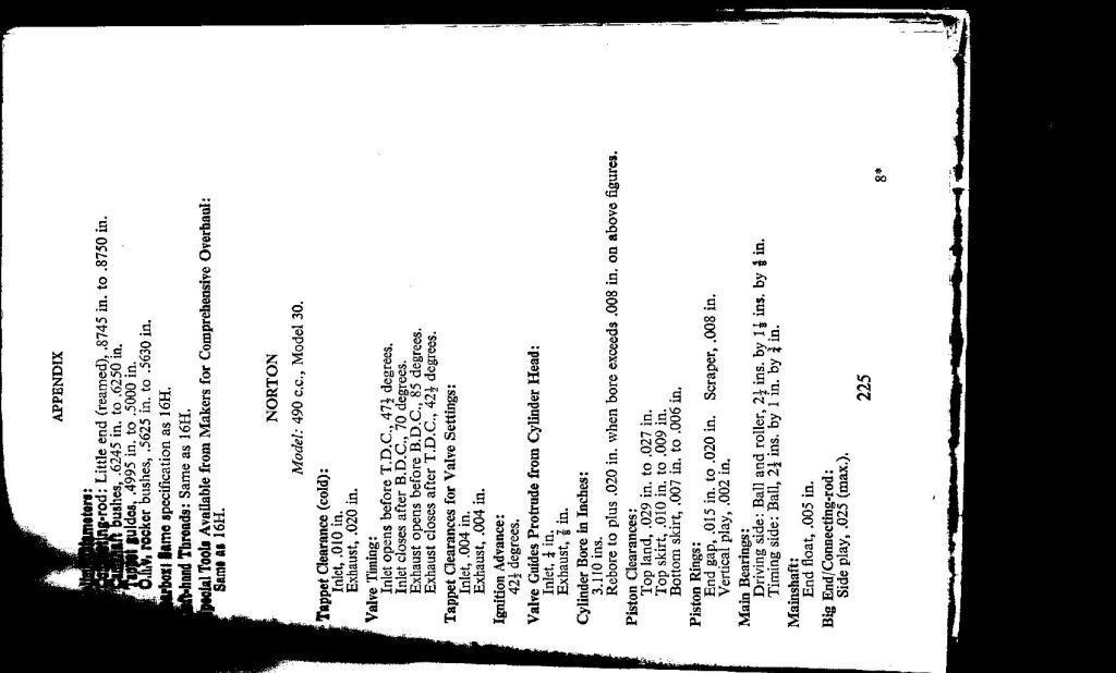

Hi Mark, I haven't got a lot of tech info, could you post a picture of the page where you get 42.5 degs BTDC please. The book I do have shows between 34 and 37.5 depending on the compression ratio. This is for the single and double knocker long stroke engines.
Here's a copy of the pagehttp://s1080.beta.photobucket.com/user/Horror/media/Manxlongstrokemagtiming.jpg.html
Andy Savage double checked my timing before he started the bike and that was about 35 degs BTDC.
I would have thought 42.5 would make the bike an animal to start. Barry Stickland also said my timing was wrong and it should be set at forty something. I think he said his was set at 49..? Sounds very advanced to me. I did see him bump starting his bike, the back wheel was locking up and almost skidding backwards. However, I have kept the adv/retard lever on my Manx so I can retard it to start if needed.

Here's the ignition timin…
Here's the ignition timing info, presumably for an Inter. I would expect a Manx to have less advance due to its higher compression ratio. Gordon.

Hello all
In answer to Dave Graham's reply, I got the figure of 42.5 degrees from the technical section on this site:
I pulled off the magneto sprocket last night, it gave up the fight relatively easily. I will set the timing up tonight and have another go. I am feeling more inclined now to strip the engine and check it throughout before I use it in earnest though.

Thank you both for the inf…
Thank you both for the info, that's interesting and confusing. Thanks for the page from the book Gordon. The NOC website says 30Mby mistake,which would be a Manx, but either way it says 8:1 c/r which according to my book would make the timing 36 degs for compression ratios between 7.5-10:1 maybe my books wrong and I need to advance the Manx a bit.
The proof is in the pudding, as they say and you'll soon know if it's too advanced or not. You can alter it on the adv/ret lever and see how it feels.
Good luck tonight setting your Inter up and hopefully it'll burst into life.
