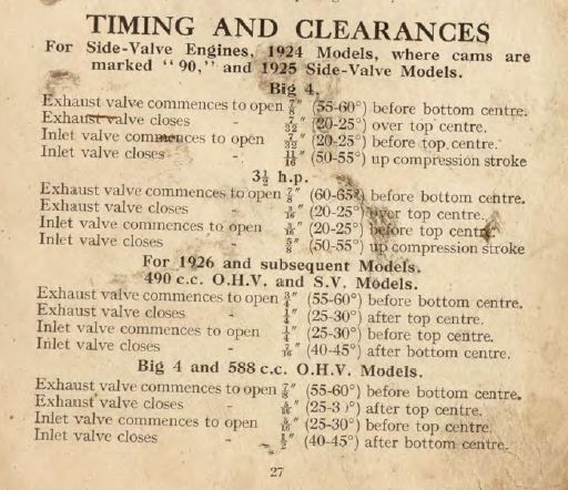

I was in a similar situation so I put a degree disc on the crankshaft and timed the valves as per the attached table.
The bike starts and runs, seems to rev well but i've not yet used it on the road.

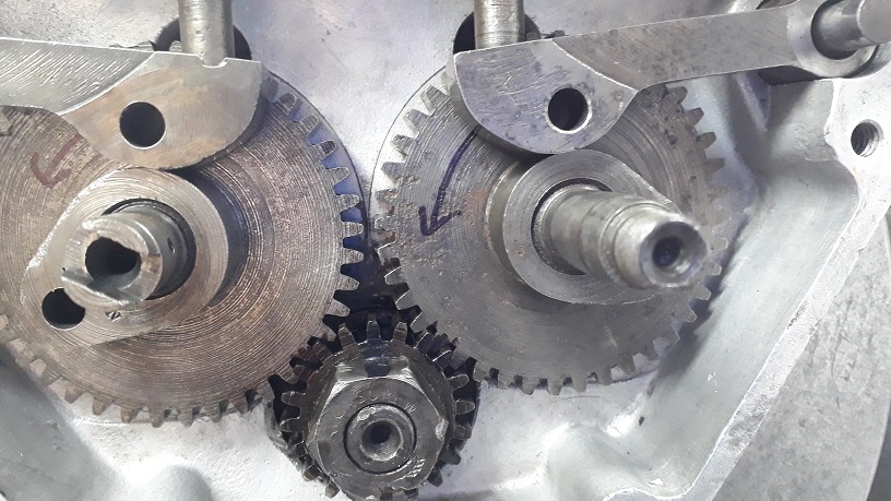

I've attached a picture of my cams as there were a couple of different types.
The table attached is taken from a Norton maintenence manual downloaded from
www.vintagenorton.com
Hope this helps, good luck
