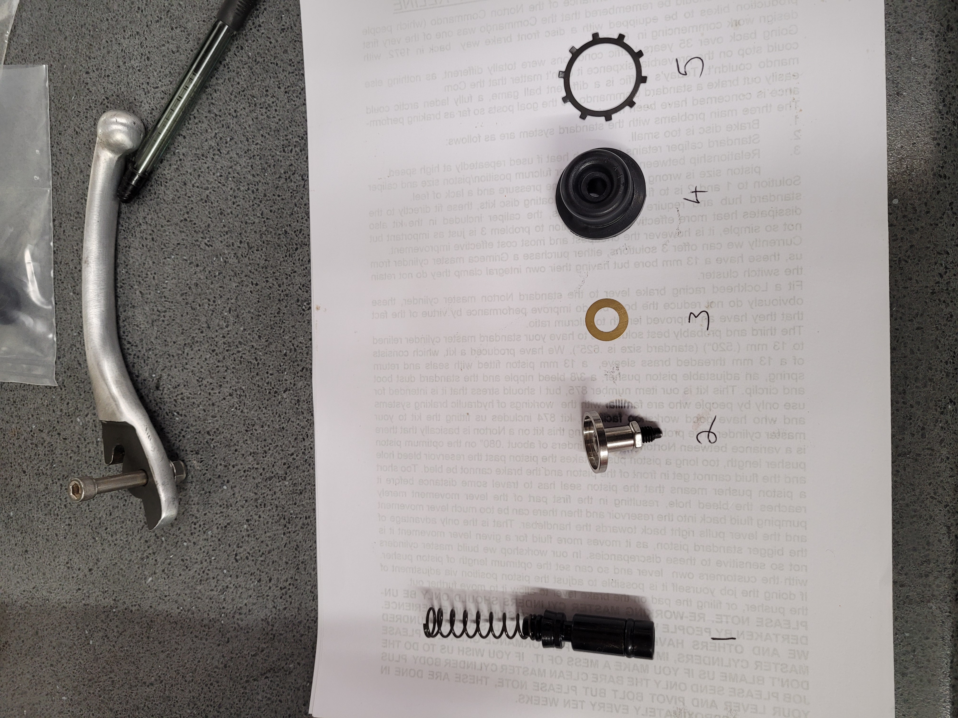

I'm struggling to find the correct assembly instructions for my master cylinder modification from RGM.
I have drilled & tapped the master cylinder and fitted the sleave without an issue, but can't figure out the correct assembly order for the piston parts. I have attached a photo of the parts and numbered them.
I'm guessing 1 goes in the cylinder spring first.
2 is adjustable, what adjustment & what way round?
3 was with the original (16mm) seal kit, along with 4 & 5.
Any advice would be greatly appreciated.
