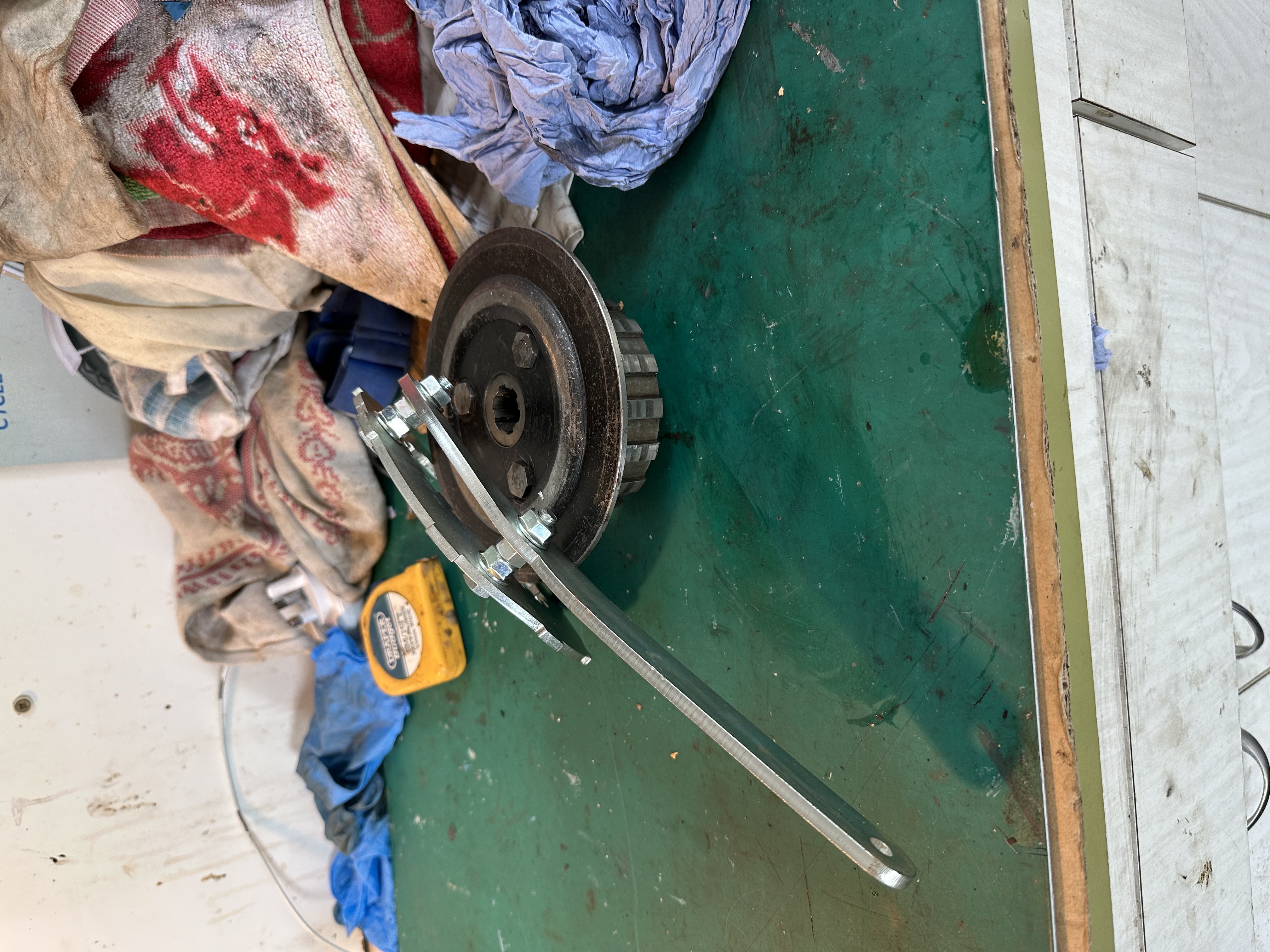

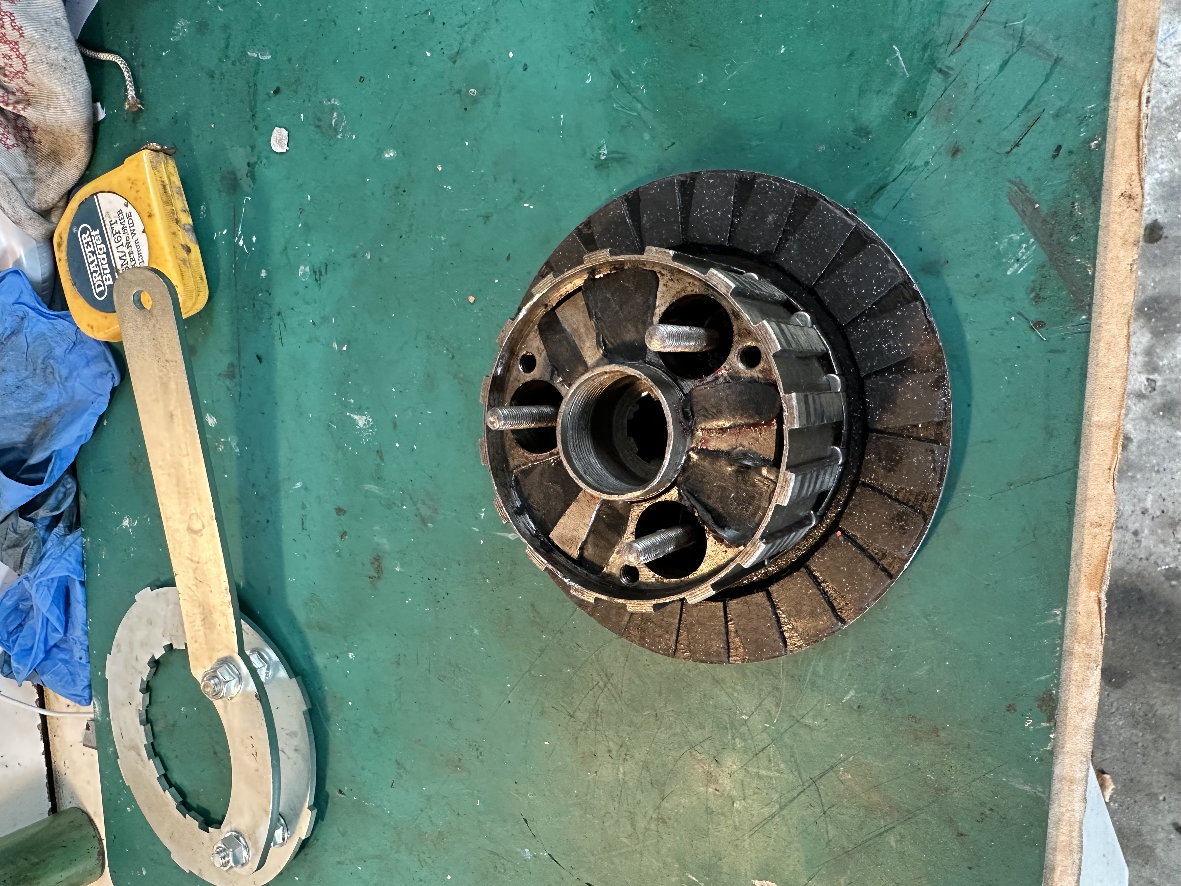

I needed to do this job too and after reading all this was dreading it and conjured up an idea in my head to make a jig with screw jacks to compress the rubbers whilst leaving my hands free, but I decided that I would have a go doing it the traditional way first.
Equipped with a suitably sized Stillson handle poking out of the vice, a length of steel angle bolted to an old clutch plate and a new set of AN rubbers lightly smeared in rubber grease, I commenced.I popped the large ones in first, leant on the bar with my hip, which freed up two hands to attend to the small ones, which slid in easily. All done in less than 5 minutes with no sweat.
