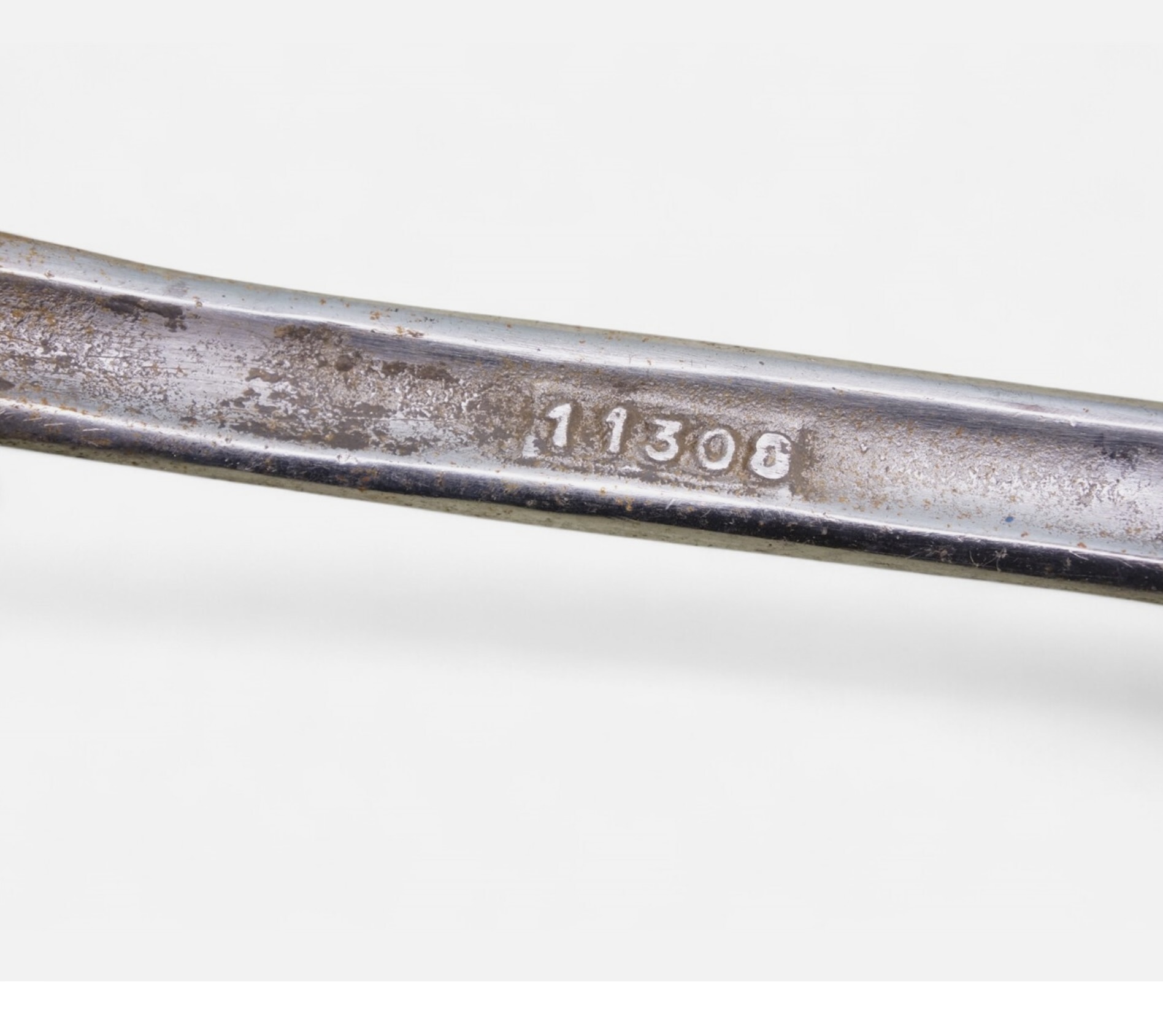

I have the wrong rear brake pedal on my rigid frame ES2. I am looking to get the correct pedal. Does anyone know the casting number? There are a couple for sale here in the states on EBay motors. Descriptions are poor but pictures of the casting number are provided. I checked the NOC spares and they do not have one. Does anyone in the forum have one for sale?

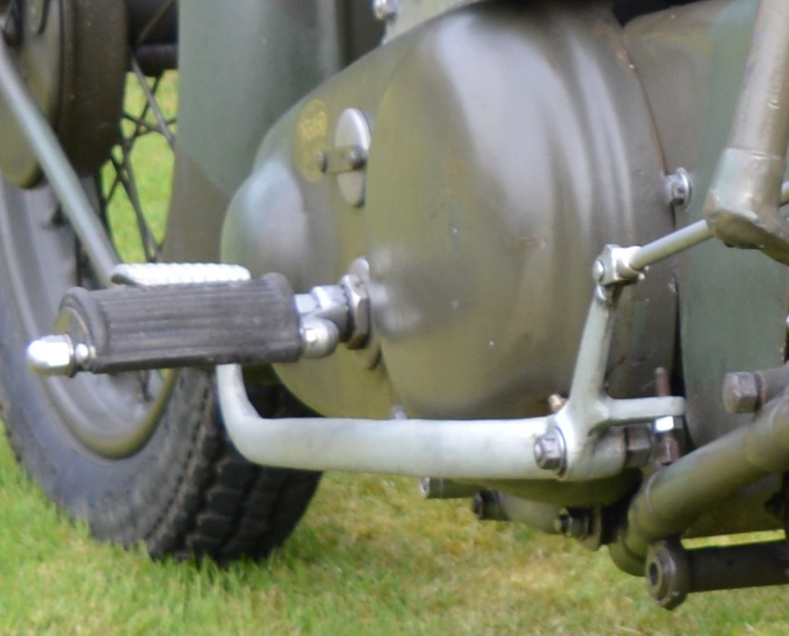

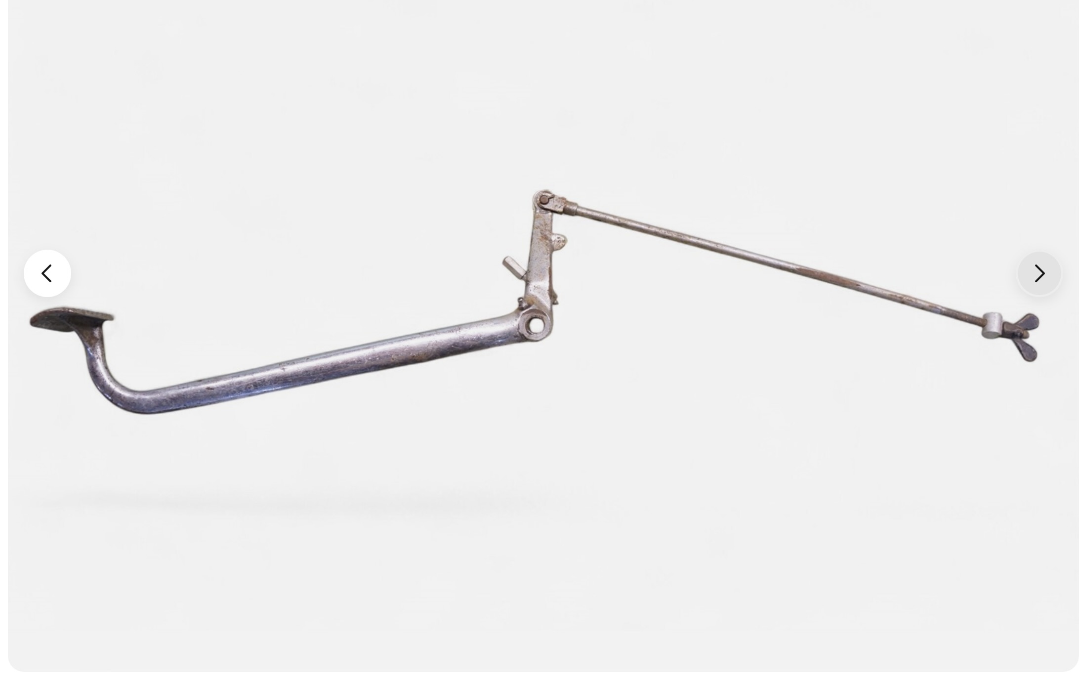

Is the first picture yours? …
Is the first picture yours? It looks correct. There might be slight variations in length, but they aren't likely to affect braking.
The rod has various bends in it - all the Norton ones I've seen are straight. Cranked rod will make it possibly slightly more flexible but the force will be the same at each end. Bends will just make the pedal move a little more.
Pads must of course be perfectly free of oil and grease. Cams and pins need high temperature on assembly. The grease nipple on the outside is an invitation to disastrously over-grease. Modern greases are better than they were in the 1930's when they oxidised more quickly.

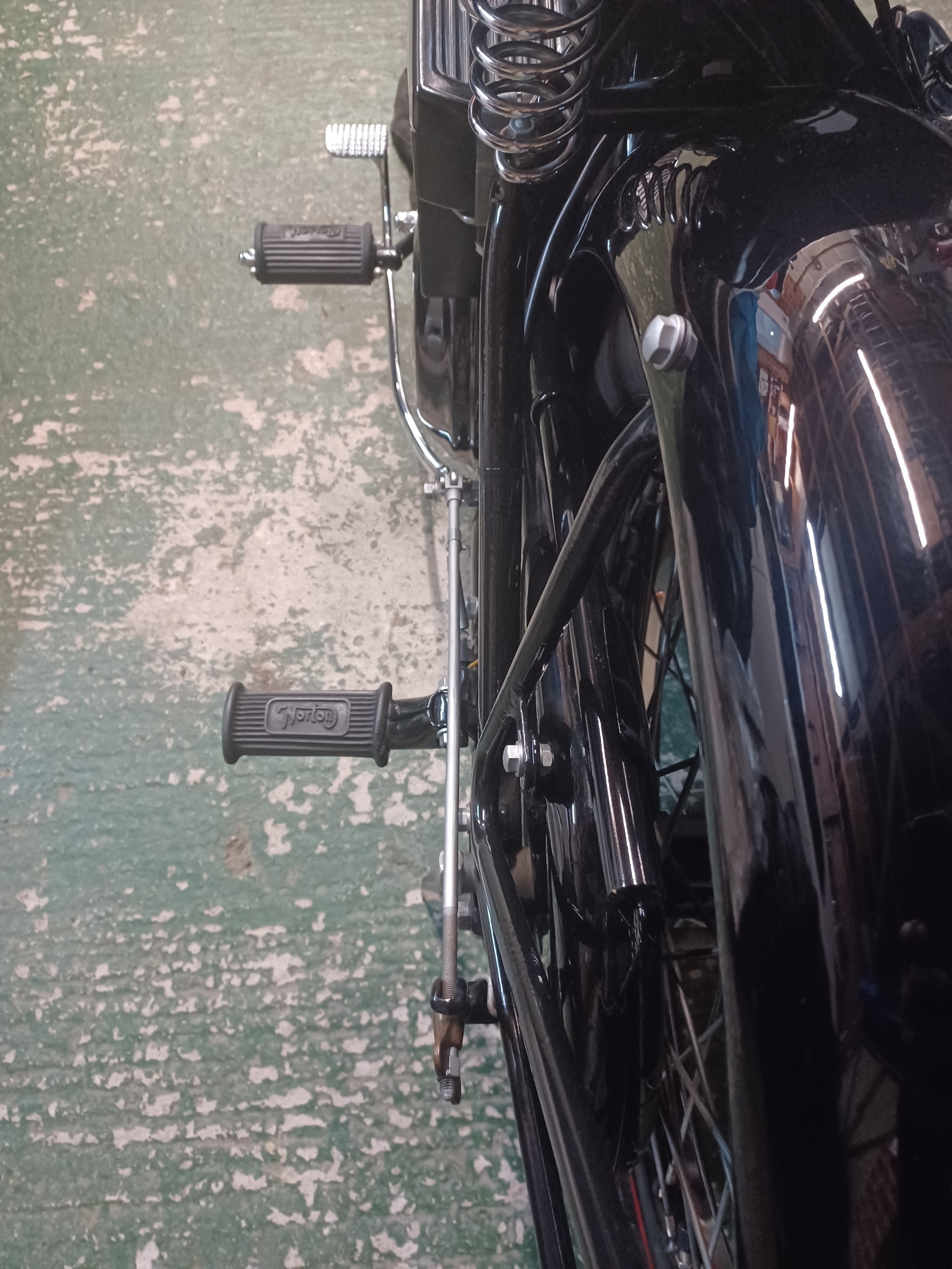

What does the rear lever look like? We can't see it in the first picture. The back brake should easily be capable of locking the wheel.

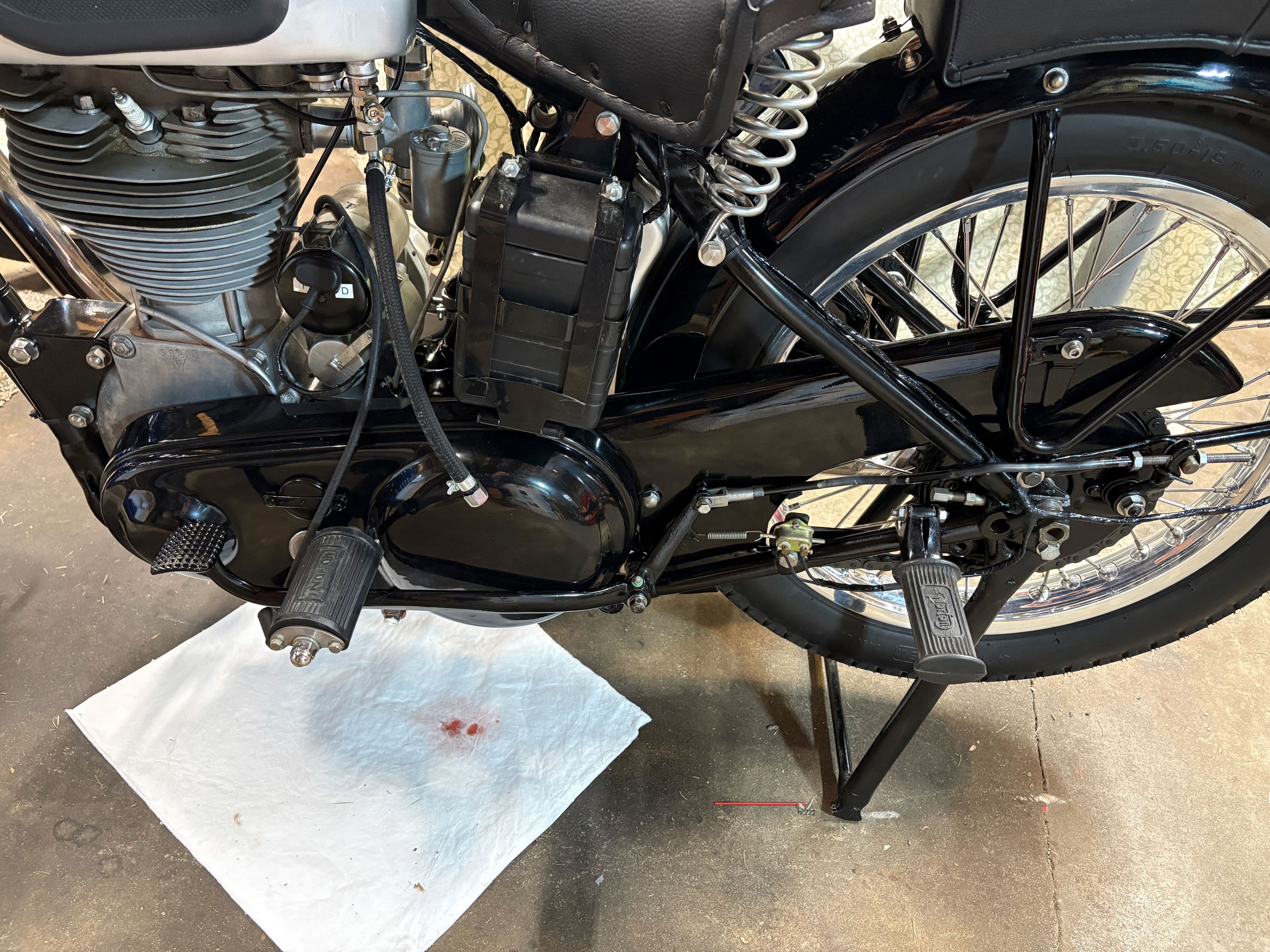

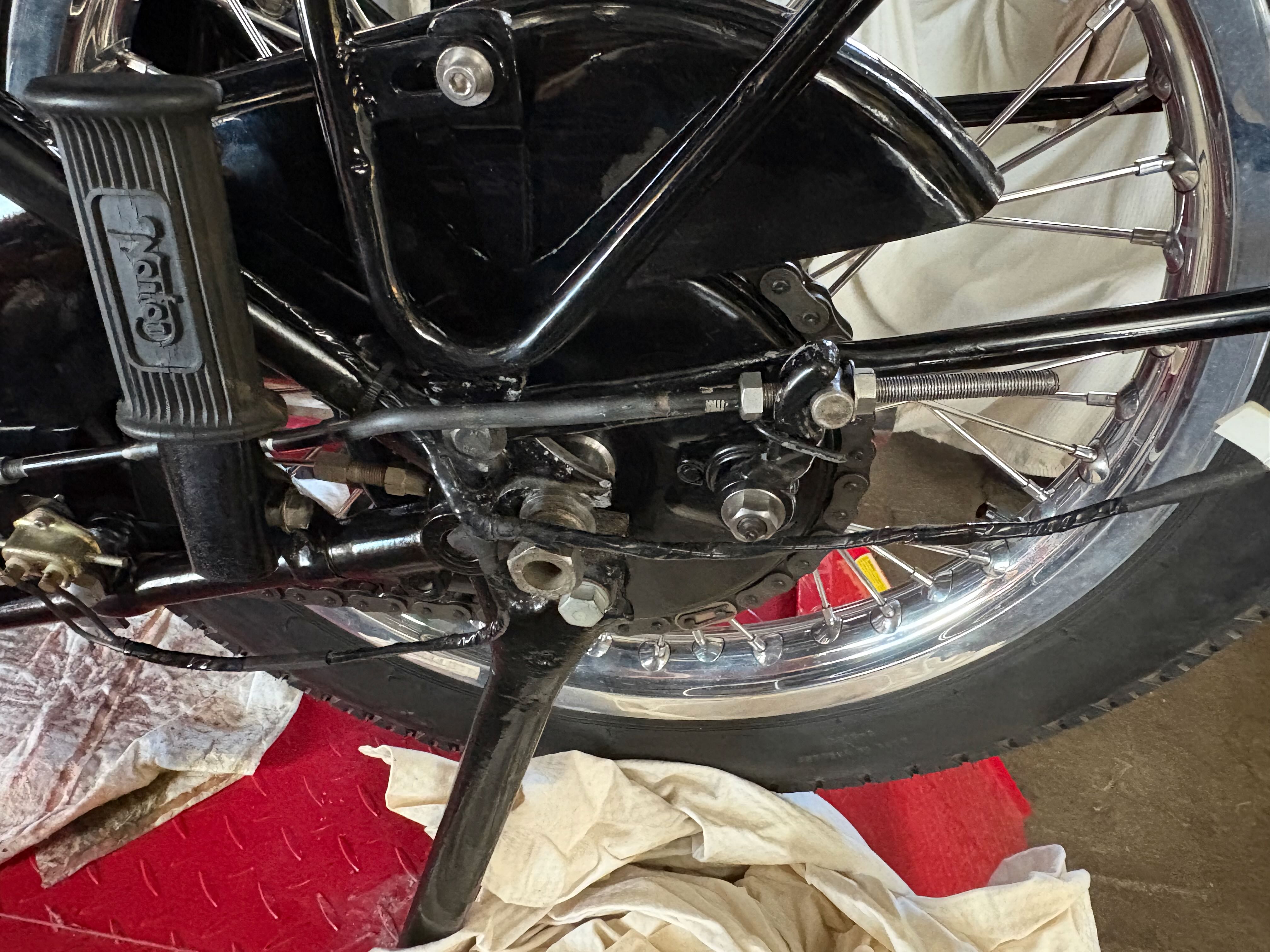

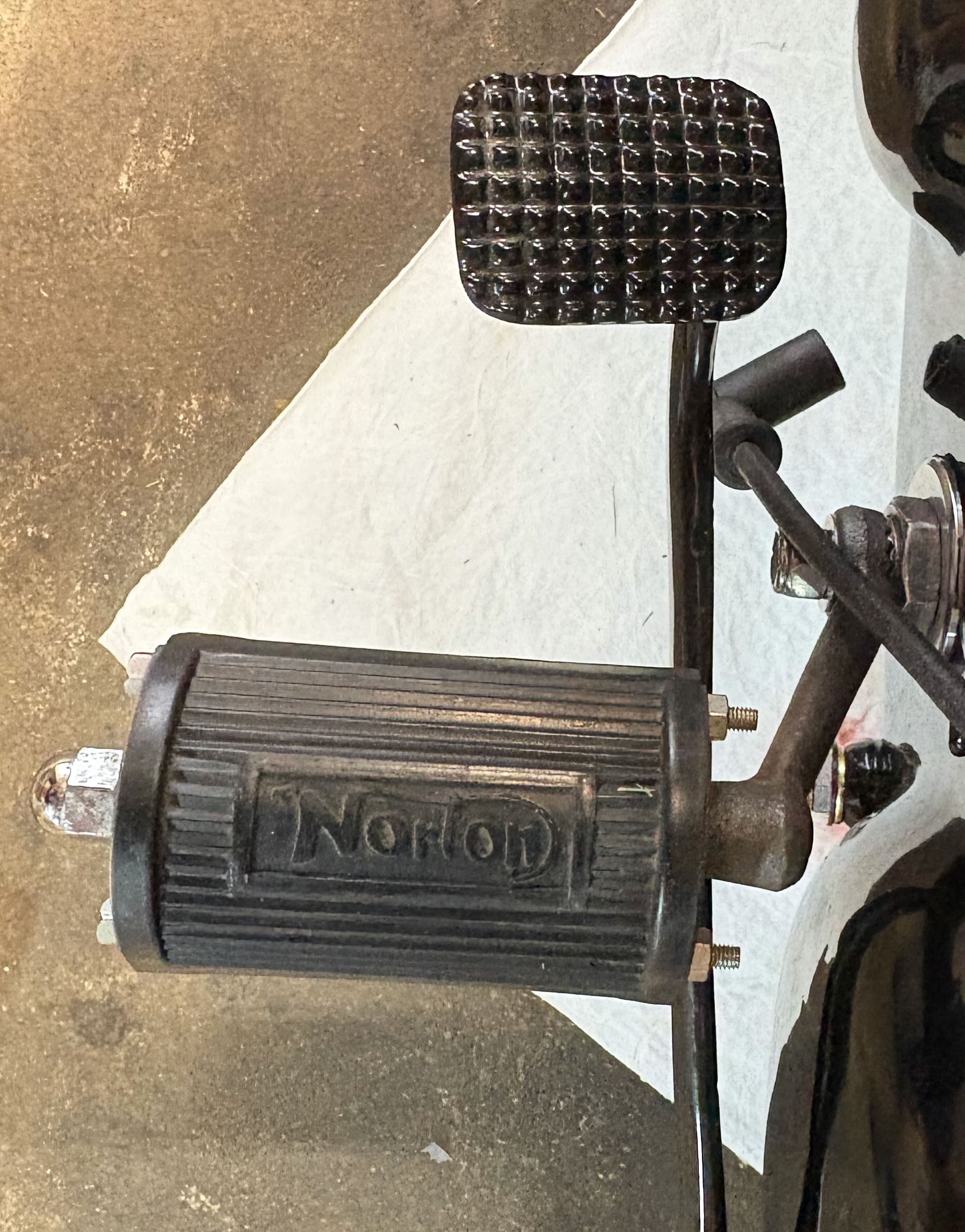

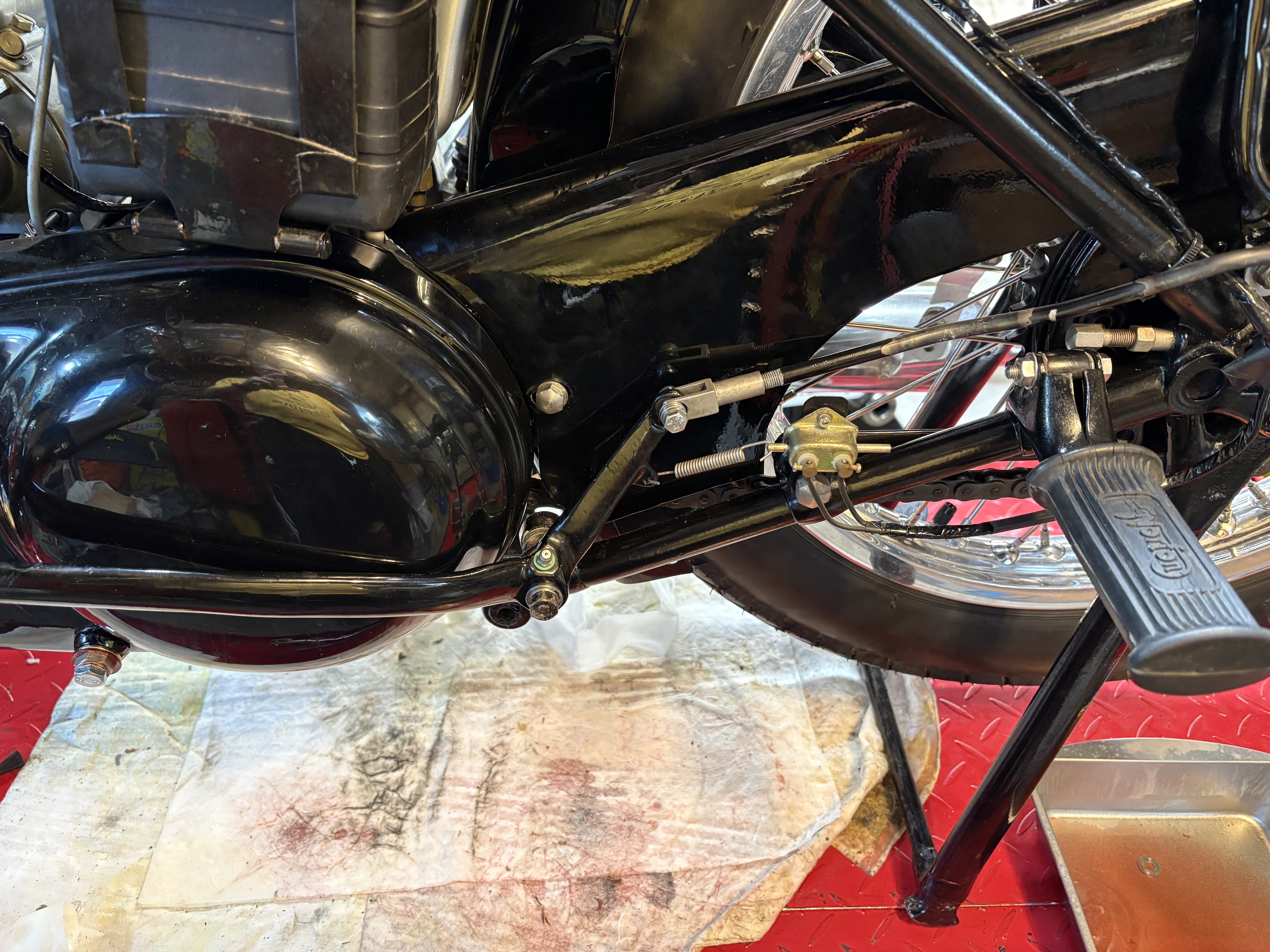

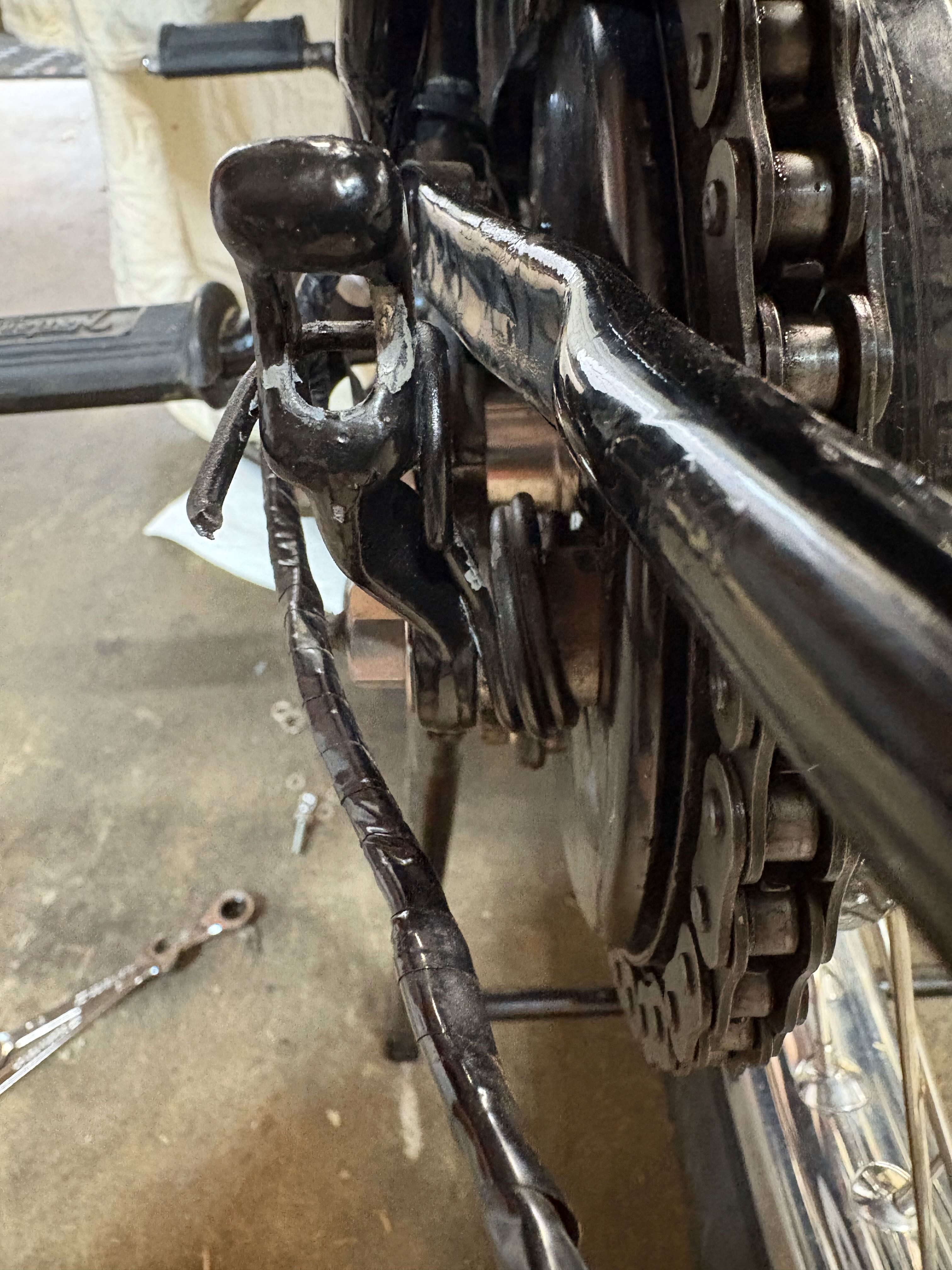

Sorry for the confusion. The first two pictures in the previous post are of a pedal on Ebay. I believe it is the correct pedal, but I want to be sure before I purchase. I roughed up the new brake shoes to make sure there is ample friction between the shoe and hub OD. Attached to this comment are two pictures: 1 - current brake pedal on my bike and 2 - the brake arm on the rear brake hub. Any and all help would be great.
Thanks.
Norton Brake Pedals
What year is the bike ? Presumably pre-war if it's an ES2 and rigid ? All the pre-war civilian models used the same part number for brake pedal. There was additionally a longer pedal for the military models as they used more-forward footrests.
Would there be any chance of a look at the complete pedal ? Norton pedals always seem to have had a cross-hatched surface.
I don't understand why it has been necessary to crank the rod. It should run in a straight line. The lever on the back of the pedal looks to be angled too far backwards and far too close to the chainguard. By the way, your chain spring clip is facing in the wrong direction and will detach itself if it contacts anything.
This is a WD pedal and rod. Civilian was an inch and a half shorter but otherwise identical. How long are your footrest arms ?
The longer military levers are marked N4 and 6732A. From memory, the civilian version was simply 6732.

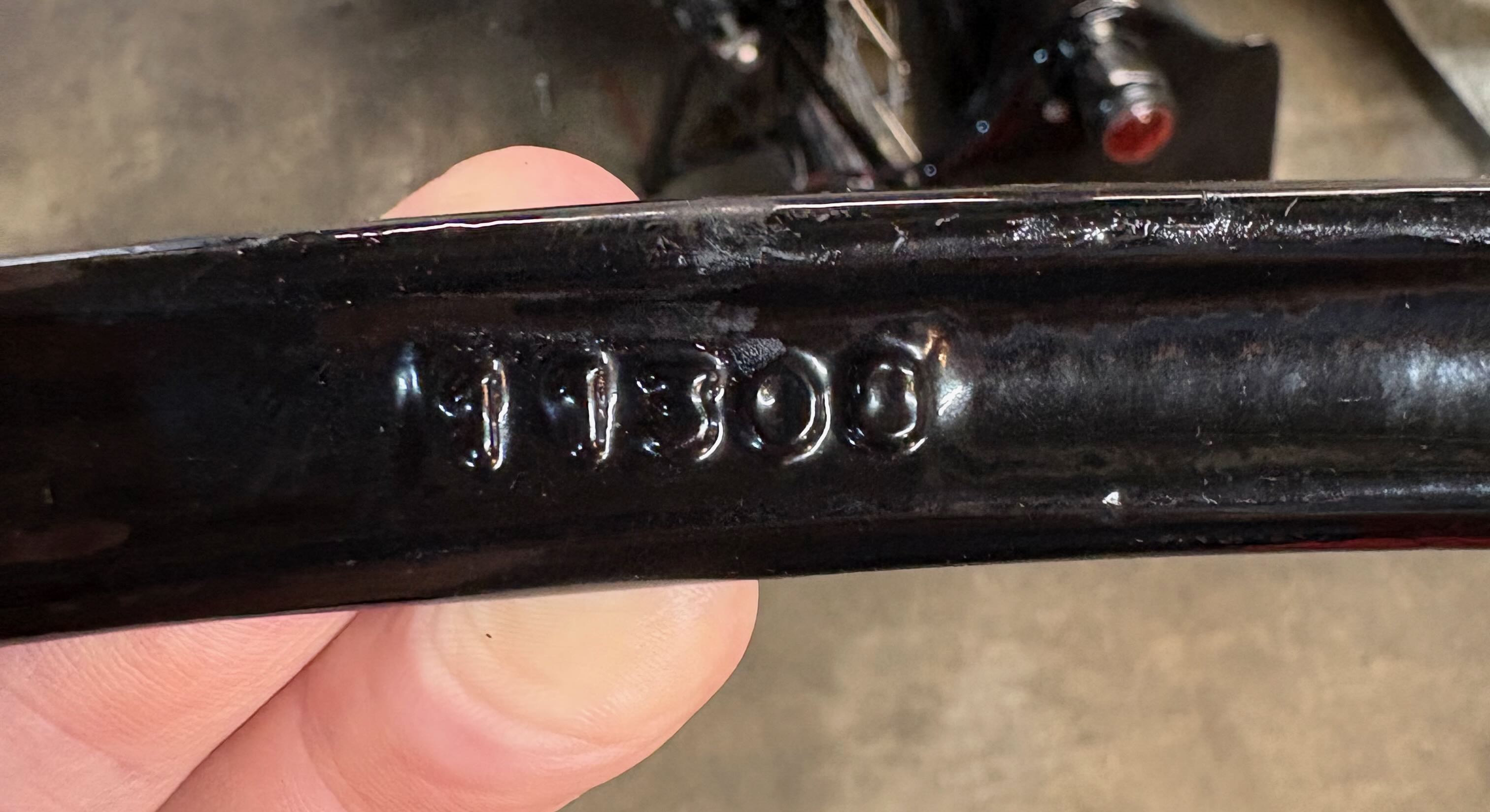

The bike is an ES2 rigid frame. I have been able to confirm the PN on my brake pedal as 11308. I don't believe this is the correct PN, I have also attached pictures of the cross hatch on the brake pedal and a end view of the brake arm. Which I also believe is wrong. The length of the foot rest arms are 5-1/2". I had to bend the brake rod to clear all the plumbing in order connect with the rear brake arm. Any and all feed back would be appreciated.

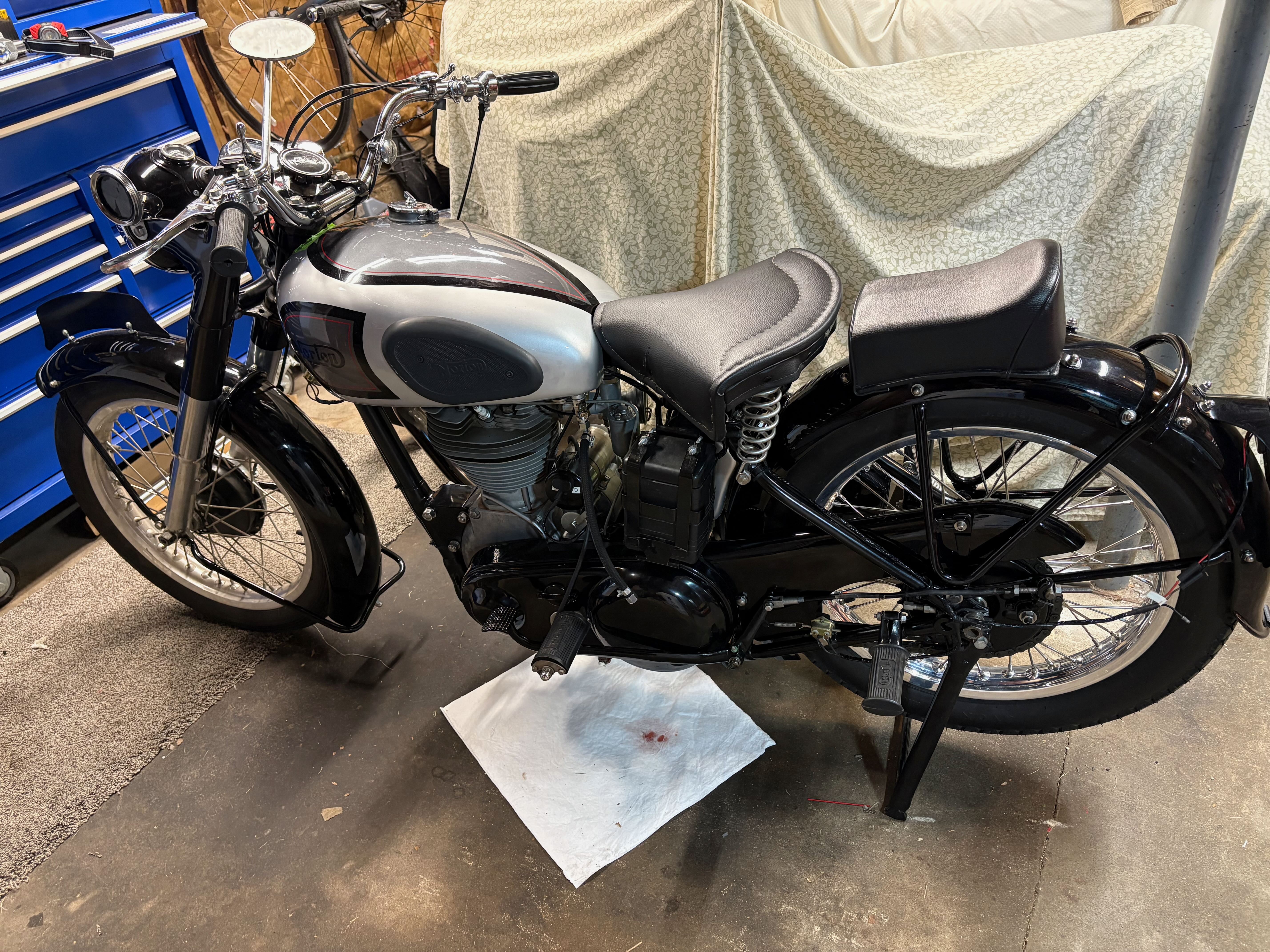

Josh, I'd really like to see a clear drive-side view of the bike so I can see what the pedal is doing. It's definitely wrong as the rod should have a clear straight run.
I have a spare WD pedal / lever here which I can photograph and measure. At one time I had a civilian lever too, and the only difference was overall length. It is long gone and I've recently switched to Windows 11 and can't find most of my photos and images any more. The search function is dysfunctional !
We'll work this one out !

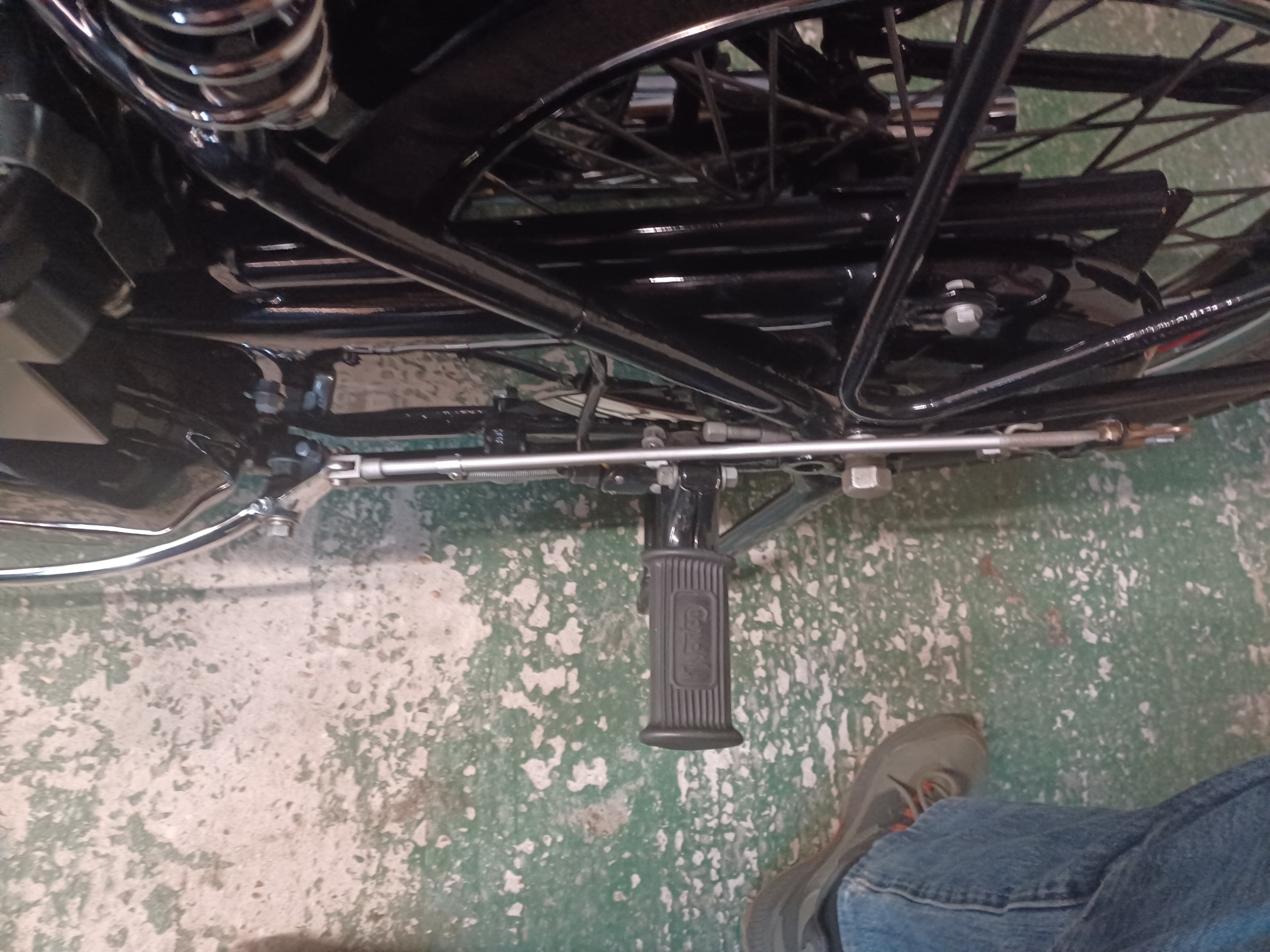

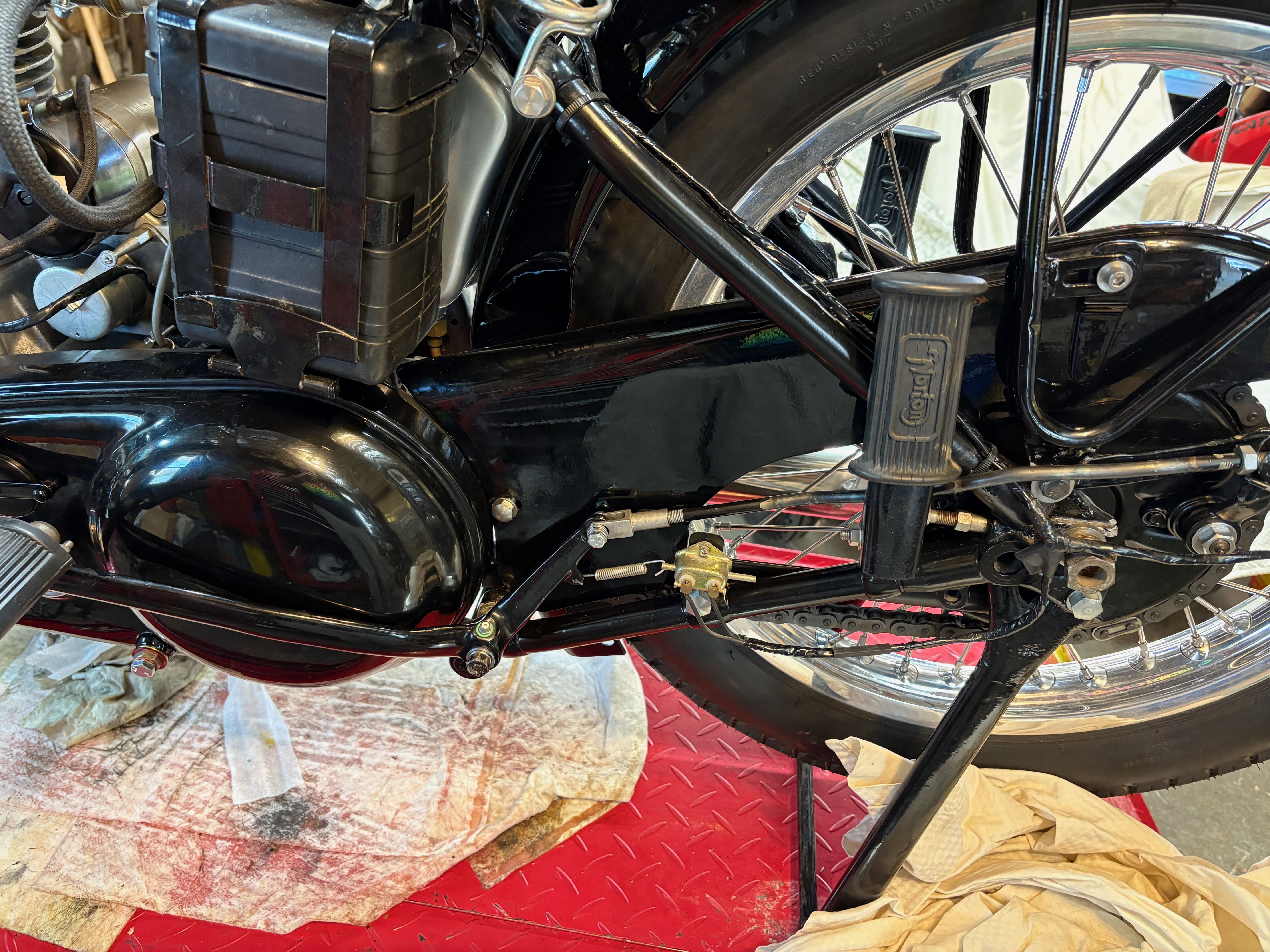

Thanks for the help. Much appreciated. Per your request, please the pictures you requested.

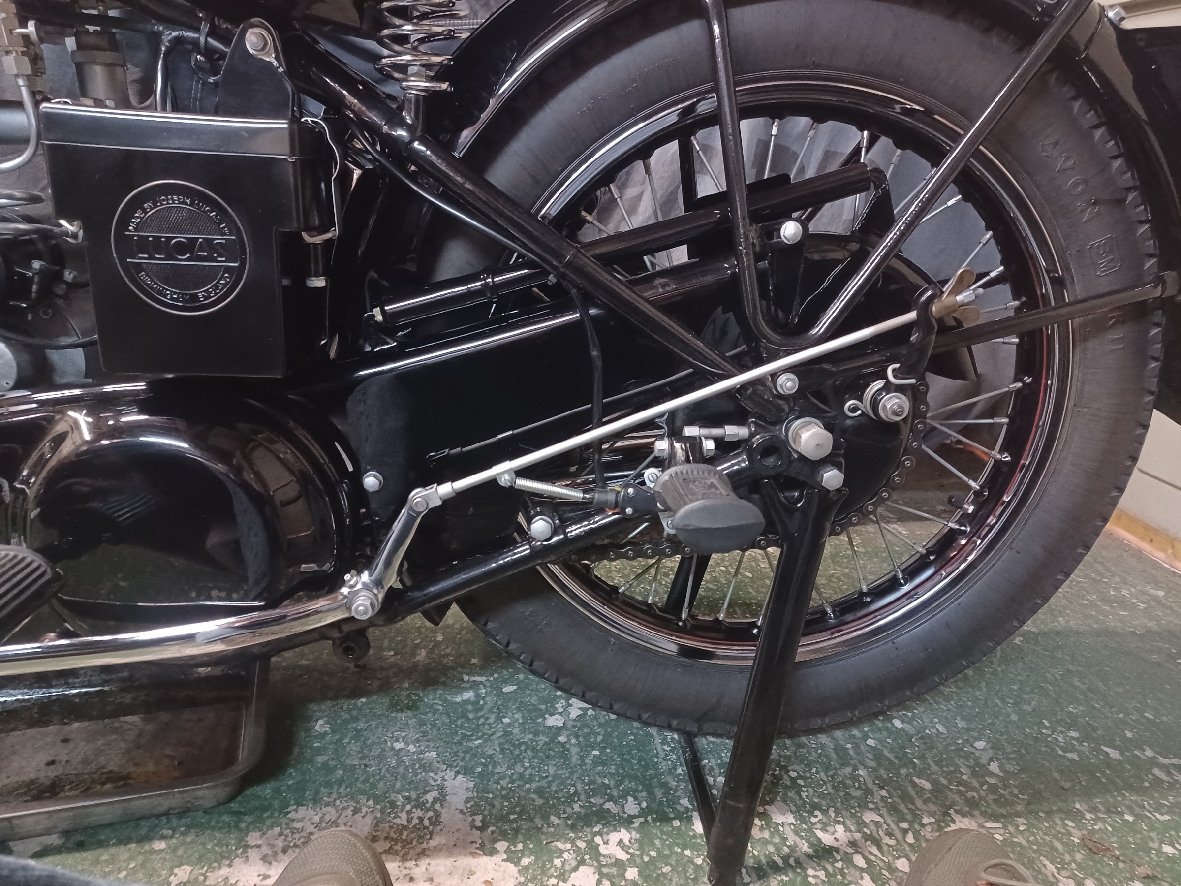

Hi

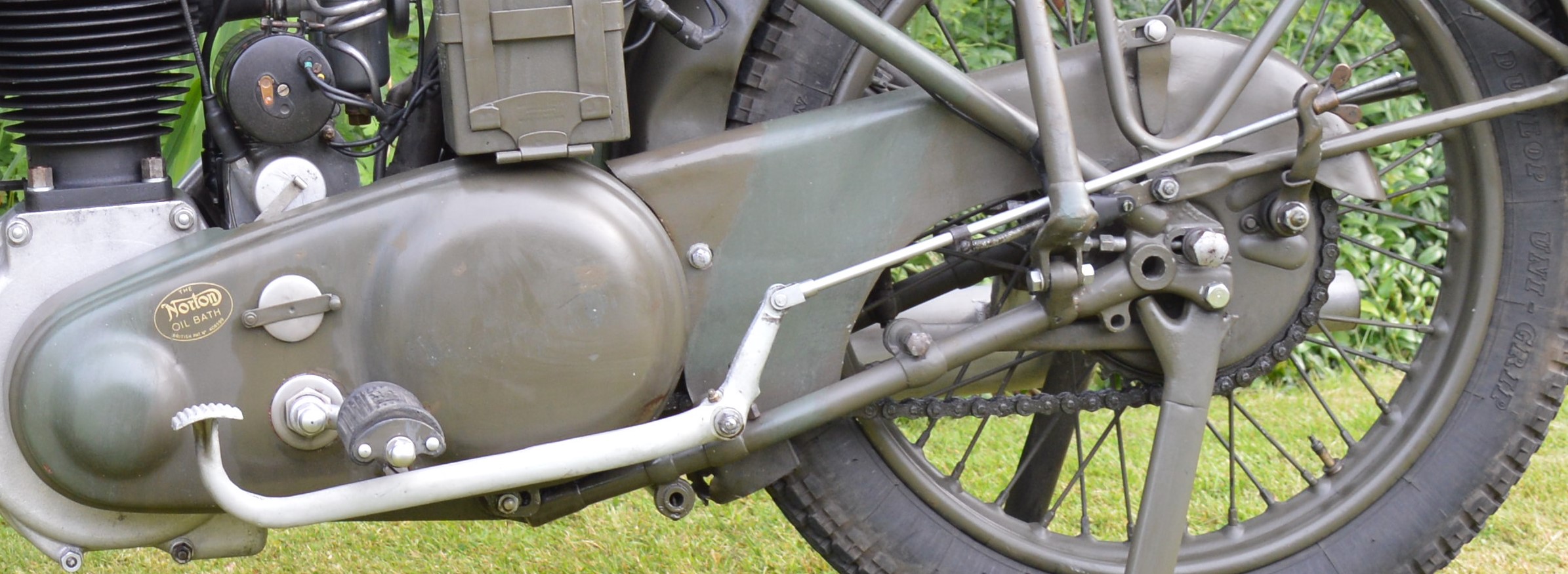

I have a pre war ES2 and the brake rod is straight. There is a cast number on the back and it looks like 6732A. It's difficult to read as it has been ground back buts it's definitely only 5 characters.
Here's a couple of pictures if it helps.
I noticed that in one of your pictures, it shows the chain split link clip fitted the wrong way round. I'm not sure if this has already been rectified, but just in case!

Thanks for the pictures. They were very helpful. I definitely have the wrong brake pedal and brake arm.
