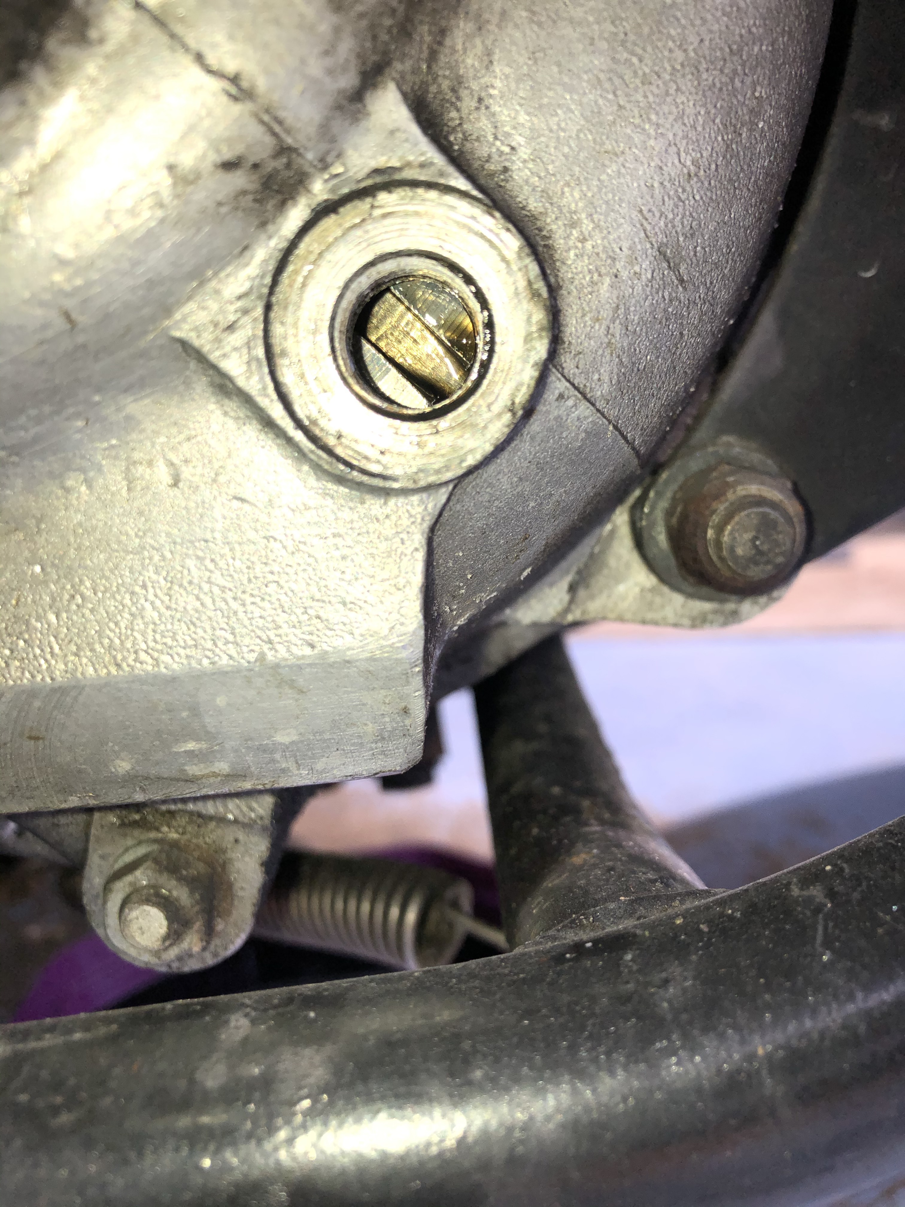

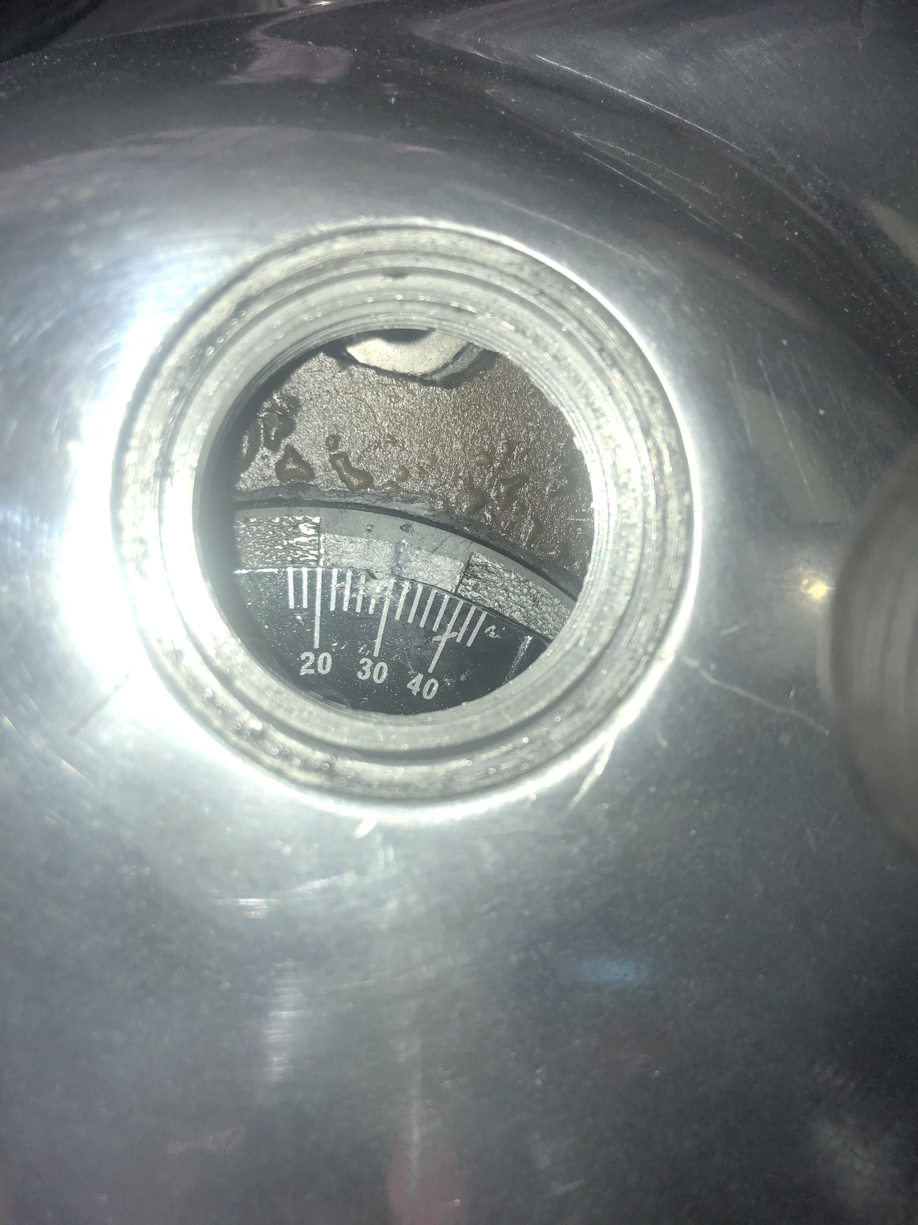

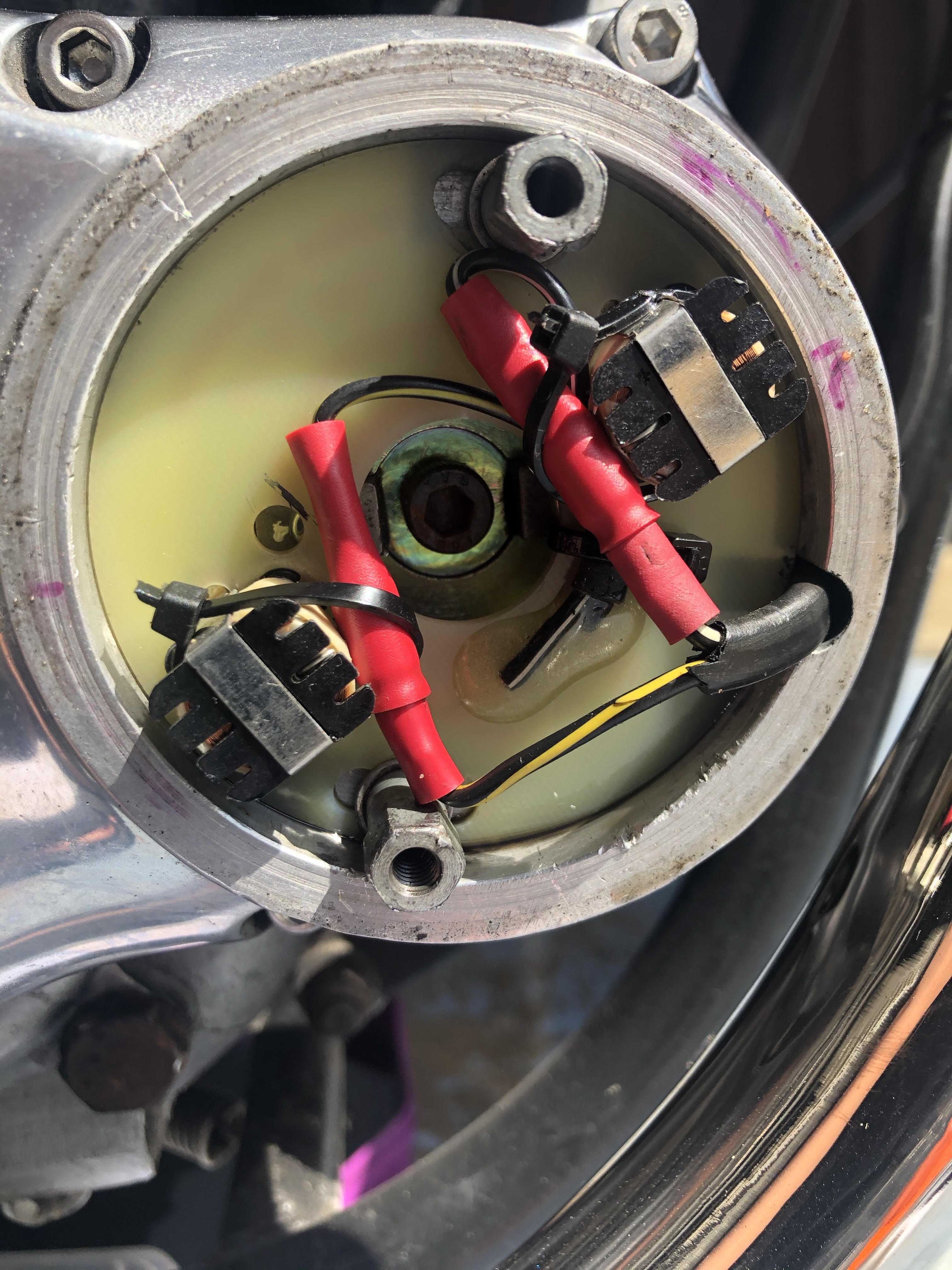

Mk3 Kicking back, here's what i have so far.
Thanks to everyone for advice. I've taken all of it at least to check ignition out. I'm attaching a couple of images (hopefully) that show key set up all taken without moving anything, so all in the same spot. It all looks pretty spot on to me but I'm no expert and i'll happily listen to advice if anyone thinks a degree or so on the settings will make a difference.
So first off the battery is putting out 13.98V, so healthy.
With the crank slot bang in the centre of the inspection hole the white dot on the boyer ignition is visible in the middle of the guide hole. At this point the timing disc reads 30 degrees or a tiny bit over.
What does everyone think, leave it as it is or should it be 'tweaked'.
One thing i noticed there was a little oil (small amount, slightly wet) in the bottom of the electronic ignition housing when i took the cap off. Anything to worry about?
That's it set statically but…
That's it set statically but it still needs to be strobed, the electric components inside the Boyer box all have a tolerance and this affects the final timing. 5000 rpm and 31 degrees is the target, if it's on the centre stand put a rubber mat under the stand or the bike will go walkies.
Get someone to sit on the…
Get someone to sit on the bike & hold it in position on the front brake while you use the strobe, they can hold the throttle at 5k & shout out as y ou approach the magic number (& stop the bike moving by holding the front brake).
The bike will walk all over the garage floor even if you have a someone on the bike whilst on the centre stand (my ex did this @ 8 months pregnant so 2 on the bike!) - much easier on the wheels.

Oil in the ignition housing
On the face of it the timing cover/camshaft seal is on its way out. Not, iirc, a big job, but be sure to acquire the conical ramp thingy (part no. 06.1359) to guide the new seal over the camshaft end, or your work will be in vain.
