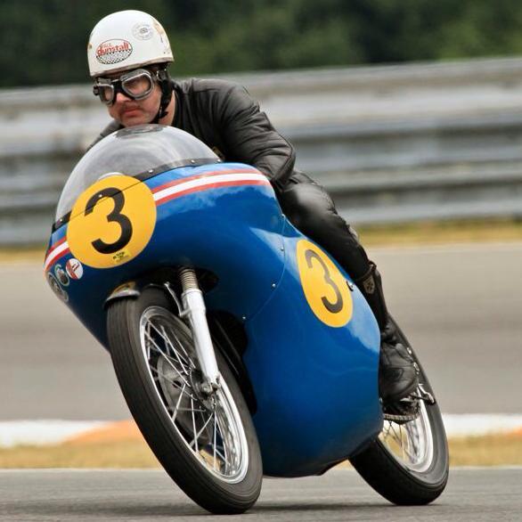

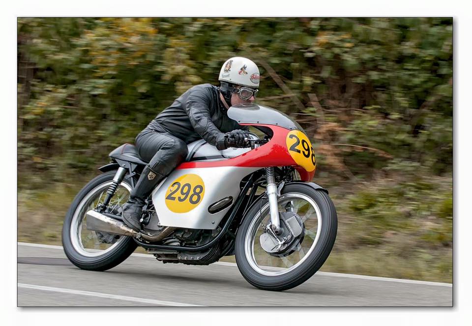

Hello Mike,every serious Racer in the sixties used a fairing on his motorcycle to achieve a higher top speed on racing circuits.
The most common fairings for english singles used in the sixties were the Peel Mountain Mile Fairing, the Kirby Fairing and the Avon Fairing.
Peel Mountain Fairing
Kirby Fairing
Avon Fairing
The racing fairings in the sixties wer made of glasfibre and usually sold unpainted in white. TheRacers painted the fairings on their own.

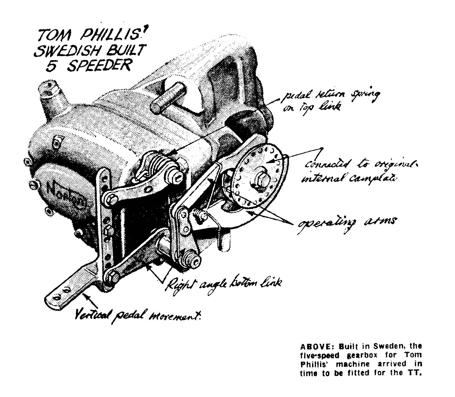

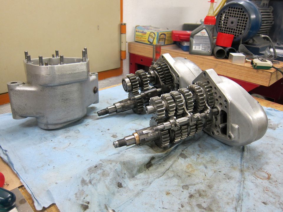

Because of the long first gear the Racers used to slip the clutch to keep their Manxes on a high rev level on cornering and the clutch was often burnt before the end of the race. So clever engineers like Michael Schafleitner from Austria who built a six speed gear cluster into the existing AMC gearbox shell and the Swedish engineer Torsten ArrgÃ?rd who built a 5-speed unit in the early 60's added more gears to the Standard 4-speed gearbox.

Schafleitner six speed Gearbox
ArrgÃ?rd five speed Gearbox

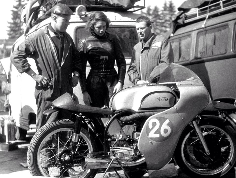

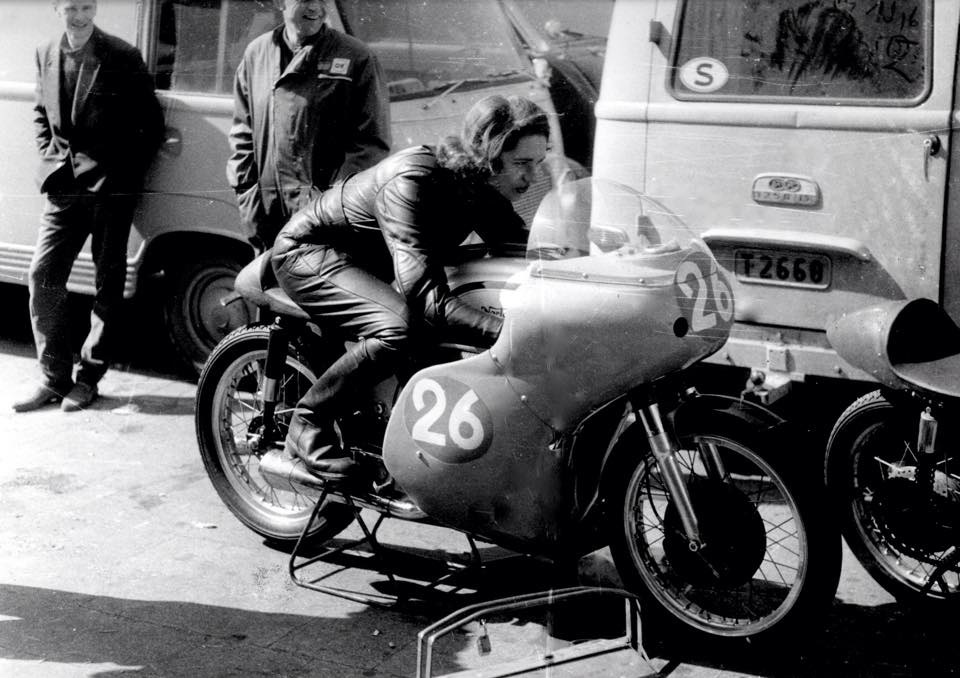

Thanks a lot Roland for your answer. My Manx was owned by Jackie Lindh who bought it from from Geoff Tanner in -61 and sold it in -63. He worked with Arrgard at that time so he built a 5-speeder out of spare parts for it. It was not built in a AMC shell as is stated in the link above. The picture above looks exactly like my gearbox. As Jack's friend Esso Gunnarssons bike was was fitted with a Jakeman fairing in -62, I can't be completely wrong if I fit my bike with one.
Esso Gunnarssons Manx with Peel Fairing

PS: Schafleitner built a six speed gear cluster into the existing AMC gearbox Shell. Torsten ArrgÃ?rd modified a Norton Laydown gearboxand built a 5-speed gearbox with an outer gearchange mechanism as in the Picture I added before.
