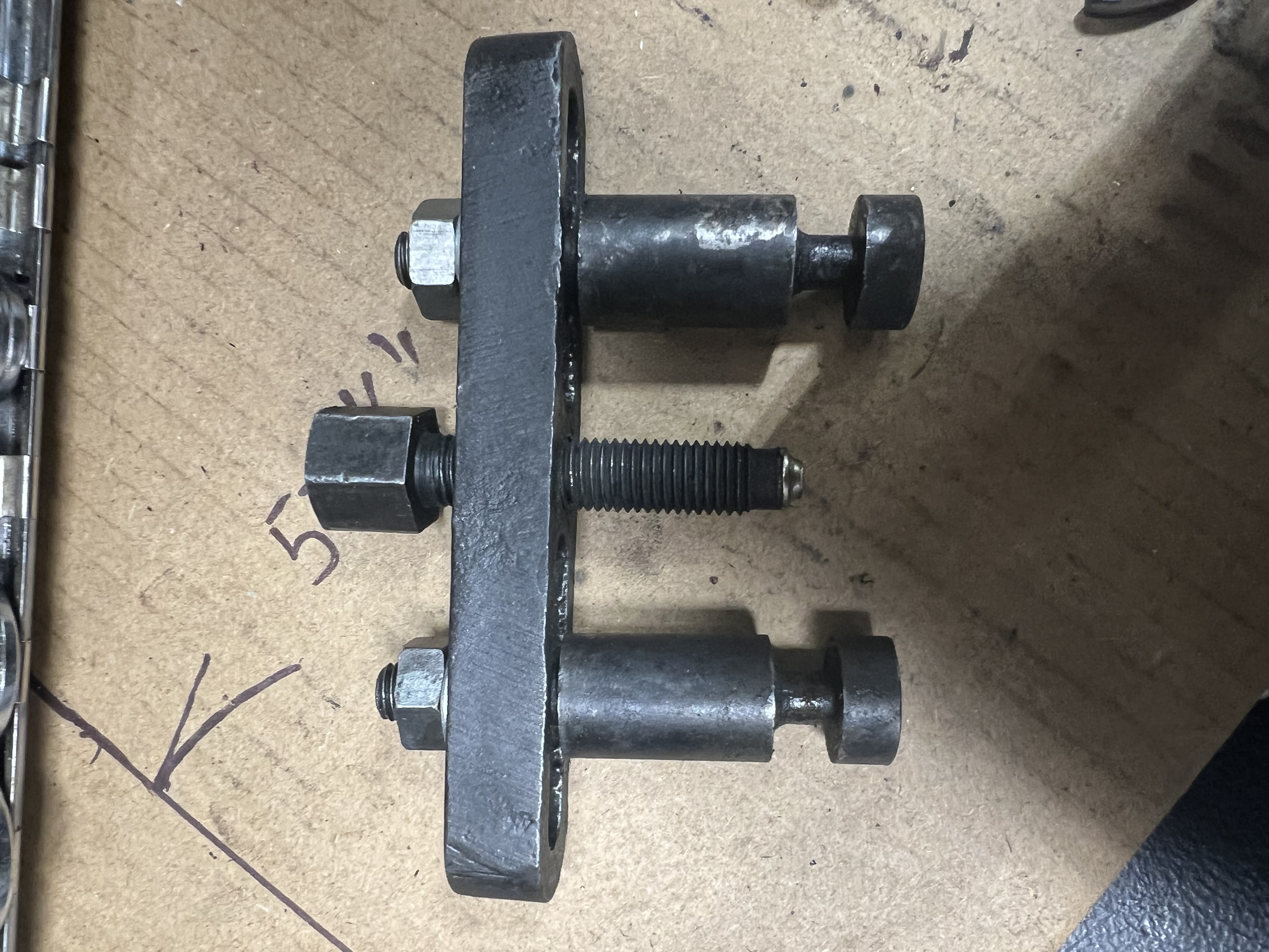

With regard to releasing the taper it is one of the most annoying jobs.   If you have a split link in the chain you got a bonus.  A standard sprocket puller tightened and whacked normally will release it.
if your chain is a continuous one  it's a little harder and a bit crude.  One of the legs of the. Sprocket puller needs to fit between the chain and the sprocket. To do this maximise the slack I. The chain and feed the leg in until  you get it to a point that is 180 degrees to any of the open teeth of the sprocket. Then fit the second leg, tighten and attempt to pull
There is a tool that was used in the factory that wa I. The shape of a J in similar proportions to a tyre lever cranked at a point that sits over the mag shaft. Then you hit the handle and it pops.  I made one but only worked when the sprocket had been removed recently.  It's all quite delicate around there you have to be careful but it needs a bit of commitment to break that fit. Why it wasnt drilled and taped I don't know.
Picture of puller I use.

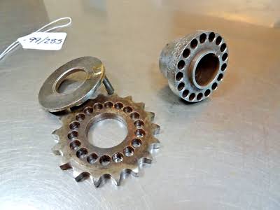

I know I'm beginning to sound like a scratched record but, if you can afford it,  now would be a good time to fit a King Pin vernier sprocket.  RGM sell them as well.
It cuts down on all the palaver you are going through now by about 90 %.

and thanks for the photo of the puller, I have a small lathe and can make one of those..
I will look at this vernier sprocket you mentioned, if it works the way I am thinking it does then that will make the job a lot easier as you said. I am thinking it's a kind of sprocket you can easily adjust?

Hi Steven
This is the sort of arrangement you could use.
Vernier
This is actually for a camshaft, but the principle is the same
I have something similar somewhere, originally from Dunstall. The important thing is a difference in the number of holes between the 2 halves, from memory in my case it is 18 and 19. Not sure of the maths, you'd have to work that out yourself!
