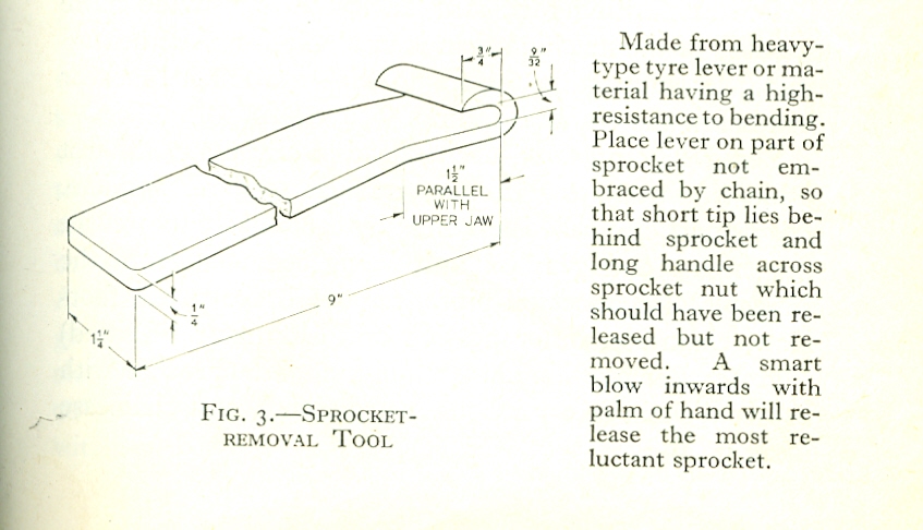

See Garratt Norton book
Hi George
A suitable tool is described in PL Garratt's Norton book, chapter 4/p67/Fig3. This is a DIY or blacksmith made tool, I don't recall seeing anything like this offered for sale. My mag chain has a split link so I remove that and use a compact 2 leg puller.

Thanks guys. I should have thought of the wooden block idea. Sounds the simplest. Kukko have a big range so not sure which one would be appropriate.The Garret one would do the job but I don't have the facilities to make it.

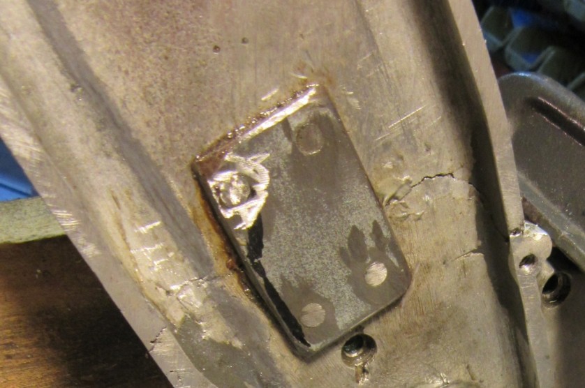

... is what happenes to timing covers when levered. This is off the 1931 Sunbeam I rebuilt some years ago - broken and repaired many years before it came to me. Spares for this model being all but unobtainable I tidied up the fishplate arrangement but it's not ideal.

A wooden block sounds very risky unless you happen to have some lignum vitae (extra hard...)
I use a two legged puller with tips ground as little as possible and, if it has to pull against the chain, so be it. Easier to replace a chain than the case.

I made the factory tool but didn’t get the tip right. I use a two leg system made up of a right angle bolt to sit under the chain and a pan head bolt to fit under the sprocket tight to the base of the teeth ( directly opposite each other). With a stiff bar between resting on the loosened central nut, a bit of equal tension on the nuts ( try it with a light setting torque wrench to keep it even) and a tap over the central nut and ping, it’s off…
