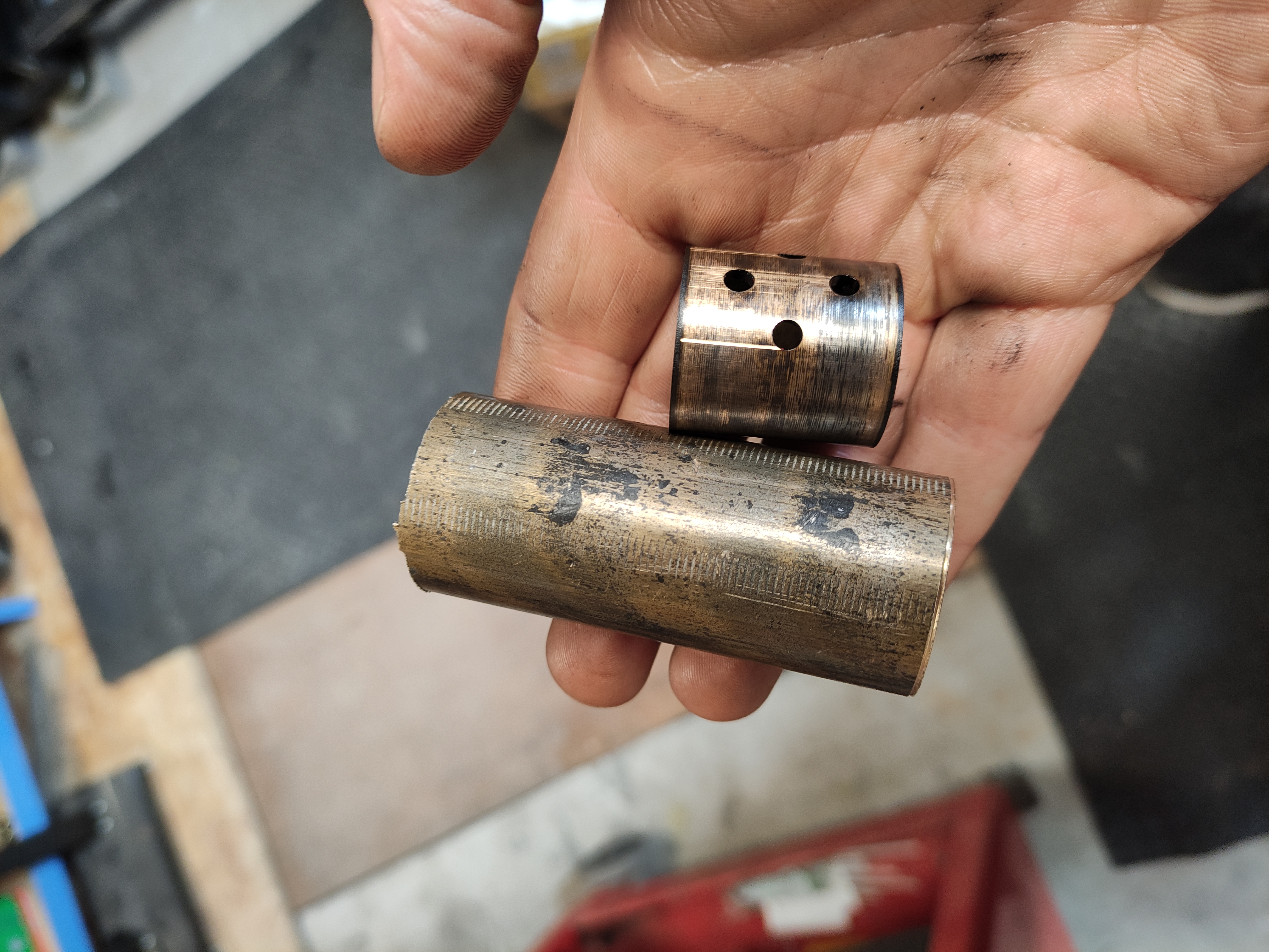

Thanks for the reply Richard. Good info there and some things to consider. Regarding the new small end, I have a calculation done for the 19.05mm gudgeon pin but I'm in the process of turning a new bush anyway for exact weight calculation.
Bronze Bush
