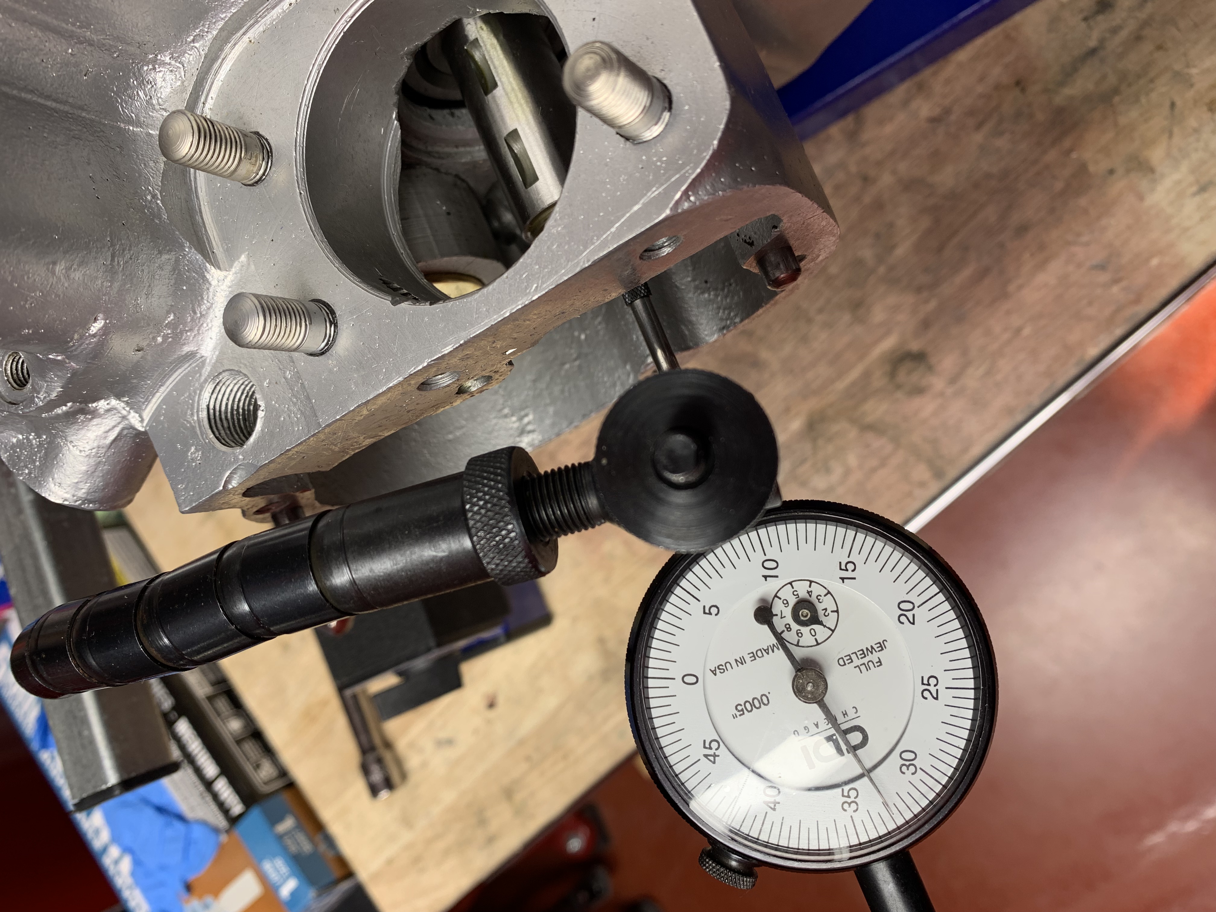

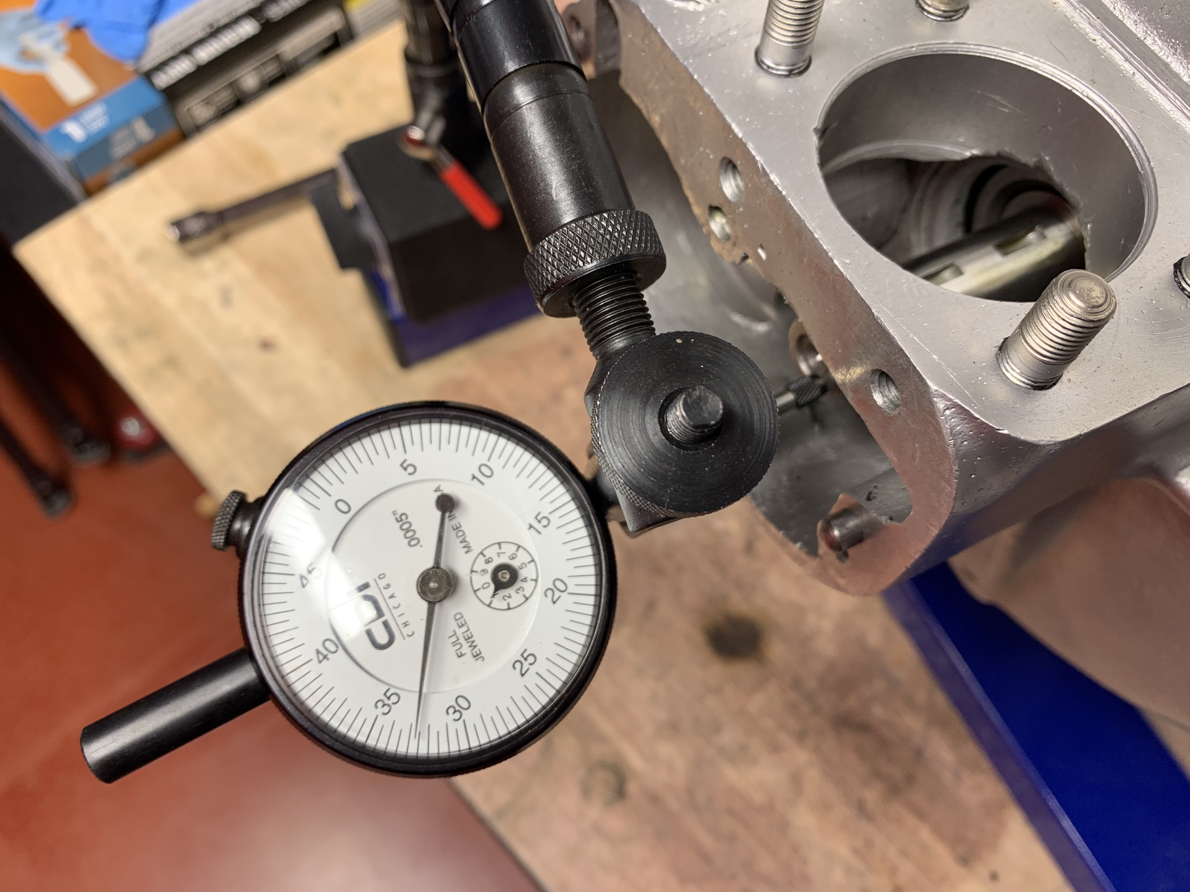

Already centralized the conrod using the method in Mitchell Barnes' book to within 0.0055 which I am good with on this non-race bike.
Trying to figure out how much end float on the drive side. After two measurements I am between 0.033 & 0.0325.
Paul Norman's blog suggests leaving a "few thou;" Mitchell Barnes' book suggests zero; Floyd Cylmer's book suggests 0.010; Paul Reed's article suggests between zero and a "few thou."
Suggestions (and rationale) welcome and wanted.
Thanks in advance for all your assistance.
I know little about setting…
My take on this issue...
When I assembled my engine, I aimed at absolute minimal end float before the timing side mainshaft nut is tightened, less than .002". My reasoning is that the only thing remaining floating once assembled is the drive side roller main bearing inner race. I made a spacer between the 2 drive side bearings to achieve this. As the cases expand when they heat up, that endfloat will increase and the mainshaft can still move in both the drive side bearings to accomodate that float. Maybe I should say it's the bearings that are floating on the mainshaft. So far, so good.
I know very little about setting up an OHC Norton. On the OHC Ducati motors I have worked on the crank is set up with zero end float to avoid loads being transferred on to the bevel drive gears or having a slack noisy cam drive. " a few thou" would be my guess. On a Norton the timing side crank is clamped in position so it is not so critical ,however should the main bearing fail in use then a small clearance would help avoid side loads being put on the cam drive or con rod.
