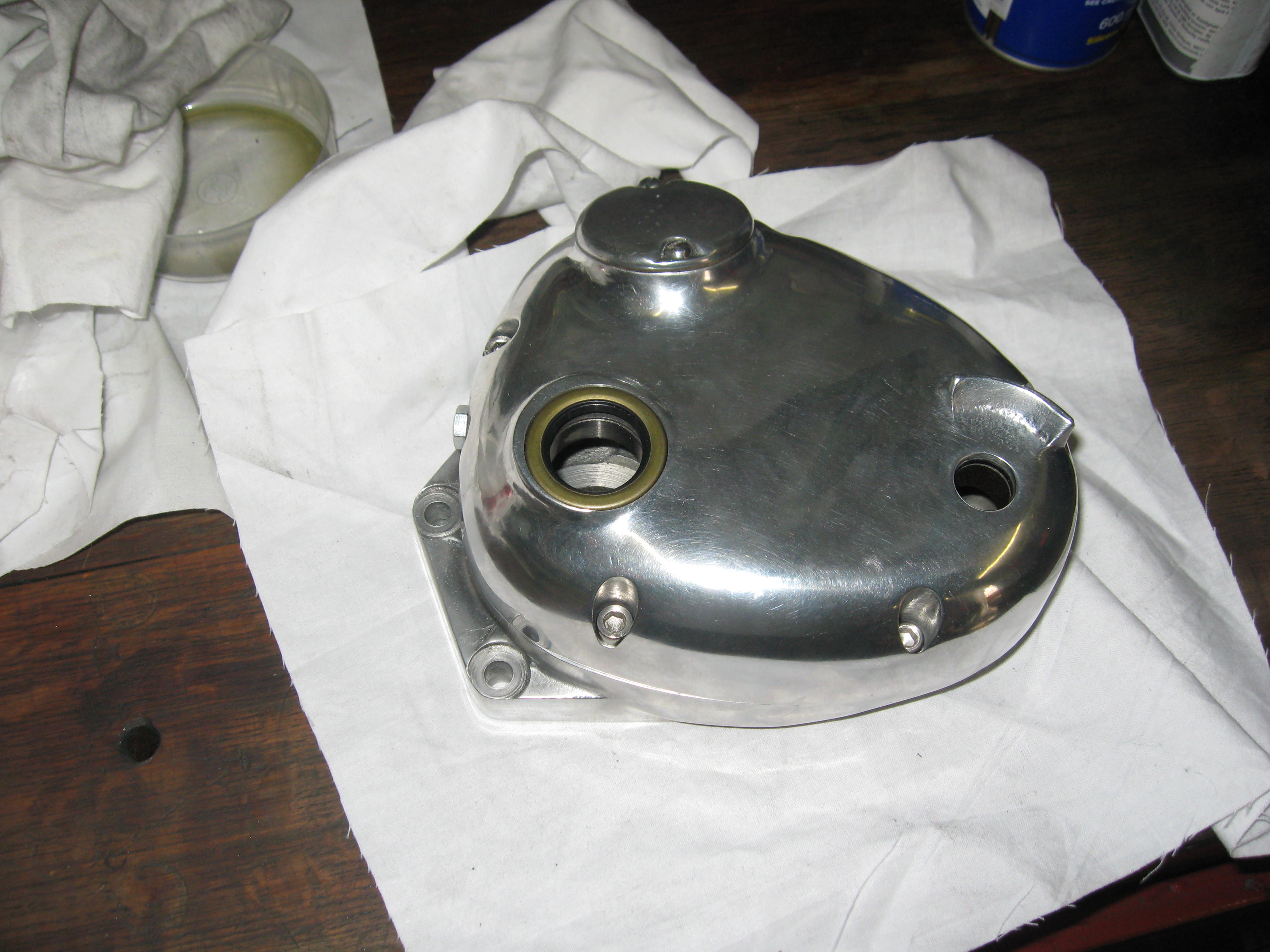

I have replaced the kick start oil seal twice now. The seal works for a few months and then it begins weeping again. Any ideas on how i can reolve this in a more permanent way ?
You may be able to machine the seal location for one of the supposedly better “x” section o rings -also polish the shaft in the area of seal contact . A lot of work/ expense so it may be easiest to do what I do - LWI . Live with it - wipe it off and monitor the oil levelin the gearbox frequently.

Great idea Christopher, can i be cheeky and ask you for the seal type and sizes ?
Use an old 'o' ring off the bottom of your pushrod tubes. It's a really tight squeeze and it'll be stiff as hell for a while but once worn in it'll be fine and should last for ages. I've used this dodge on both my ES2 & Dommi for years now and neither leak from the kickstart.

I stuck an x-ring in. Put silicone sealant into the groove behind it as the groove is quite deep. Works pretty well.  I bought a pair from one of the three big Norton suppliers but haven't needed the other. Must be cheaper in bulk...but I don't want such bulk! They do one for the gear lever also.
