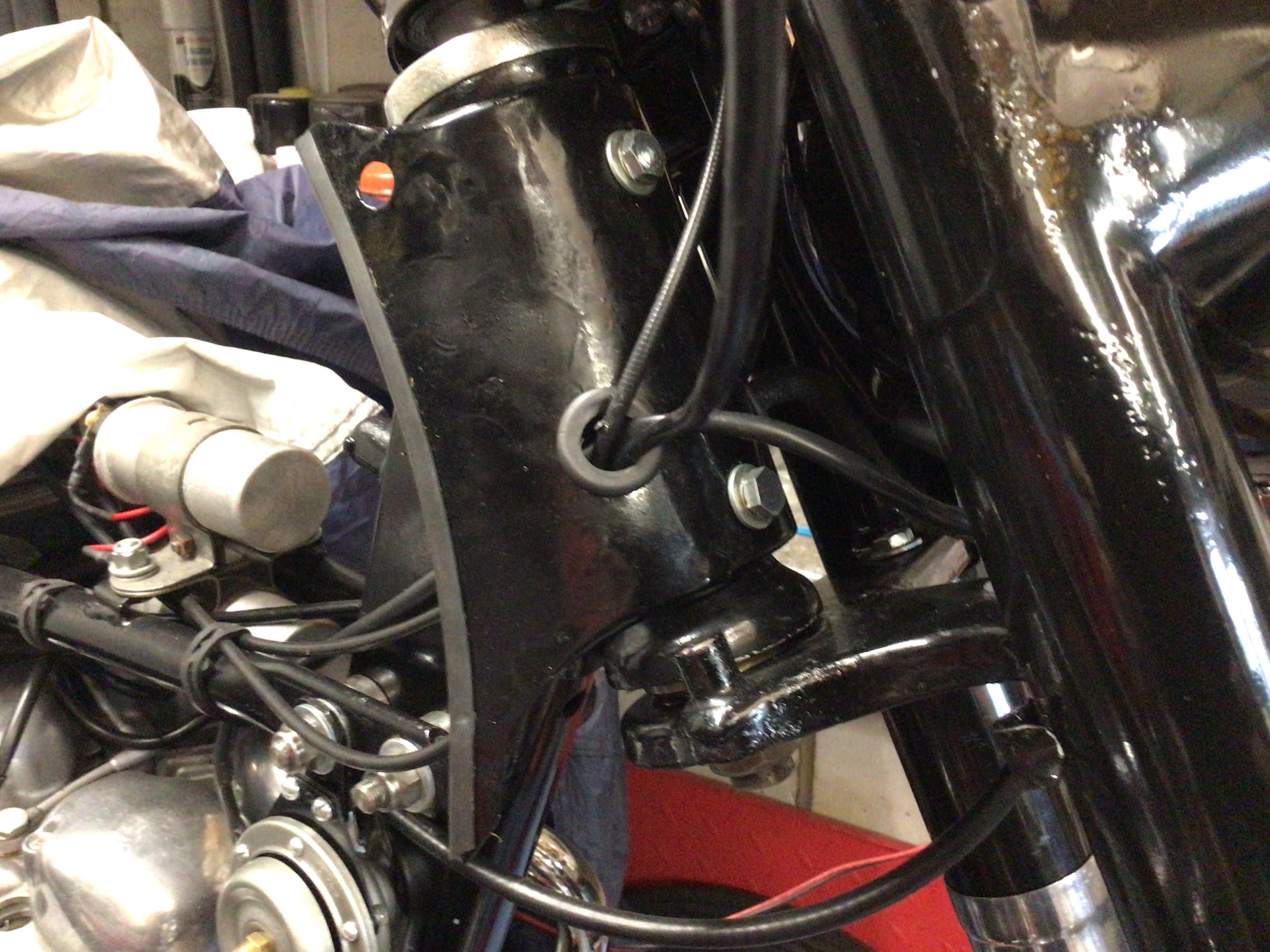

Bruce, what a stunner your bike is - shes's lovely! I magnified up you picture and it looks lihe yours have touched in the past as well

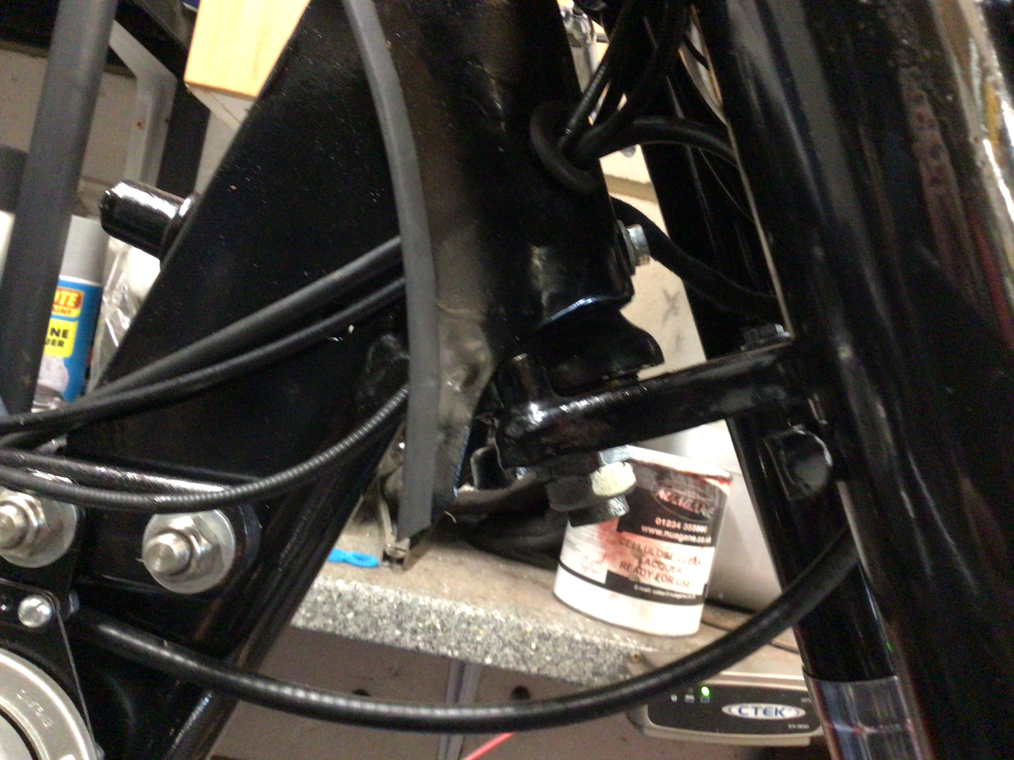

Dave E has fitted them the same way that you have, and they are on my Navi - see his pictures attached.

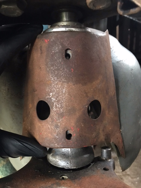

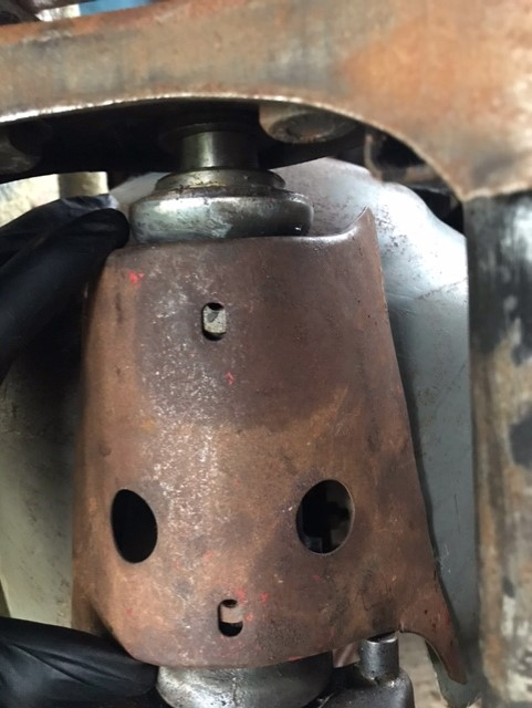

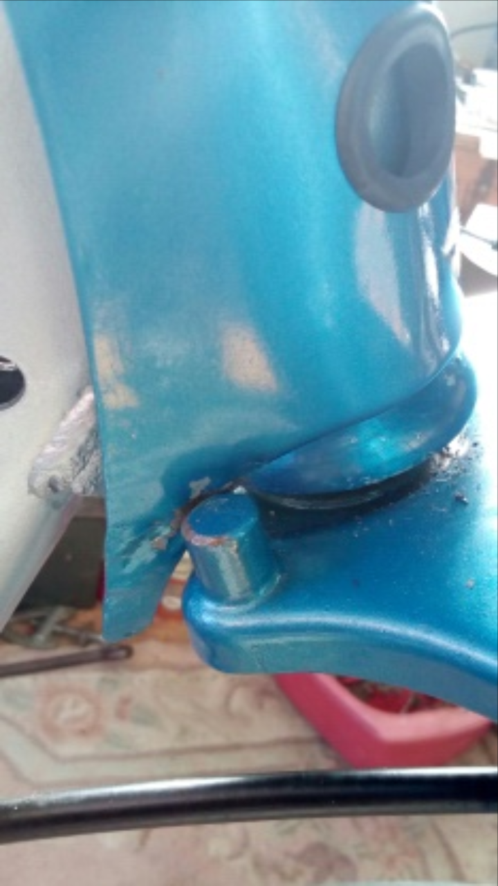

I’ll try to get some closer pics in the morning Andy - your pics look as if there’s not enough “cut-away” for the stops
Here’s some close ups if the…
Here’s some close ups if the cover - the stops are very close and think I had to elongate the cover mounting holes slightly to be able to get to this.

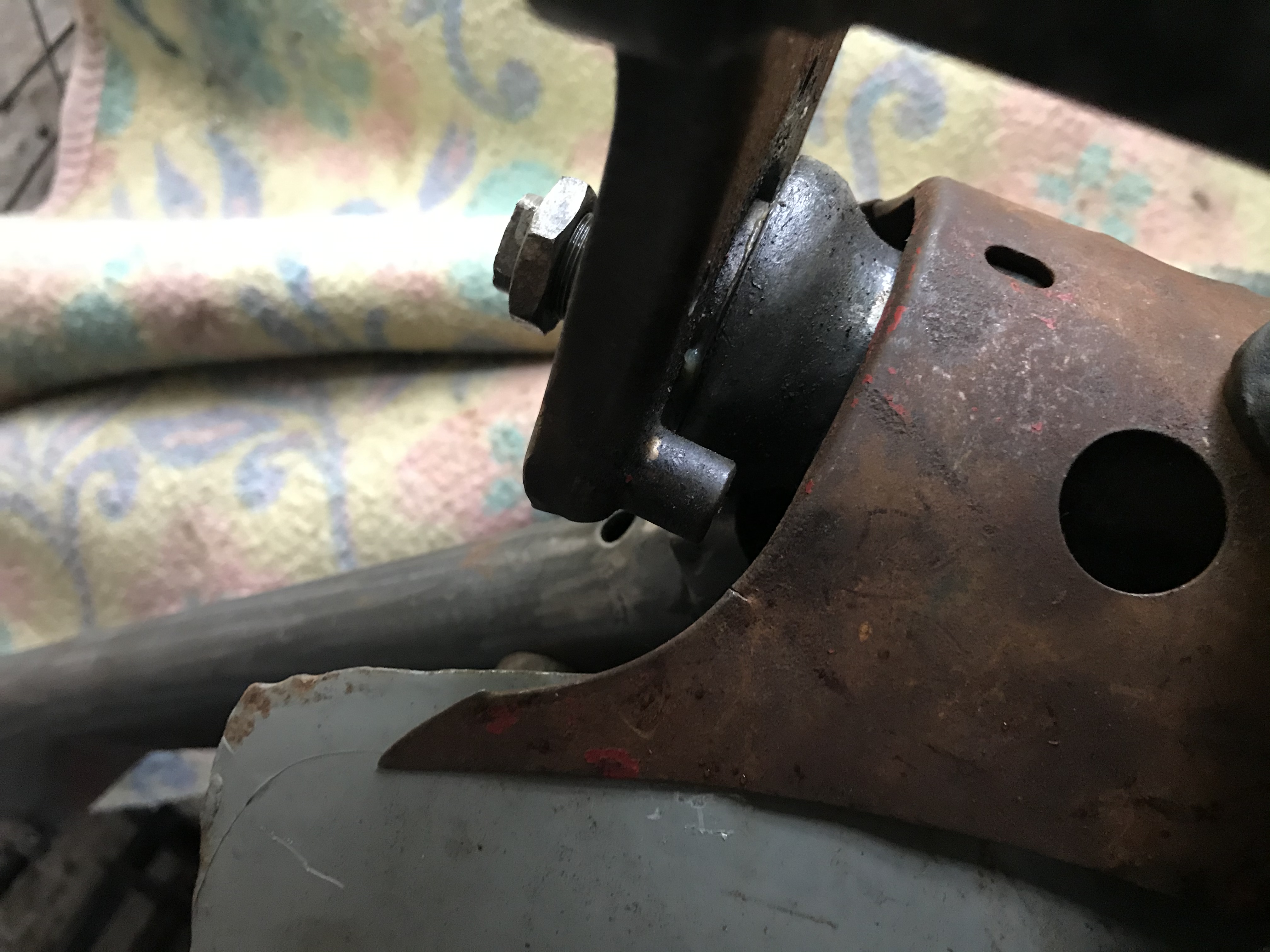

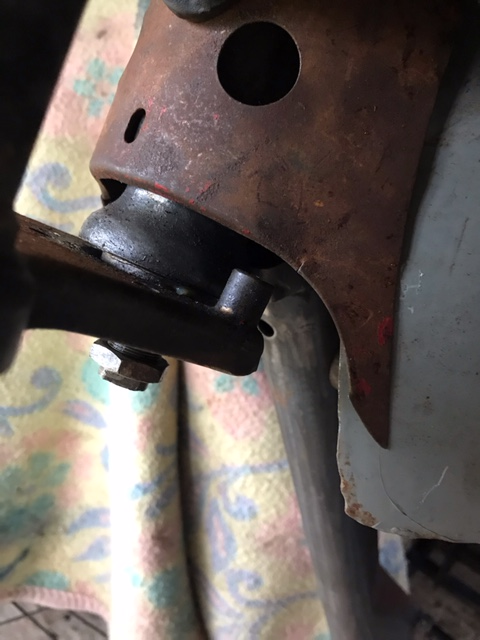

Here are some pics that Dan Field sent me.
He suspects the slots may be elongated, thus allowing the cover to drop
I’ve just been out to my…
I’ve just been out to my shed and had a look at my rolling chassis. From what I can see your cover is sitting lower than mine, probably to try to miss the headstock bearing housing, in its correct position mine looks like it needs a spacer behind the top slot. Does it look like your slots have been elongated? The top pic is me positioning the cover so it sits below the headstock and fouls the steering stops.

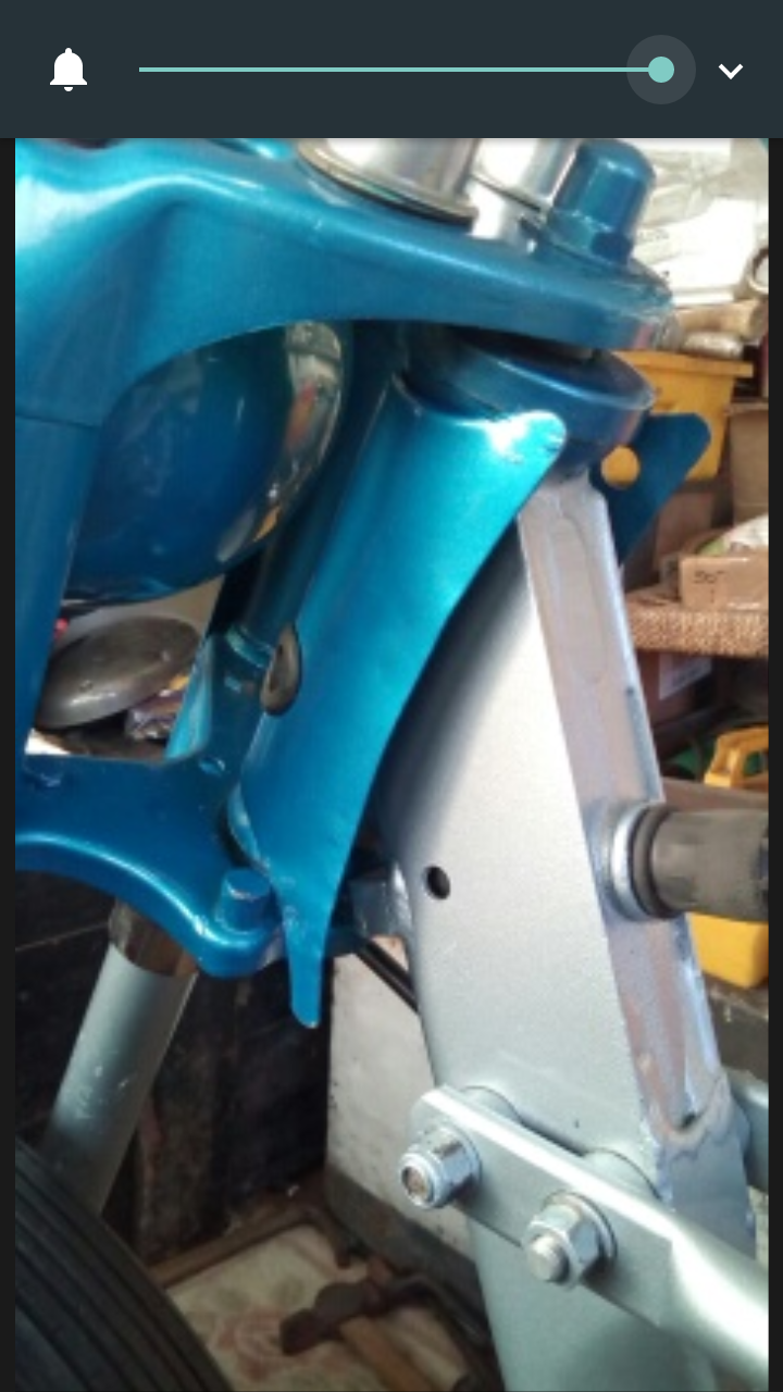

I’ve got a feeling I had to…
I’ve got a feeling I had to lengthen the slots slightly, space the cover out a bit (to clear the top bearing housing) and “spread” the lower “ears” so it conforms with the tank to get the clearance I’ve got now. My cover wasn’t in the best condition when I got it though!

Ummm, upside down maybe - here’s mine that shows it only just clears the lock stops when fitted right way round, think it fouls the covers a bit if it’s upside down though
