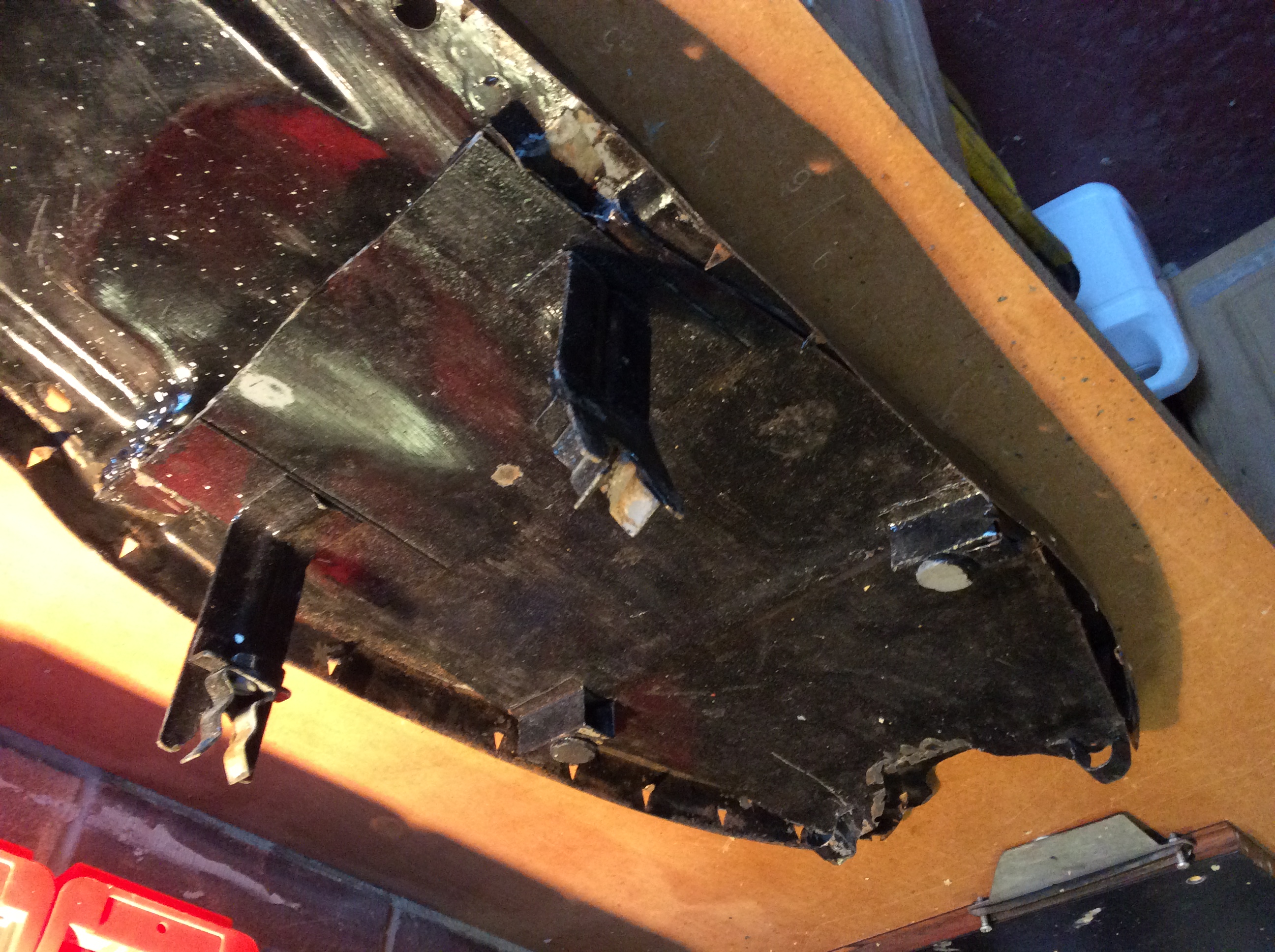

Hi everybody, another old newby here. I have a 1960 de lux, not been on road since 1988 currently being stripped ready for restoration
have got all the bits but many need replacement, main difficulty is with the seat which is wrong for the bike and in horrible condition.
anybody know where I can get a replacement?

Hi all, thanks for the inp…
Hi all, thanks for the input, still in a quandary as the current seat seems to be part jubilee delux base tack welded to a different seat base, the jubilee bit has the correct front and rear pins/clips and is about half the size of the other base to which it's welded
problem is the seat seems to sit too high on the frame leaving a gap between the bottom of the seat and the top of rear the enclosure
guess I will have to go down the route of having a new one made

Hello Allen, Yes that is d…
Hello Allen,
Yes that is definitely an one-off. The frustrating thing for you must be the fact that the original Jubilee front bit actually appears to have been in quite sound condition before it was cut up and welded to another unknown seat base.
Dan who comes on here regularly bought a new seat recently from Bantam John for his Navigator Standard and he passed a very similar comment about the seat sitting a bit high. So any mis-match would be even more noticeable on the De Luxe even if you altered the mountings to make it fit. Secondly it seems (to me) a shame to buy a new seat - all freshly powder coated and new foam & cover- to then take it apart and weld on new mountings etc, then it needs re-powder coating etc. etc.. - not cost effective.

Patrick, hi. yes, I for on…
Patrick, hi.
yes, I for one would sign up for Leighton to make a proper delux seat. I have a 59/60 early delux seat base ( well about 2/3rds) of one I will happily provide to them as a pattern so if there is others out there I tested let's get it sorted
i am in Nottingham so could get my bit of the seat to them easily
allen

I have put both seats side…
I have put both seats side by side and taken measurements. Both seats are originals and both have been recovered. Neither show any signs of major welding or alteration- definitely none at all on the De Luxe. Both fit well to the frame.
Measurements.
De Luxe Standard Overall length 600mm 600mm Max width 290 290 Width at front 220 220 Max depth 65 65 Depth at front edge 52 52
All measurements are approx. as they were taken with the covers etc still in position. The seat pressings appear to be identical - the only visual differences are the different main mountings and the dzus bracket at the back on the De Luxe.

Many thanks for taking the…
Many thanks for taking the trouble to provide such detailed information Patrick. From your findings I must now assume that the seat on my bike is a poorly-sized pattern product, rather than one intended for the other version of the bike.

Hi all, many thanks to all…
Hi all, many thanks to all who have contributed to this discussion, it's nice to know I'm not alone in the seat trouble!
Thanks Patrick for the measurements, it will help when I got around to making one ( unless of course the lovely NOC people lend a helping hand
was there really a gap on the delux to start with? My 1960 sales brochure seems to indicate it is flush fitting ( know it's a drawing but still?)
