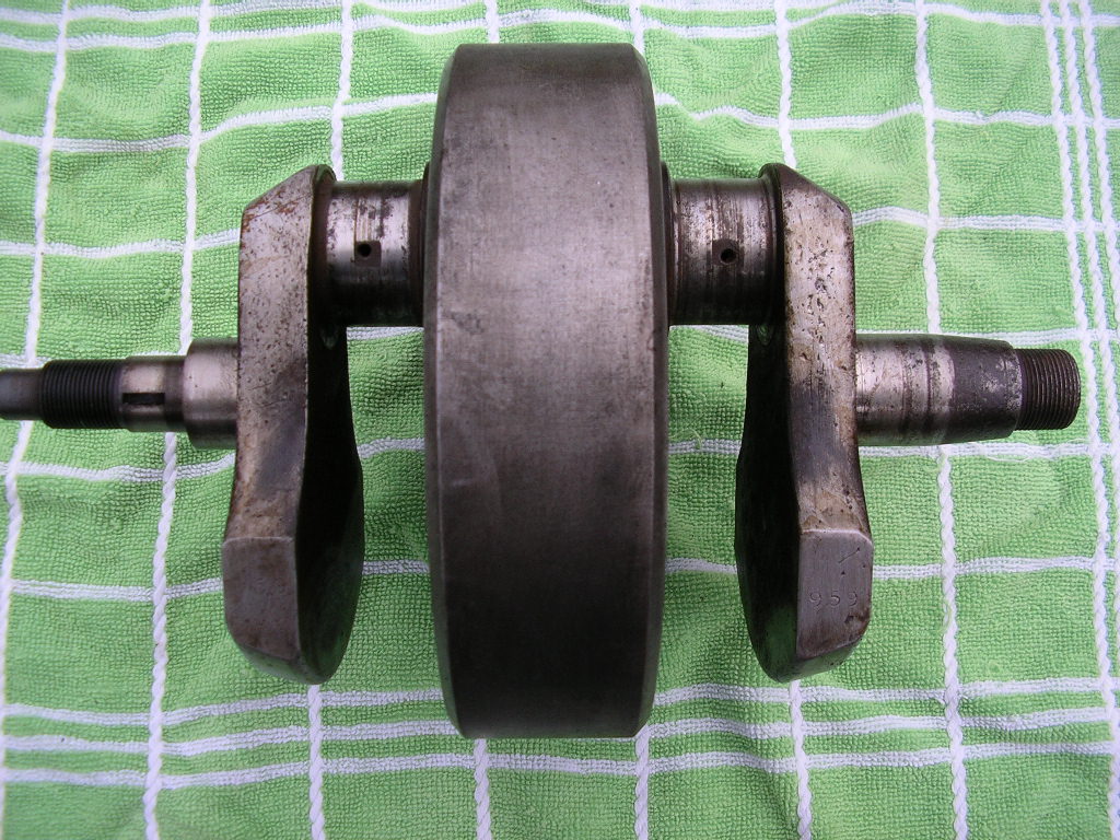

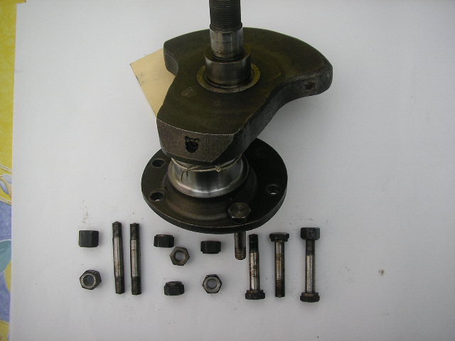

See Attachments for complete Model 7 Crankshaft and dismantled 650 version.
Generally there are 3 big chunks to these crankshafts that are held together by 4 bolts + nuts and 2 stud sets. The only one piece Norton Twin crankshafts that I have come across have been those specially made for racing or throttle happy riders..  Nourish used to be the big name for supplying these items.
