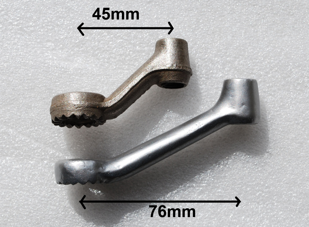

can only go so far. I just had a look in my 1950 Parts List. It shows V95 for roadsters, V96 for International, and V89 for Manx. The Manx one appears to be about the same length as Inter (but lighter), which are noticeable longer than the road-bike ones. These arms are simple straight items, so could not be used on the right side of a Dominator exactly as is.
See photo and link....
...Domi above, Inter longer. Available from RGM:
https://www.rgmnorton.co.uk/buy/drivers-serrated-footrest-hanger-early_3816.htm
