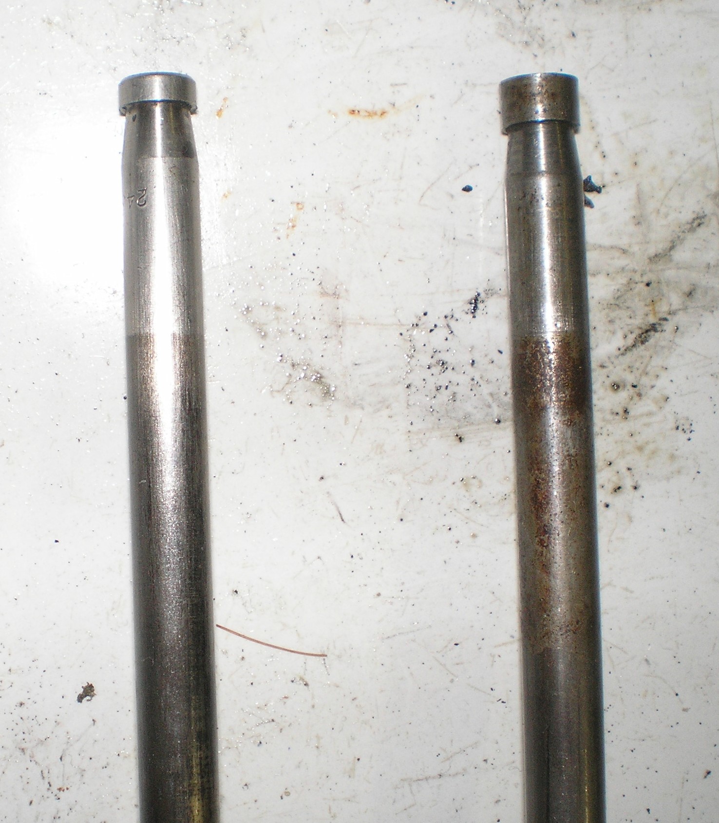

The valves were changed for the 1938 enclosed tappet engines and they differ in at least two ways. Unfortunately, they still physically fit.
The collet grooves were moved closer to the tip. I'm not sure if this was linked to the new valve lifter mechanism or if it was to reduce spring pressures.
More importantly, there was a materials change to austenitic steel and it seems to be the case that these are not considered, if unplated, to be suitable for use in un-lubricated cast iron guides which of course the earlier / WD pattern engine has.
Whilst the same valves were used for in. and ex. on both patterns of engines, they both had differing guides listed which no current supplier seems to do. A visual examination of WD stock doesn't indicate any difference. I suspect that as they were pre-sized (no reaming is mentioned) there was perhaps more clearance on the exhaust guides.
