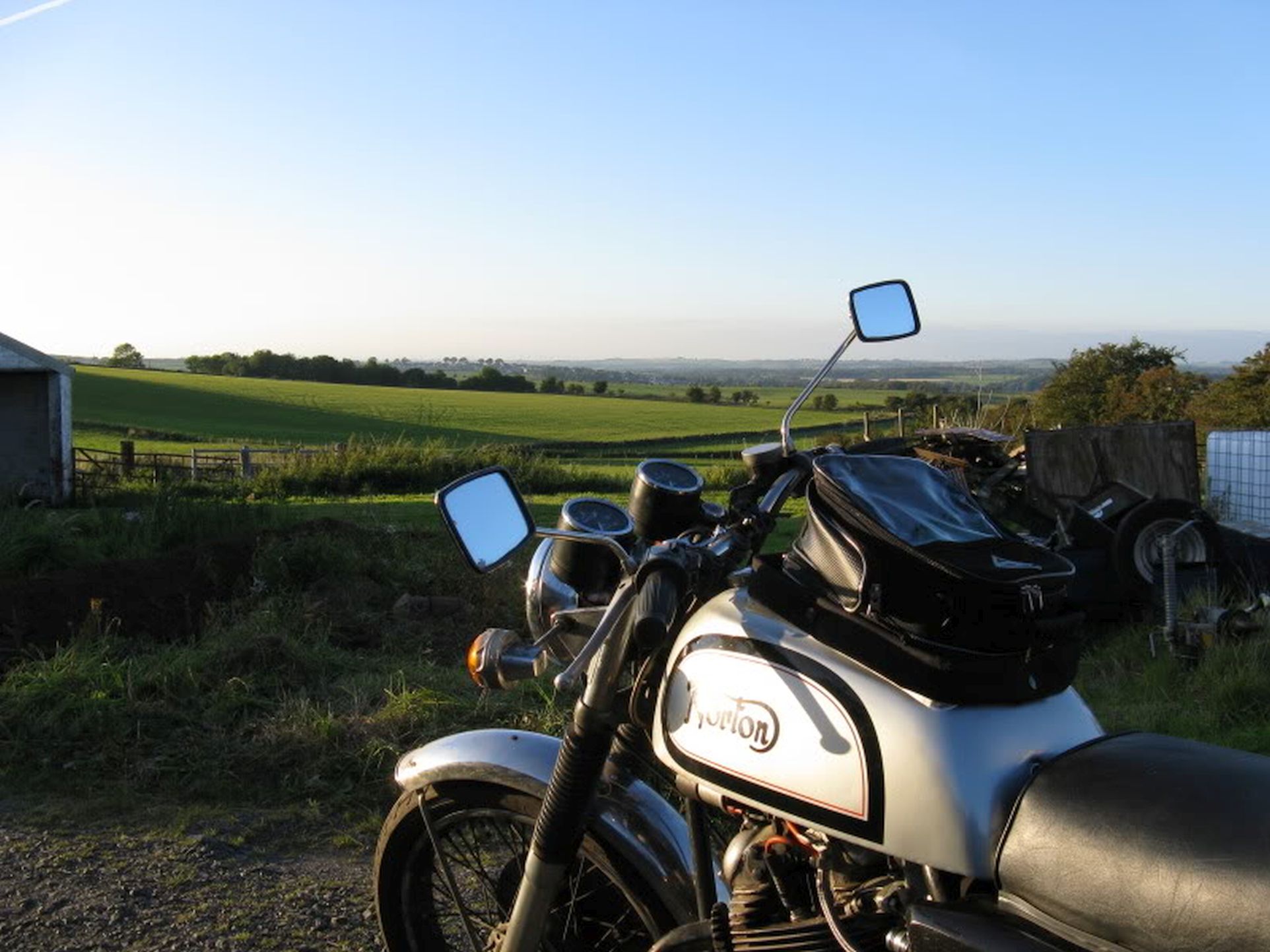

I too like the traditional…
I too like the traditional Norton livery so painted my own Commando Interstate a bit like a Manx as in the photo. Not standard of course but who cares?

That looks very nice - act…
That looks very nice - actually I like the front mudguard! Looks a bit like the one on Sammy Miller's Ariel GOV132.
My first Commando was a Roadster like that but the small tank was a pain for touring. I fitted Roadster side panels to my Interstate as they're much tidier in my opinion.
