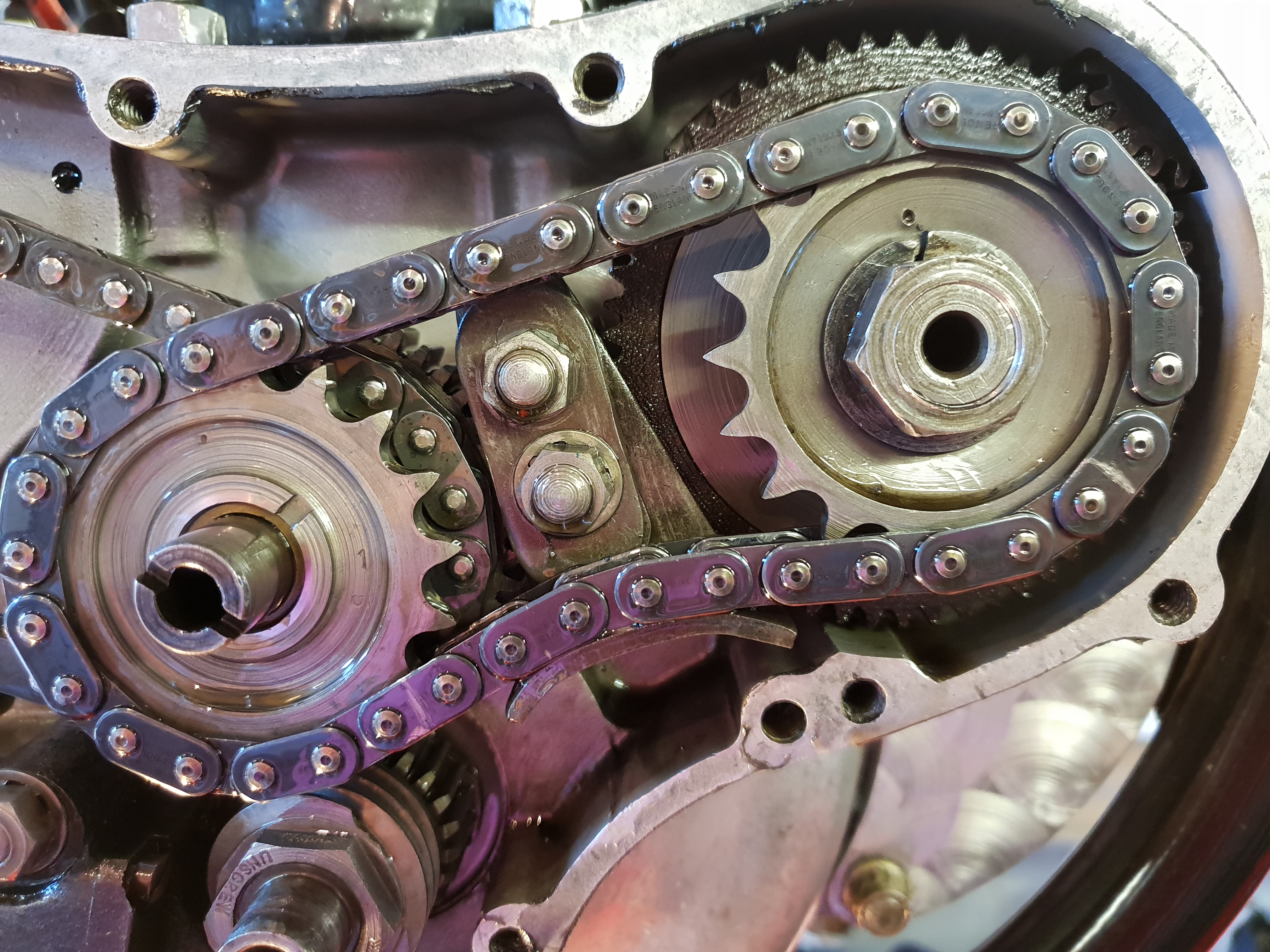

The cam and chain were left untouched and as the bike ran fine when owned by my Father prior to the restoration.
The cam followers and lifters were removed for the rebore but thatâs it.
I have checked the links between the marks on the cam chain and I believe it to be correct at 10 links between the marks on the sprockets.
