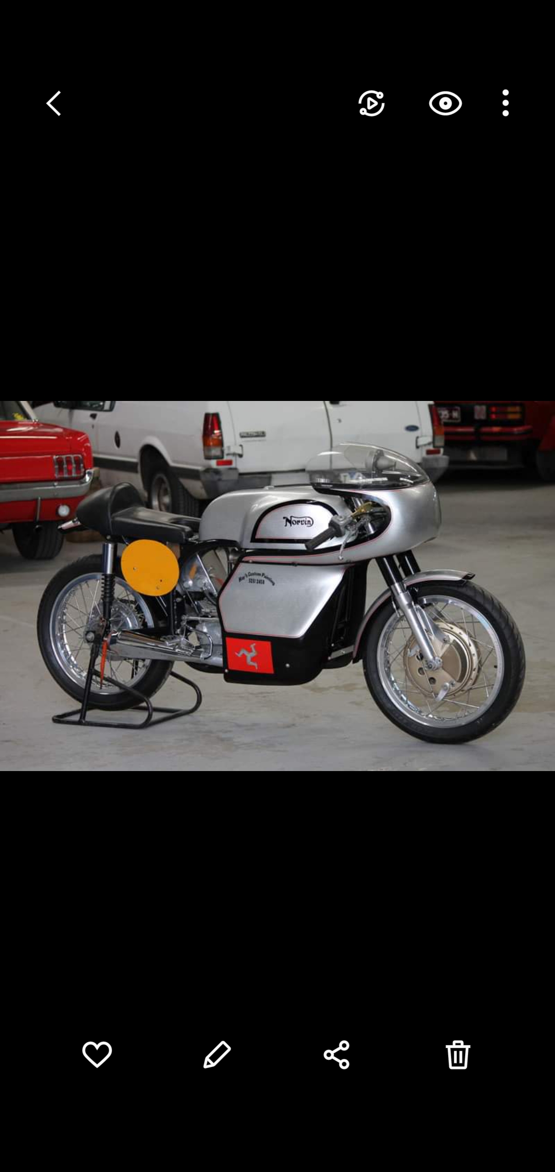

Im looking for a fairing, ive seen on a picture. And i would like to know if somebody know where i can find exactly the one on the photo..;-)

Thanks for your answer. Yes, i forgot to tell that i will use it on the street, so i prefer a fairing with headlamp cutout. Oh and by the way, please ecxuse me for my english..haha.
And thanks for the infos. Im really looking for the one on the photo, i will try to find out, maybe i will be succesfull... we will see.

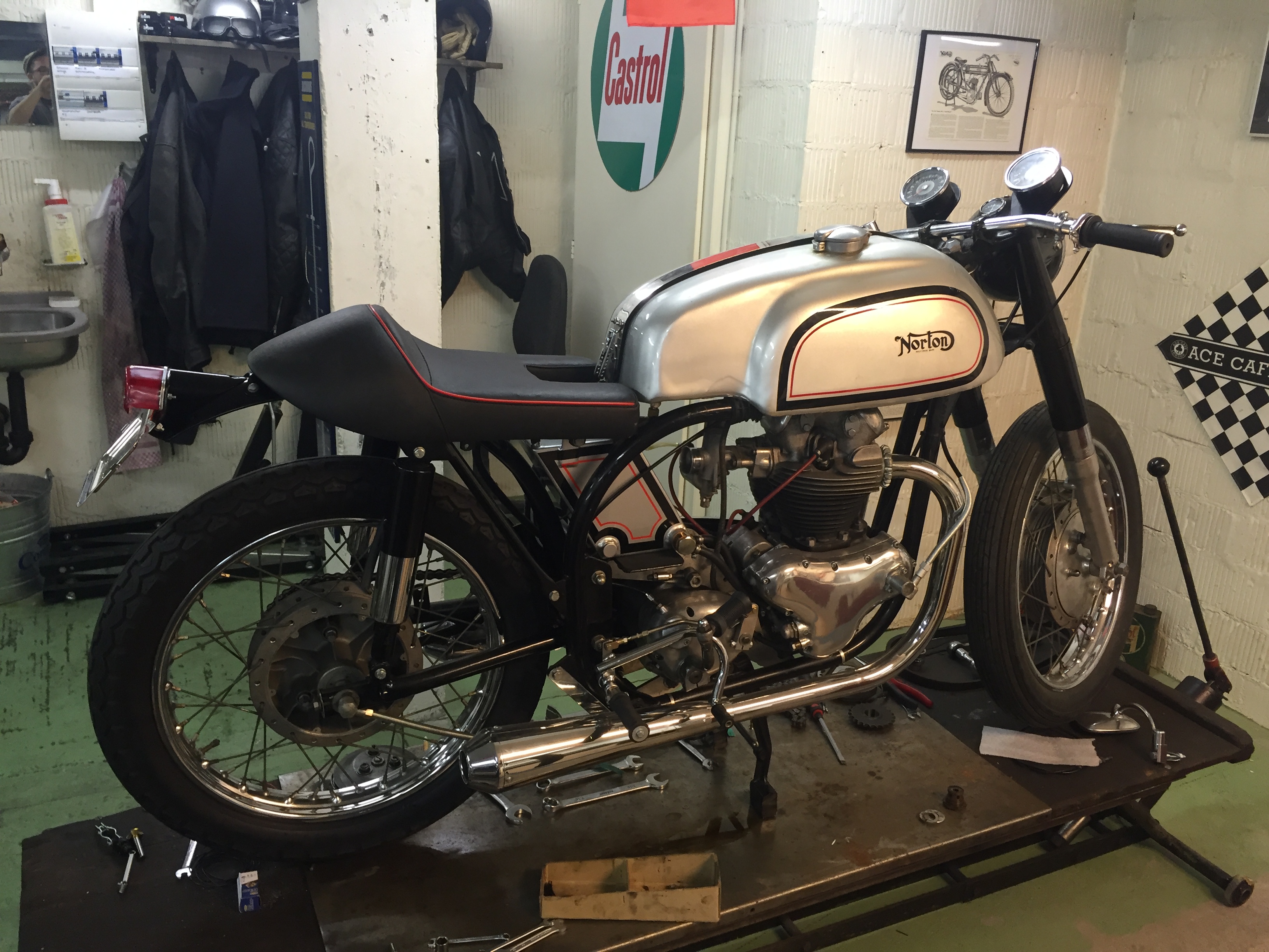

Yes i am using the original first wideline (thats what i have read) frame, with bolted backframe, heres a picture:
And i took a look tga.co.uk they really have a nice fairing. When i cant find the one on the photo, i could imagine to buy one like this.
Nice build
I guess you've built it from parts from different bikes and years. Nothing wrong with that. Some comments though. Obviously you could not have clipons since there is no indentions in the tank. Wiill give a comfortable ride but more difficult to tuck in really low. The rearmost tank rubber seems to be in the right place for the tank not to crack again. The choice of the late oil tank is good as the elephant foot one is prone to cracking. It also gives better room for the carburettor. Happened on my Honda racer that after a practice a fellow racer came and told me where the end cone of the silencer has fallen off. He had to duck, not to get hit. This kind of silencers needs needs a couple of pop rivets added. My main concern though is the exhaust pipes. I believe that swept back pipes will be needed if fitting a fairing.
Edit: By the way, in my experience from twin and single Nortons, they seems to go better with silencers ending at least below the rear axle. On the Manx 2 inches before.

My think it looks like an Avon Speedflow 3-piece fairing, which is available for singles and twins. As you intend to use a Dominator engine, I think that any other Manx ( or in the picture probably a Comet engine ) fairing might not be wide enough for a twin. You've not mentioned if you intend it for road or for race. For road I'd recommend one with headlamp cutout, For racing, where a bellypan is required, you could either have a separate bellypan or a fairing with oil containment. Personally, I found it easier to take off and fit a fairing without bellypan. Making tending to the bike easier. A bellypan for a featherbed is easily obtainable and only need 6 tyraps to fasten. If racing, I'd recommend buying two screens. Usually, the fairing is fairly easy to mend, not so the screen.
