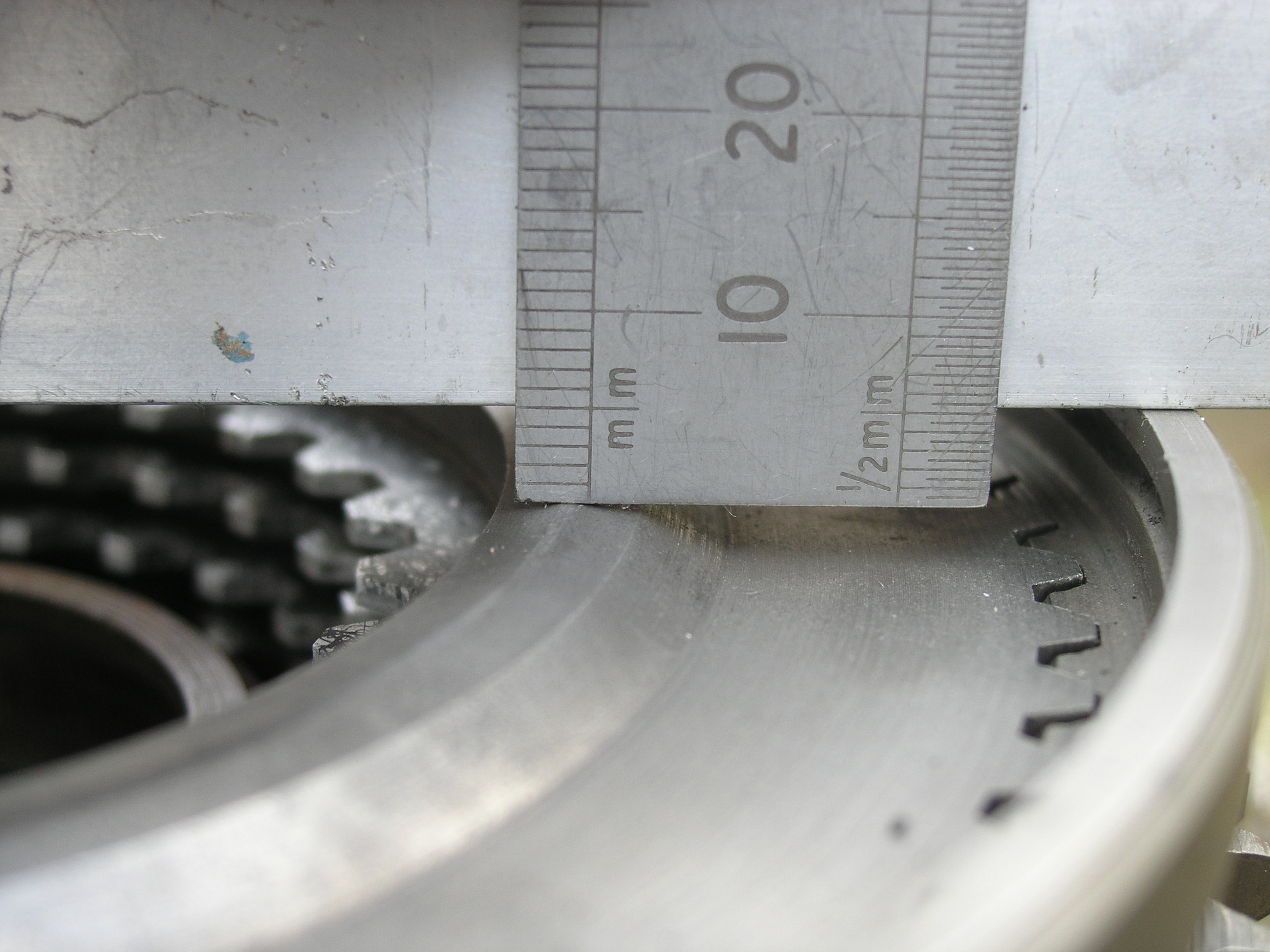

I followed what Dynodave p…
I followed what Dynodave points out here.With Barnett plates, mine (Mk2 850) is now a true one-finger clutch, with no slipping.Boils down to having the top of the ridge of the (original) pressure plate 5 mm below the edge of the clutch housing. It is then JUST possible to install the spring of the diaphragm.Attached a picture of the stack height.
Attachments bijna_5mm_onder_huis.JPG- Log in to post comments
