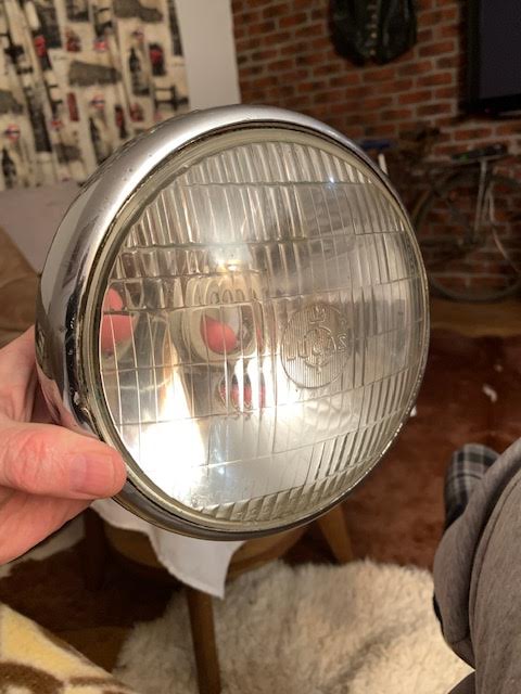

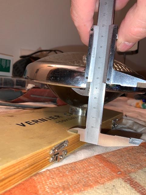

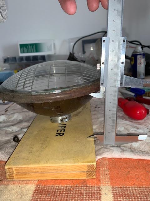

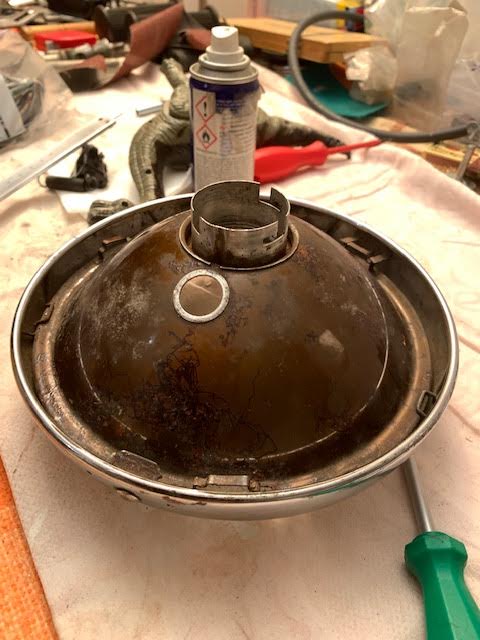

I would like to ask you about help and advice regarding ordering some part for my Norton ES2. I have been trying to order headlamp 7” longer for my Norton ES2 500 year 1961.Original or any replacement Lukas series 700 No 553753. Unfortunetaly I ordered twice from two different sellers but neither of them does not fit. Diameter is fine but length is not.Headlamp is too long and hit to speedometer cable.
The original which I have on my motorbike has a length 62mm.Those which were sent to me has a length 74mm.I would like to ask you about advice where Can I get this kind of headlamp with right length 62mm which will fit!?

Thank you very much, I contacted Paul, but
he doesn't have that headlamp unit.
it was same ... 74 mm
