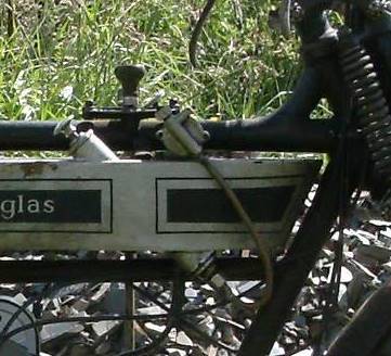

And here is a 1913 Douglas…
And here is a 1913 Douglas arrangement. The pump is spring-loaded and goes to a sight glass variable drip feed to the crankcase.

Thanks I have the pump its the innards thats the problem. I imagine a ball sits inside the spring, so as you release the plunger the oil is sucked up, the ball? seats and stops the oil returning into the tank.

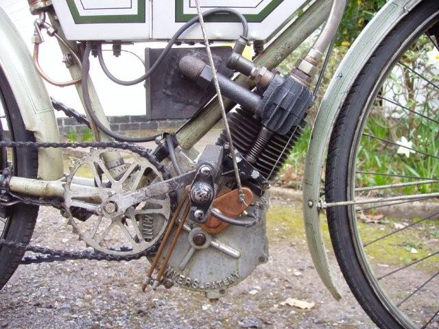

I suspect you might need a two-way tap - like the one on the attached picture (1902 Minerva-engined Quadrant). At top left the bottom of the pump is visible.
Turn the lever sideways and lift the plunger slowly. The pump fills up. Turn it down and push a slug of oil into the sump. Wait for it to emerge all over your trousers and do it again...
Nothing flashy like a non-return valve.
