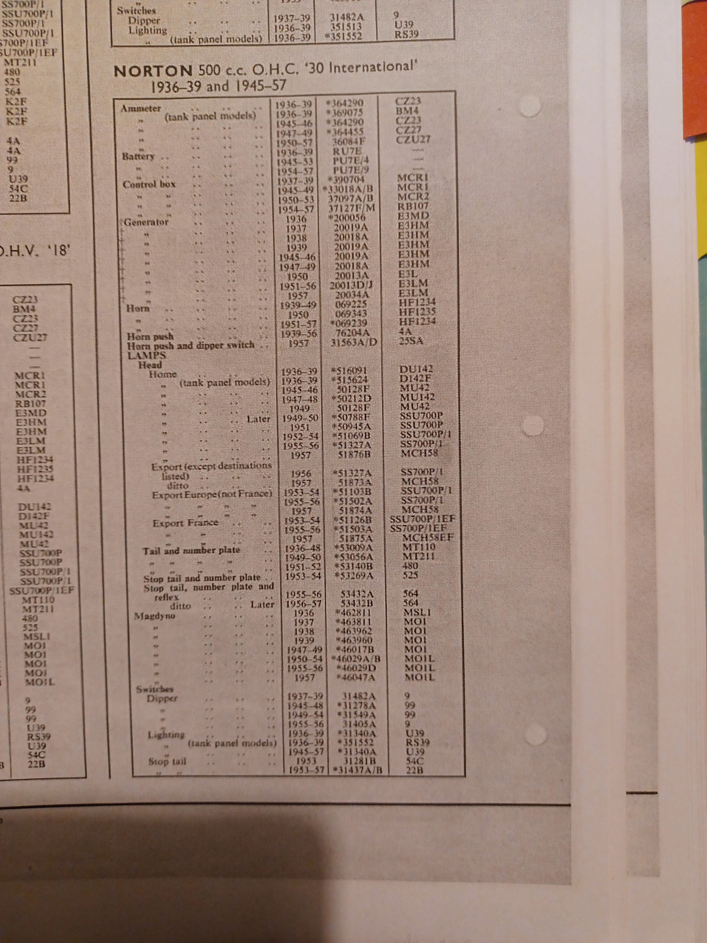

Here is a scan from the…
Here is a scan from the Lucas catalogue showing the original specification for your bike.

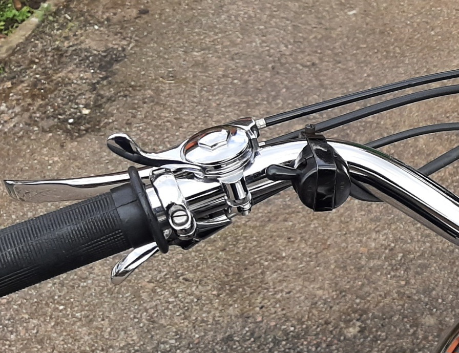

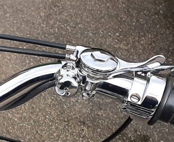

The Lucas catalogue shows…
The Lucas catalogue shows several variants of the type 9 dip switch. The wrap around band, as I have, or a half band that screws to the handlebars. Careful study also gives variants for 7/8 and 1 inch.
There is also a difference in the shape of the dip switch handle. The rounded shape for pre war and a diamond shape for post war.

According to the Lucas catalogue I think these may be the correct ones. I went through this for my 1938 ES2 a couple of years ago and found original boxed ones!
