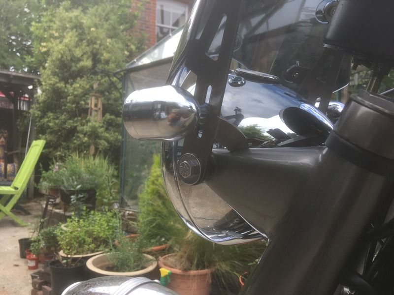

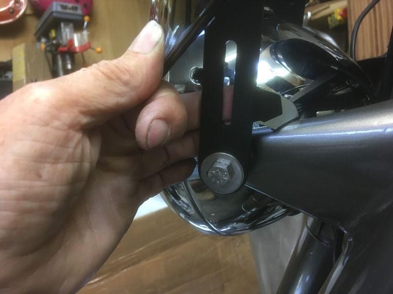

All fitted and quite easy to do. I did have to modify the brackets slightly by extending the part that 'leans' on the headlamp bracket.
I cut some aluminium extension pieces and after cleaning off the powder coat from the brackets I super glued the two together in a lap joint and then blended in the joint with car body filler. Where the brackets rest on the headlamp brackets, I added a rubber pad cut from an inner tube and also used super glue for attachment. I then sprayed the brackets to match my fork shrouds and headlamp brackets.

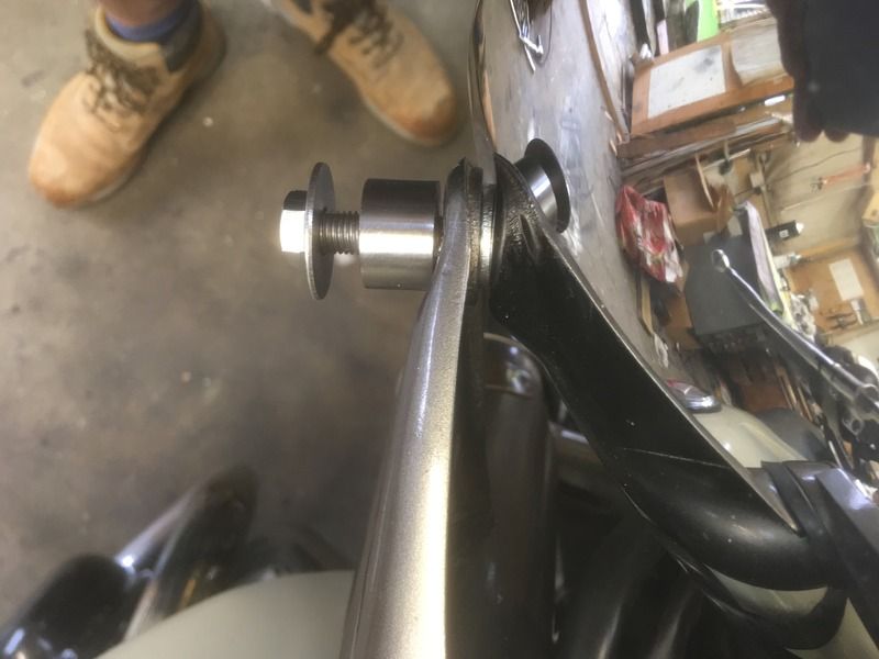

I also added some stainless steel spacers outside of the headlamp and used longer headlamp bolts.

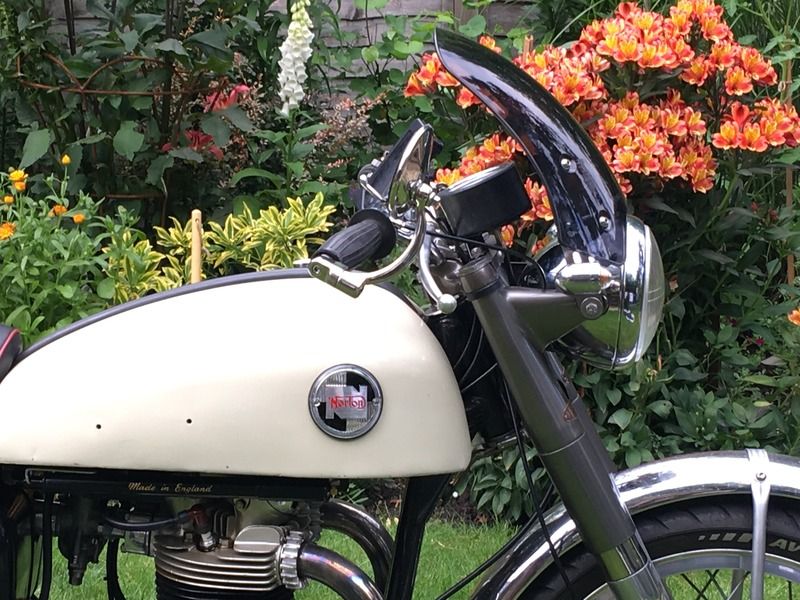

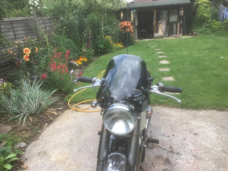

And managed to fit my indicators to the new flyscreen brackets.

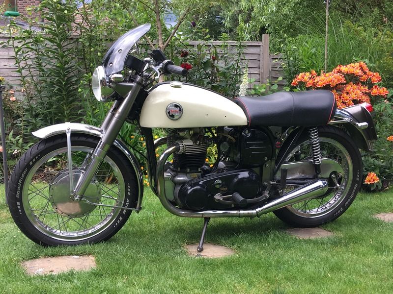

The screen I got was the 'Marlin' in dark smoke, I would have prefered the light tint but seeing as it cost me £9.99 from ebay, I'm not complaining.

Hi Bob,thanks for replying,the screen looks good on the bike,the fotos are a great help and like you say,the price is right,again,many thanks Les
