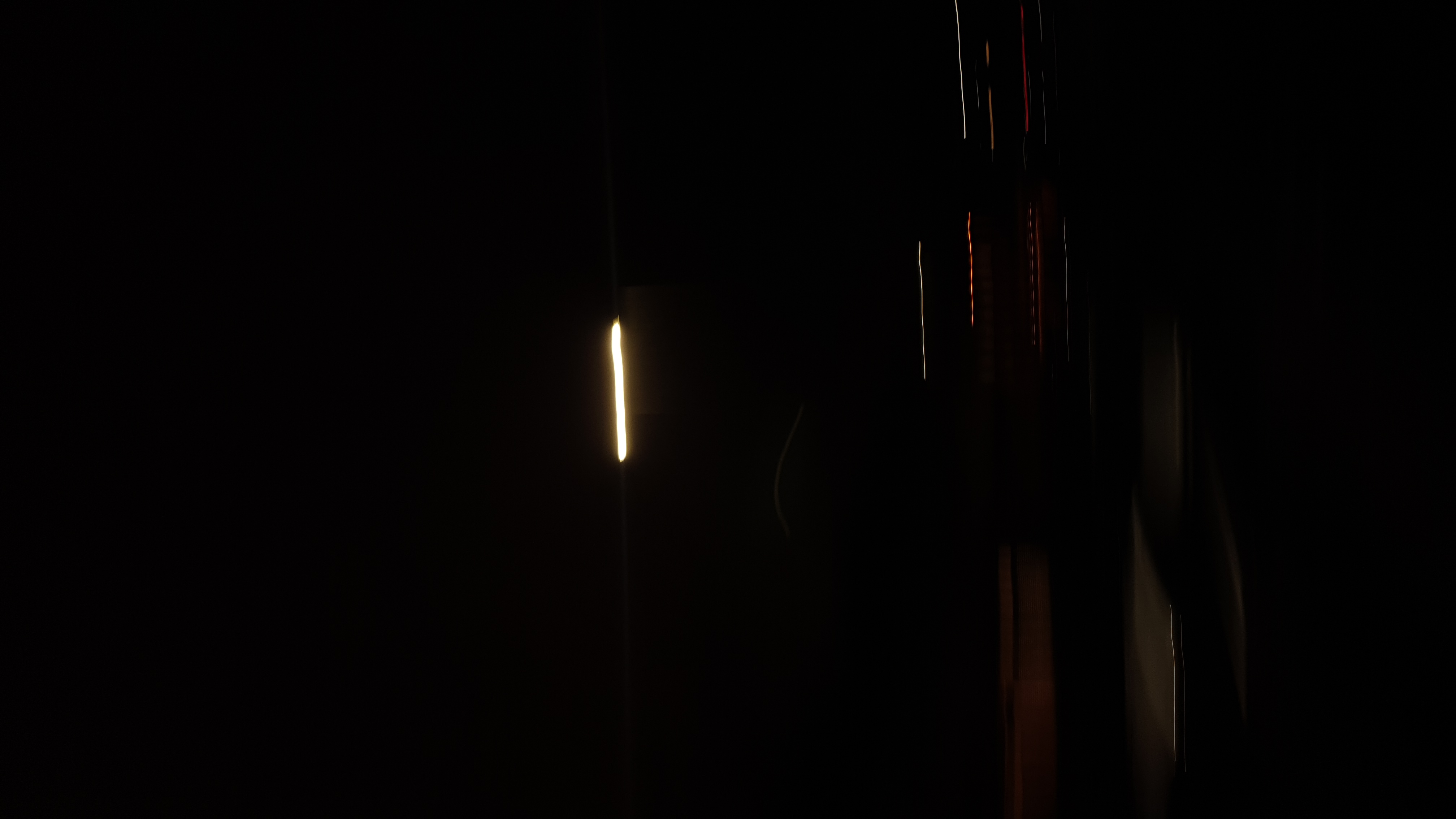

Finally on the subject of street lights. The attached picture is of a local LED street lamp at 1/10 second exposure taken when moving the camera. Since the mains frequency is 50Hz there should 5 frequency cycles visible if street lamps flicker.  That is either 5 (or 10?) pinpoints of light. Actually there is no sign of stroboscope effect, so street lights have no flicker (which is logical because it would be dangerous) and since they have a moderately smooth frequency distribution of their spectrum (like other LED) they cannot be any more harmful than other lights.

I believe that for maximum efficiency (as opposed to maximum brightness from.a given element) street light are run using DC.  As always it's not easy to separate fact from fiction!
LEDs are run with DC. SO street light power AC must be rectified to run the LED. Nothing to do with efficiency, just make it work. There is a serious efficiency improvement by the lack of heat. Ie incandescent lamps use power to get hot. Also as well as some LED being strobed to give us light, LEDs used in vehicles if/when they fail they can often flash at a low frequency making them very annoying. They are also very susceptible to the voltage supplied to them. I have in the past used cheap LED in the car called 12V but of course the Voltage in the the car is 14V. This is a 14% increase LEDs do not like this. Mostly these days decent LED for Vehicle usage will have a decent regulator built in. AND LED are polarity conscious BUT when they have a decent regulator built (for Automotive use) they can be made to be positive or negative earth. Answering Stan above, LED do have regulators to stop them being burnt out. But when they are designed they are regulated to NOT burn out, They are NOT over run. In fact they are run to give best light for an acceptable life ie NOT burning out.
