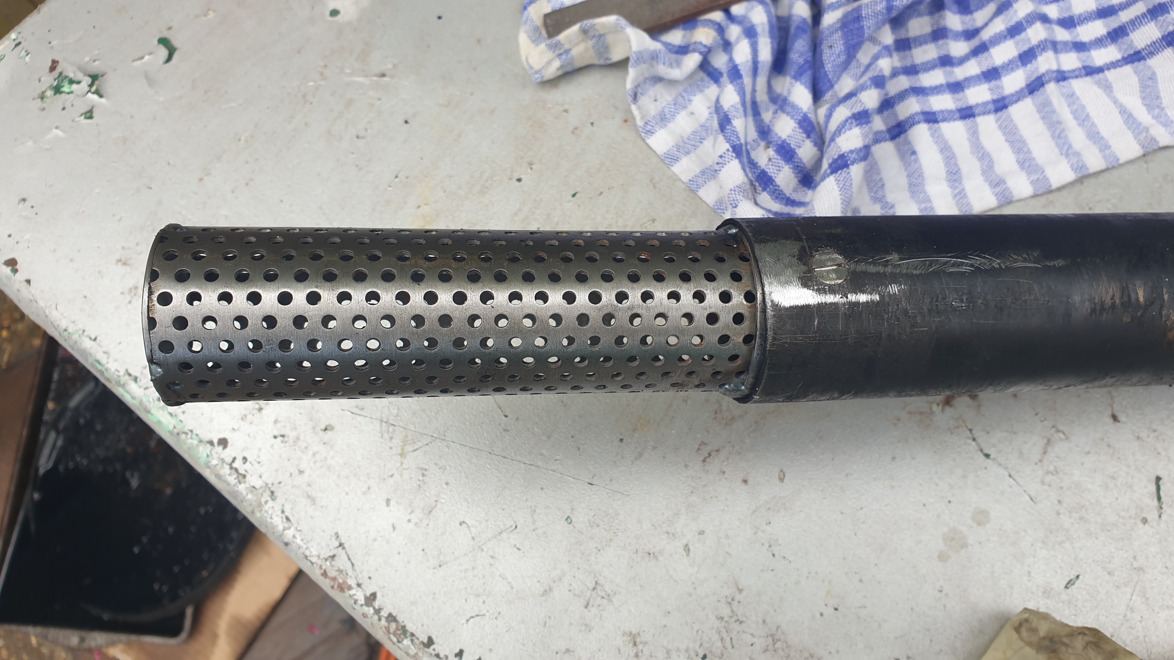

Today I added this. It takes the edge off the noise but I've yet to find out what it does to the performance. My neighbour asked why I bothered...it's not as if I get up at dawn every day...so it might come back off!
Held with 2BA stainless set screws. The 1+5/8" size is a snug fit in the 1+3/4 tail pipe. Screw threads are Araldited. I hope they don't unwind and jam the thing inside the box...

Beware the araldite, it softens to liquid with heat, but I'm not sure at what temperature.
They call these things DB Killers , I have a set for my  Firestorm  to get me thro the MOT.
I had a 1961 ES2 once, I was blown off by a Ford Cortina-I sold it back to its earlier owner. But while I was cleaning it one day I took the silencer off (Kidney shape). A 1 3/4 exhaust pipe-I though that will make a racket! Lets wake the neighbours up! started it, sounded like a pussy cat! Far more noisy with the 'silencer' on.
I got some hamster cage 1 cm galvanised square mesh, rolled it round a broom handle and shoved it up the 'silencer'. It tries to unravel, jamming itself securely in place. It's reasonably effective at taking the edge off a noisy exhaust. Now has anyone seen a hamster anywhere?
