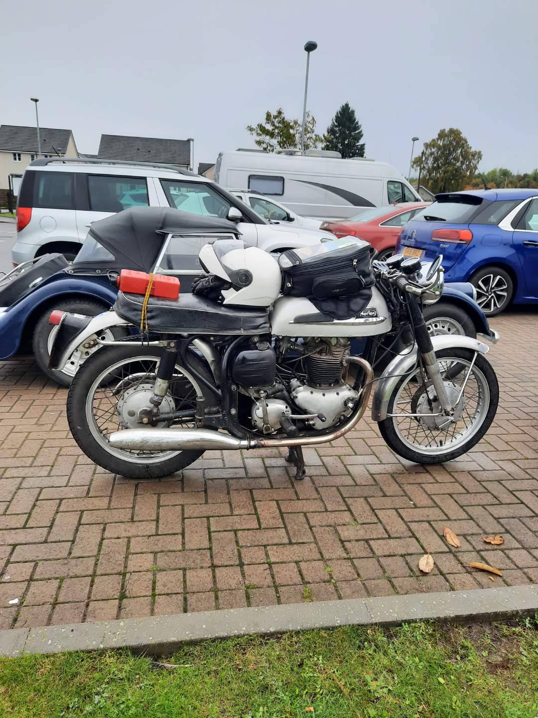

These days I don't go any distance without two things. A tank bag with all the things you hope never to need plus a red 2.5 litre fuel container strapped on the back.
Pictured in a restaurant car park on a rainy day in Stirling.
