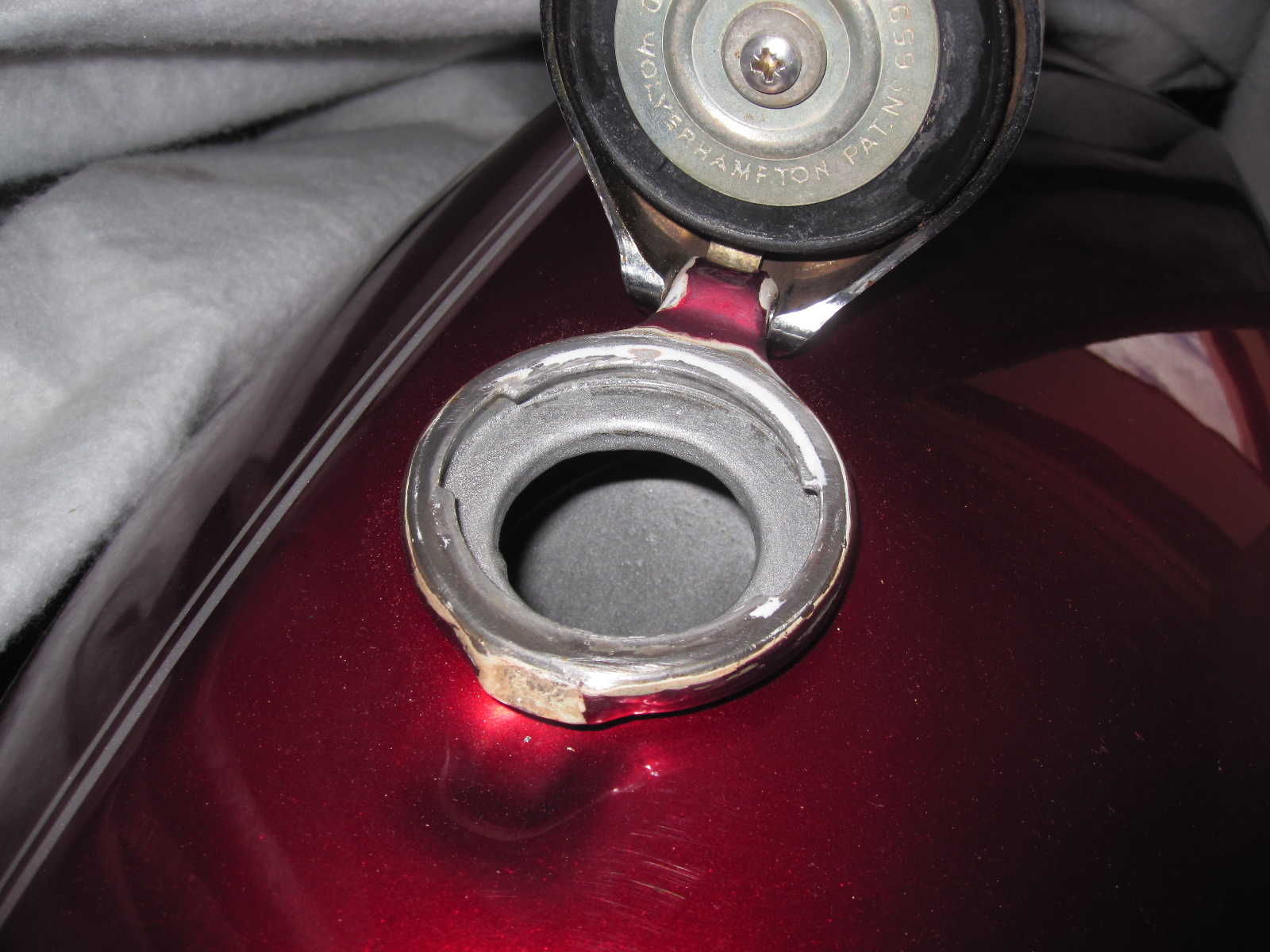

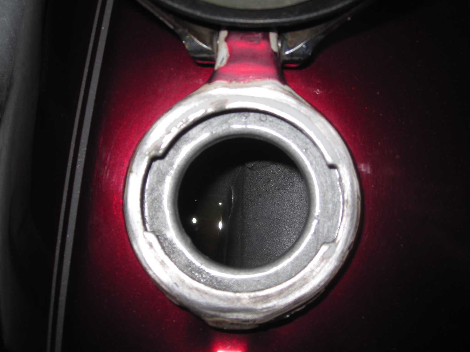

Greetings Norton Owners,
Well I have also had some interesting experiences with Ethanol here in Australia. While I always try to use BP Ultimate (98 octane) in all my historic bikes, there have been interesting recent developments regarding elastomer compatibility and the dreaded âgreenâ fuel. One experience will (hopefully) be dealt with an article submitted for the August RoadHolder but this particular incident was not all Ethanol related, as I believe this particular fault was accelerated by vibration. Unfortunately, without the backing of a research house and robust FMEA protocols, I can only consider the damage caused as âconjecture.â
After searching high and low, the only fuel hose I could get a WRITTEN specification regarding Ethanol âComplianceâ was marine grade, its grey and expensive, but has a warranty. I also fitted two âStay-Upâ Amal float kits.
Sorry to drift off topic, but I have also recently repaired my original 1974 Interstate MkIIA fuel tank with a magnificent POR product. You will have to contact the manufacturer regarding Glass-fiber repair capability, but believe the Caswell product is OK with glass.
http://www.por15.com/HEAVY-DUTY-CYCLE-TANK-REPAIR-KIT_p_60.html
This particular kit also includes the correct chemicals for removing a failed liner!
Fortunately I did not need this additional chemical, as my tank was unlined. So purchased a standard kit off the shelf in Adelaide ($55.00). I am sure the Caswell product is also OK and as I understand it, recommended by a tractor manufacturer based in Milwaukee
However I was shocked and horrified at all the Krud that emanated from the tank post cleaning process! It looked clean to meâ?
Note: Very important to DRY the tank out completely prior to liner / coating application. I choose a nice day, 30Ë C + and carefully used a hot air gun. This tank had previously restored and has very nice paint. Consequently did not want any damage. Exceptional care was used to wrap all paintwork & mask with plastic. Purchased a couple of ? â BSP SS plugs from the usual hydraulic supplier to keep threads clear & blank off the fuel tap holes.
Then just followed the instructions and hand painted the fuel cap area once the stuff started to cure. That was over 18 months ago and no problems since. This material sets like Flint and I ran a tap through the fuel tap threads once 100% cured, material cut like Devcon Titanium putty!
Good luck and herewith photos.
Stay Upright!
Rgds Steve
