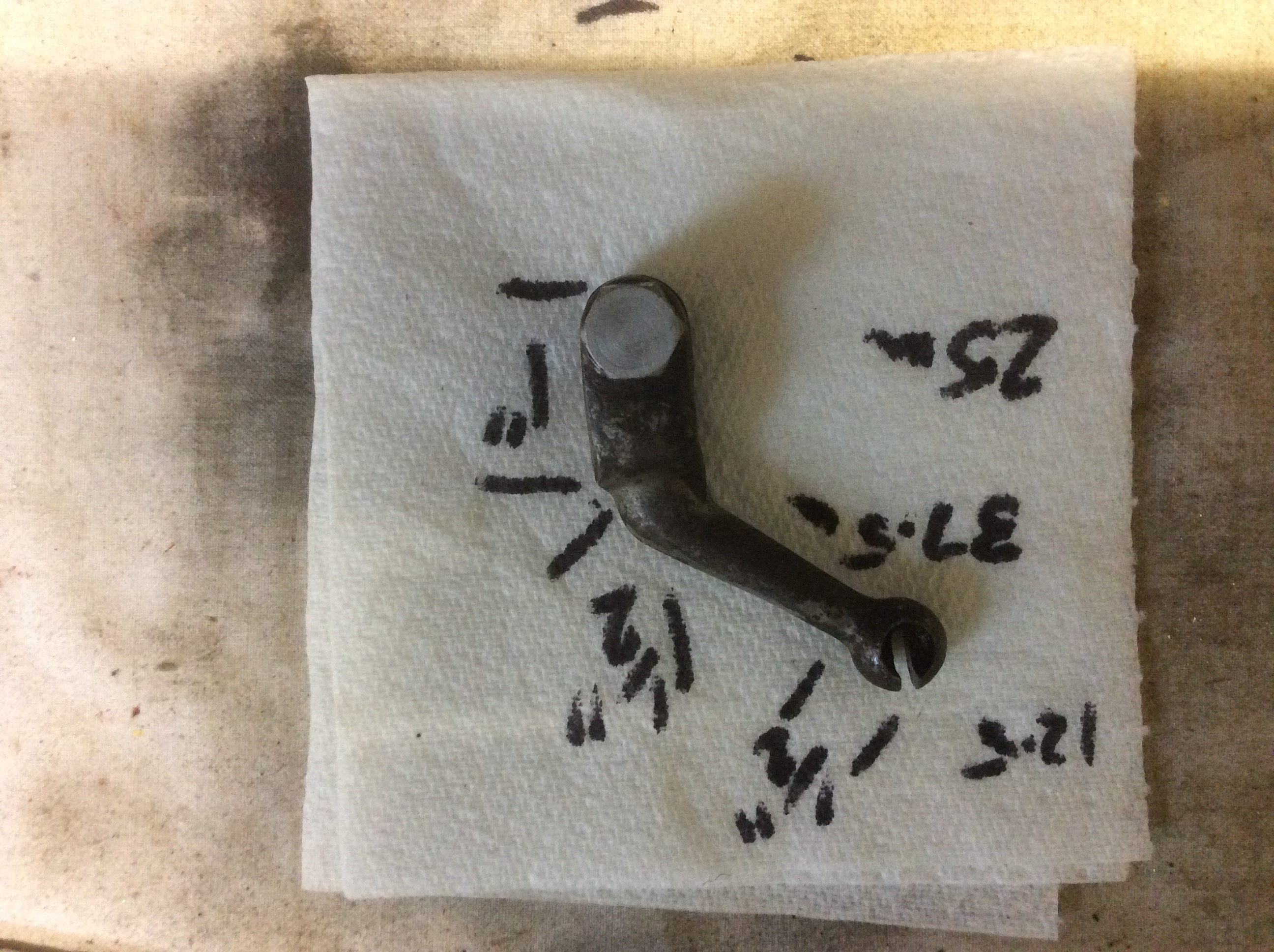

Lifter arm
Michael...is this the correct arm in attached photo. Unlike your cable fitting when mine is connected that way the cable is in line with the frame....and is forced either above or .below making it a tight fit...
I'm afraid....
...that I passed my ES2 on to a friend and the photo I posted was poached off the web. I found an old photo where I can see that I have the cable routed in a way that has it coming in over the cross tube a bit higher. Try clamping the arm on the spindle more counter-clockwise and re-routing the cable.
