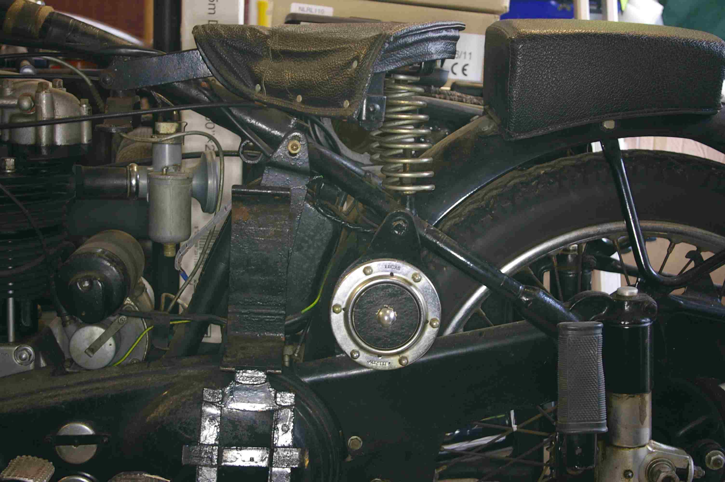

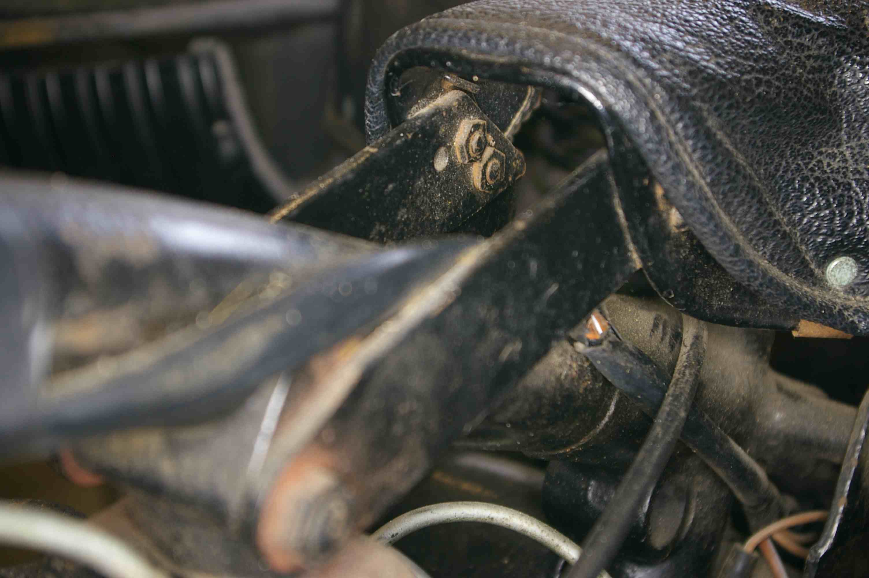

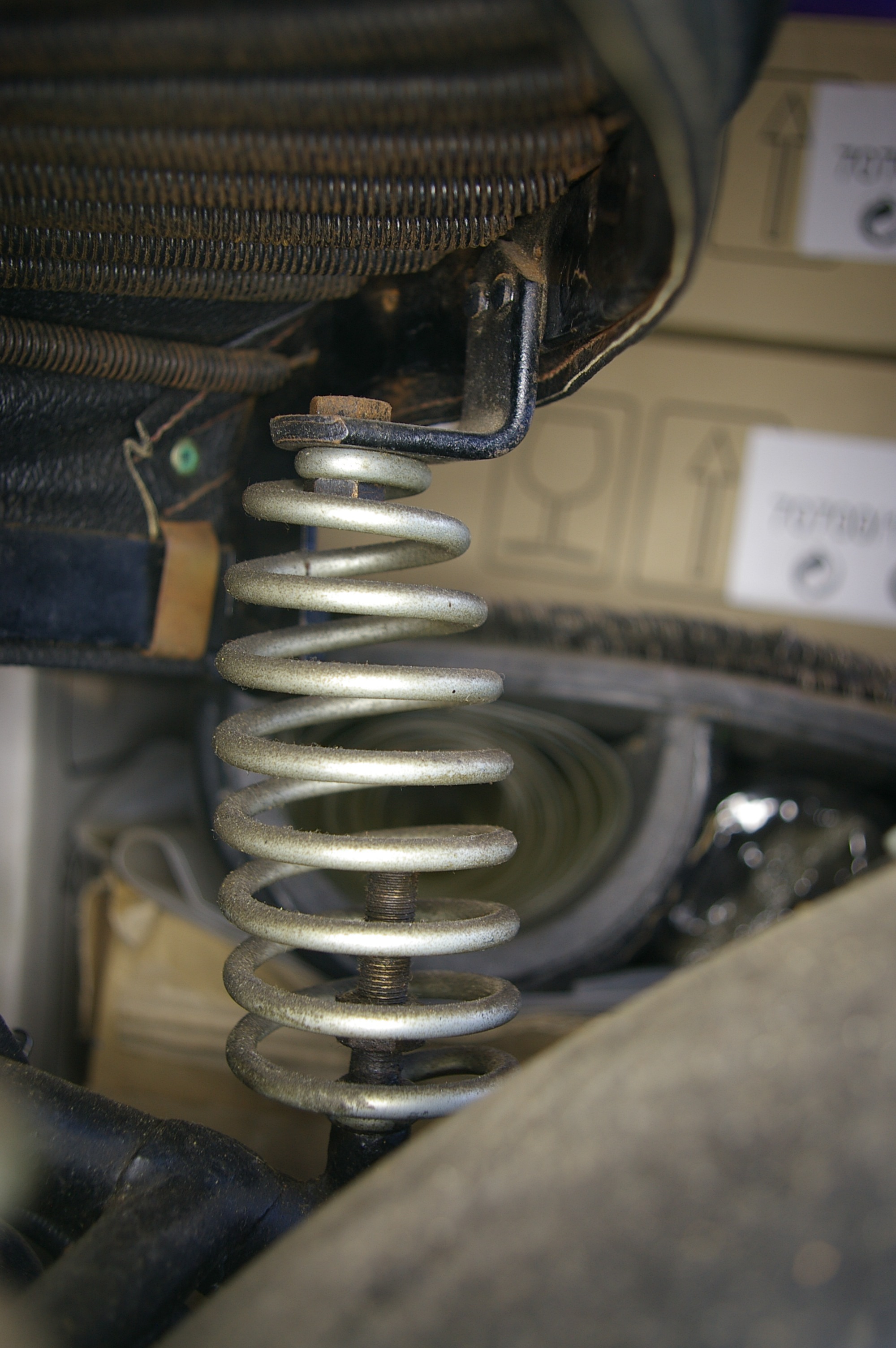

ES2 Seat Pics
These are pictures of my 1950 ES2 seat. My guess is that you will have to make your own struts for the nose. If you go that way and need dimensions then please get in touch.
Ian McD

Please excuse the delay in replying. Your pictures have been most useful bearing in mind that I have nothing to go by. What would help is if you could let me know how long the springs should be?

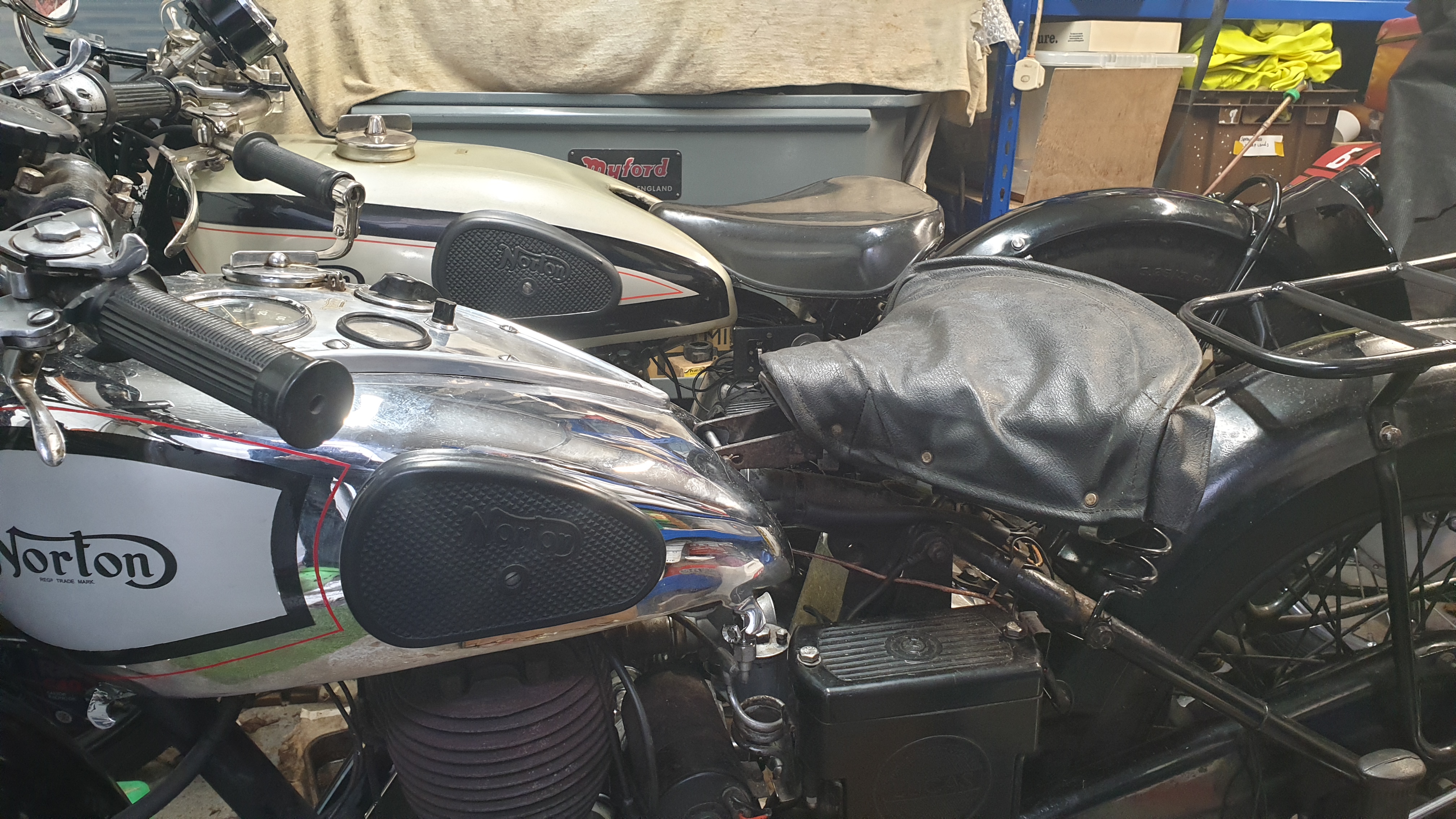

That is true....
... but a dual seat on a plunger sprung bike would be quite uncomfortable. By adjusting the length of the links shown in Ian's pictures you can usually get the saddle in a comfortable position. I don't have a pillion on my ES2 so am able to slide back a bit when I need to.
I raised the cross pin that…
I raised the cross pin that supports the nose of the saddle of my rigid 16H. Also moved it backwards and reluctantly replaced the saddle springs. It's made it more comfortable. But actually buying new (kevlar lined) jeans the next size up seems to have got rid of the cramp that used to be the problem.
That carrier...
.. would put a dent in your coccyx if you slid back much! Hence why I have neither carrier nor pillion on mine.
Spring Dimensions
Hi Mark
Length 125mm, Wire Diameter 5.6mm, 8 turns
Bottom coil OD 56mm, Top coil OD 42mm
Cheers, Ian

Thanks Ian, again your pics as to how the springs fit has been most useful, best regards, Mark.
